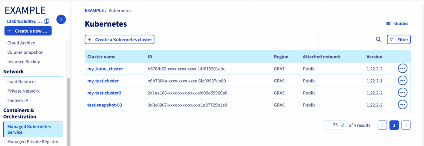

Access the administration UI for your OVHcloud Managed Kubernetes clusters by clicking on Managed Kubernetes Service in the left-hand menu.
Then, click on one of your Kubernetes cluster in the tab.

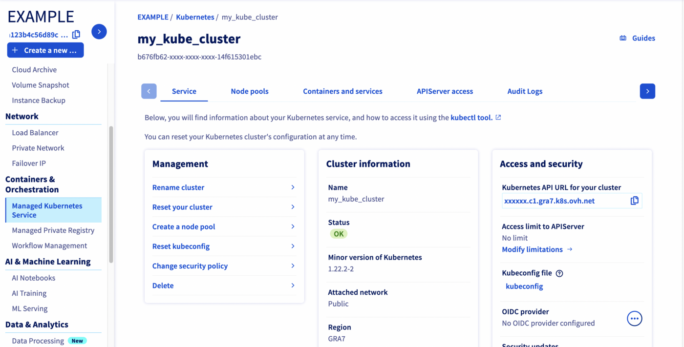

Then, click on kubeconfig to download the kubectl configuration file:
Configuring default settings for kubectl

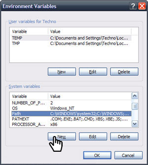

  1. From the Windows menu or Cortana search bar, search for "Modify system environment variables".
  2. In the System Properties window, click on the Advanced tab, then click the Environment Variables button near the bottom.
  3. In the window that opens (pictured below), add a new variable, KUBECONFIG, with the path to the kube-config file as its value.
Add environment variables
