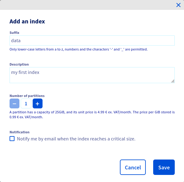

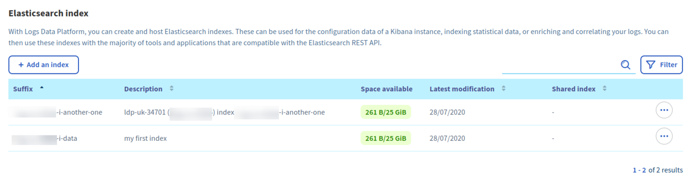

There are two ways to create an OpenSearch Index:
  • Use the Logs Data Platform manager.
  • Use the OpenSearch API.
To create an OpenSearch index with the Logs Data Platform manager, you need to go to the index page and click on the Add a new index on the OpenSearch index section
add index option
Simply choose a suffix for your index. The final name will follow this convention:
<service_name>-i-<suffix>.
The service name is the identifier of your Logs Data Platform service. It is different from the username used by non IAM users. The service name starts with ldp (e.g. ldp-ab-12345). On the other hand, the username starts with logs (e.g. logs-ab-12345). In this guide we will use <service_name> or <username> as tags to let you differentiate both usages. You can find both pieces of information in the Logs Data Platform control panel.
Prior to IAM migration the prefix was <username>. It has now been changed to <service_name> for all indices created after 17 September 2025.
For each index, you can specify the number of shards. A shard is the main component of an index. Its maximum storage capacity is set to 25 GiB (per shard). Multiple shards mean more volume, more parallelism in your requests and thus more performance. Optionally, you can also be notified when your index is close to its critical size. Once your index is created, you can use it right away.
When you create an index through the OpenSearch API, you can also specify the number of shards. Note that the maximum number of shards per index is limited to 16. OpenSearch compatible tools can now create indices on the cluster as long as they follow the naming conventions.

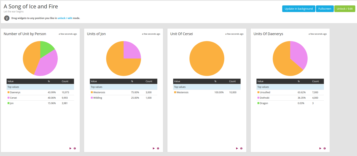

Use case: Enrich Logs Data on the fly
The following shows how your e-commerce application logs can be sent to the Logs Data Platform whenever a product is ordered. It logs the customer order by using ID for the customer's name. For performance reasons or maybe by design, the application doesn't fetch the full name of the client or other information from the customer database just to produce a log. You can add this information on the fly by using an OpenSearch Index and a Logstash collector on the Logs Data Platform.

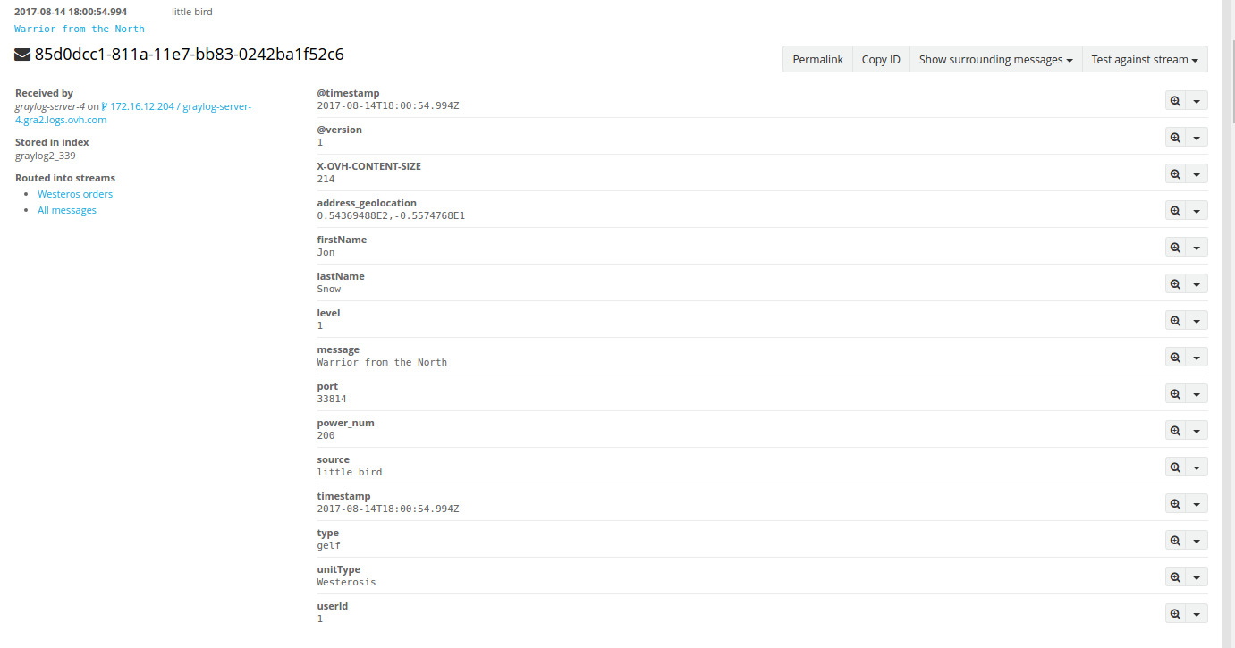

Now that you have some data, you can enrich your logs with it. For this we will use a Logstash collector and an elasticsearch plugin (some elasticsearch tools are compatible with OpenSearch).
Configure a Logstash collector
If you don't know how to create a Logstash collector, please refer to the Logstash guide. Edit the configuration of Logstash. For this example we will use a SSL TCP input with the GELF codec. Here is the input configuration.
tcp {
    port => 12202
    type => gelf
    ssl_enable => true
    ssl_verify => false
    ssl_cert => "/etc/ssl/private/server.crt"
    ssl_key => "/etc/ssl/private/server.key"
    ssl_extra_chain_certs => ["/etc/ssl/private/ca.crt"]
    codec => gelf { delimiter => "\x00" }
The most important part in this configuration is the filter part:
opensearch {
    hosts => ["https://gra2.logs.ovh.com:9200"]
    index => "<service_name>-i-<suffix>"
    user => "pat_jwt_logstash"
    password => "<iam-token-value>"
    enable_sort => false
    query => "userId:%{[userId]}"
    fields  => {
       "firstName" => "firstName"
       "lastName" => "lastName"
       "address" => "address"
if "_elasticsearch_lookup_failure" not in [tags] {
     mutate {
        add_field => {
            "address_geolocation" => "%{[address][geolocation][lat]},%{[address][geolocation][long]}"
        remove_field => [ "address" ]
The filter part is composed by two plugins, the elasticsearch plugin and the mutate plugin. The elasticsearch plugin has the following configuration:
  • hosts: This is the address of the OpenSearch API of your LDP cluster. Note that we use https here.
  • index: This is the name of the index containing your static data.
  • username: This is the username to authenticate yourself against the API. Again, we recommend that you use tokens for that.

As you can see we just specify the userId this order belong to. Sending this log to your Logstash input will give you the following final log:
Log in the stream
The log has been enriched with the fields we declared in our filter automatically. Linking information from an index and the logs allow you to create more meaningful Dashboards based on these information:
A song of Ice And Fire
In this Dashboard, you can see that the first widget is a "quick values" widget based on the firstName fields of the logs we retrieved.

Manager
All the items you create through OpenSearch API will be displayed in your manager and can be deleted or monitored through it.
manager
Here the first index was create through API, its description was filled automatically.
