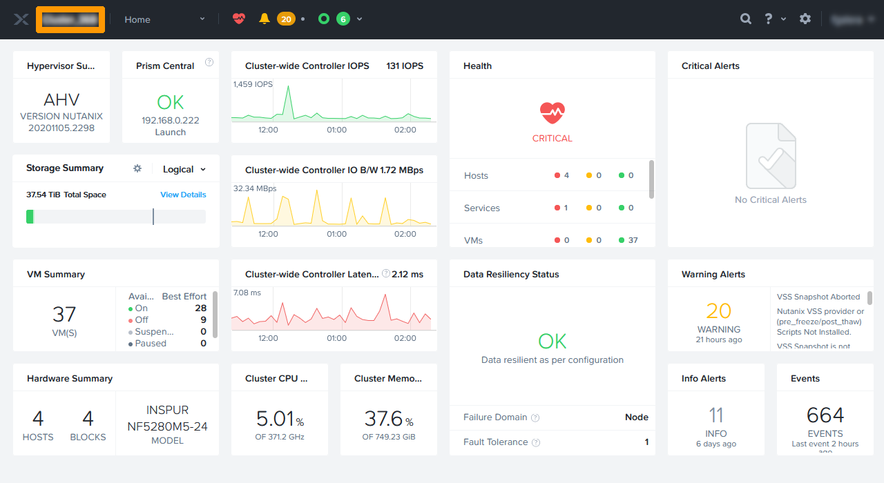

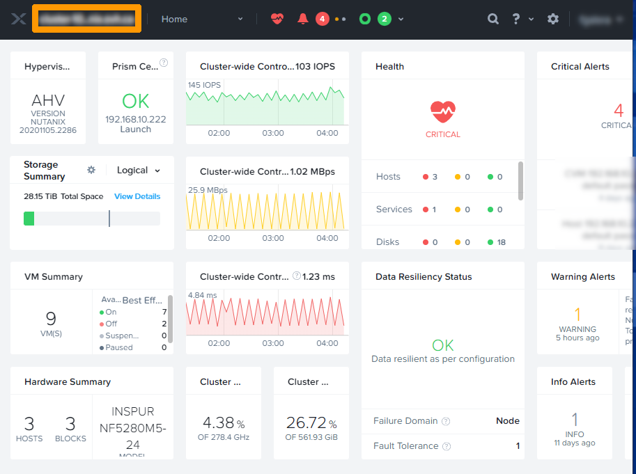

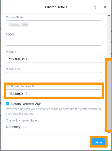

Using Prism Central, connect to Prism Element on the cluster in France. You can use the Nutanix Hyperconvergence guide for more information.
In the top left-hand corner of the Prism Element dashboard, click the cluster name.
00 Add iSCSI address in FRANCE01
Check the IP address in the iSCSI Data Service IP field.

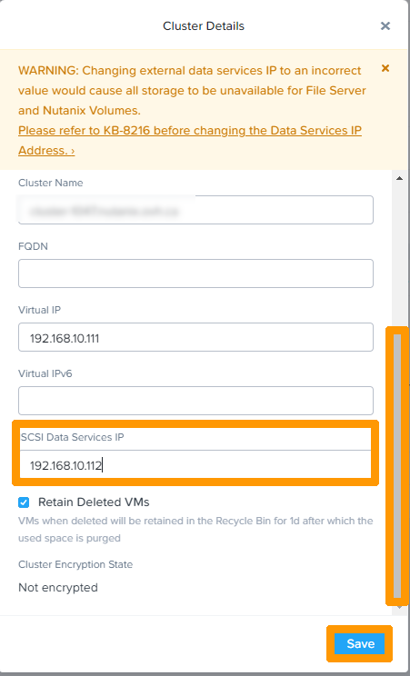

Also via Prism Central, now perform the same operation on the cluster in Canada.
In the top left-hand corner of the Prism Element dashboard, click The cluster name.
01 Add iSCSI address in Canada01
01 Add iSCSI address in Canada02

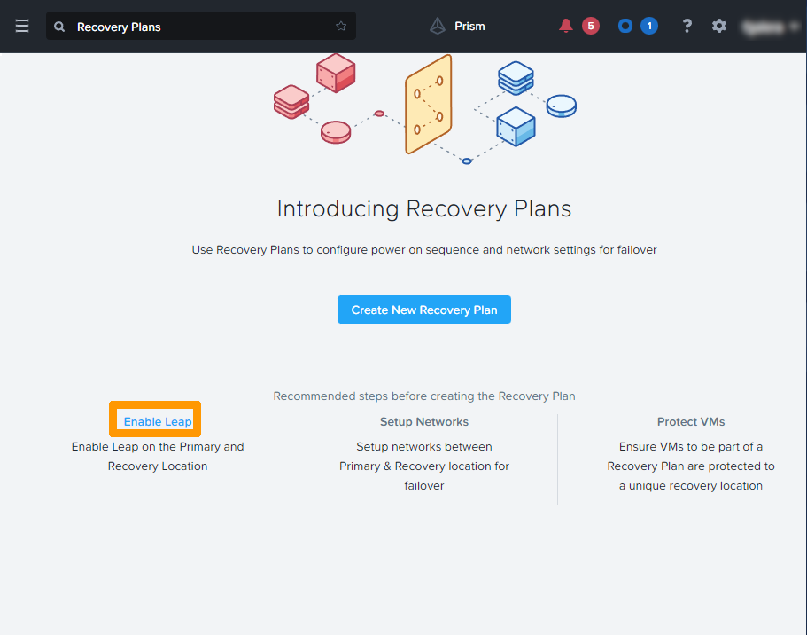

Enabling Leap

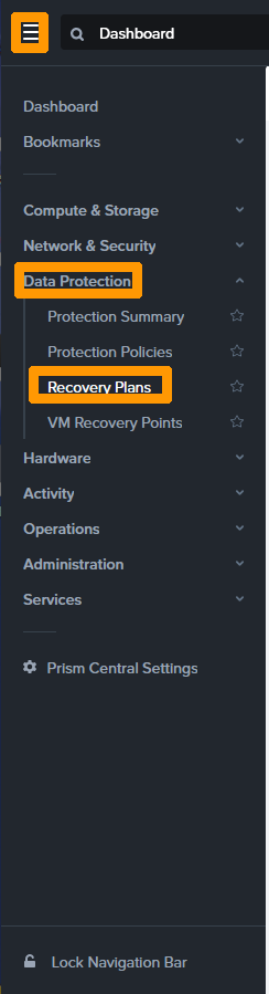

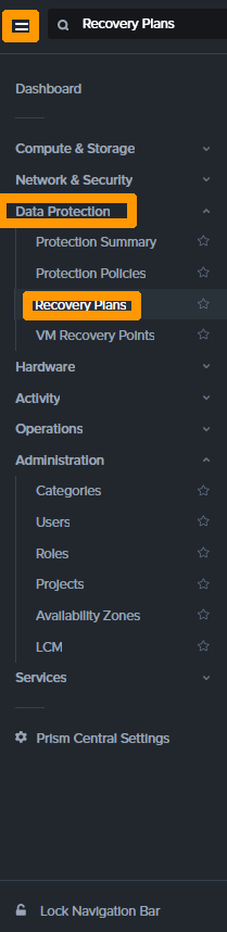

Go back to the Prism Central interface for the cluster in France.

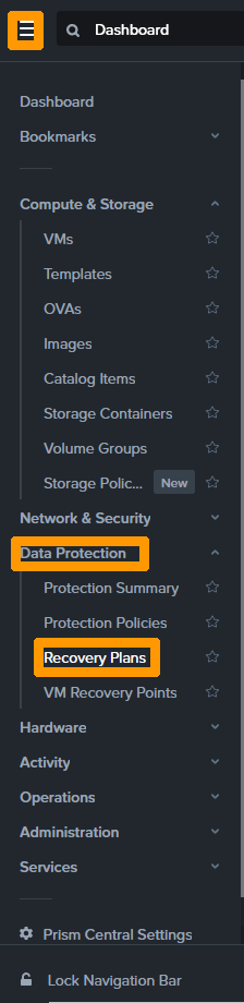

From the main menu, click Recovery Plans in the Data Protection submenu.
Activate Recovery 01

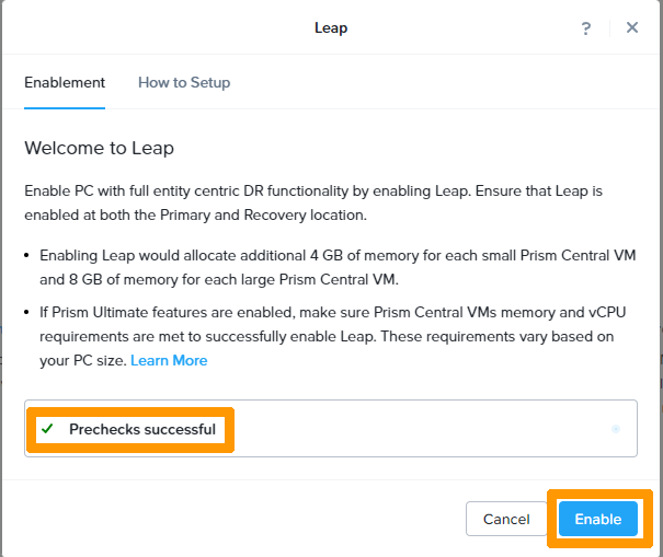

Click Enable Leap.
Activate Recovery 02
When you see Prechecks successful, click Enable.
Activate Recovery 03

Click Enable Leap.
Again, when Prechecks successful appears on the screen, click Enable.

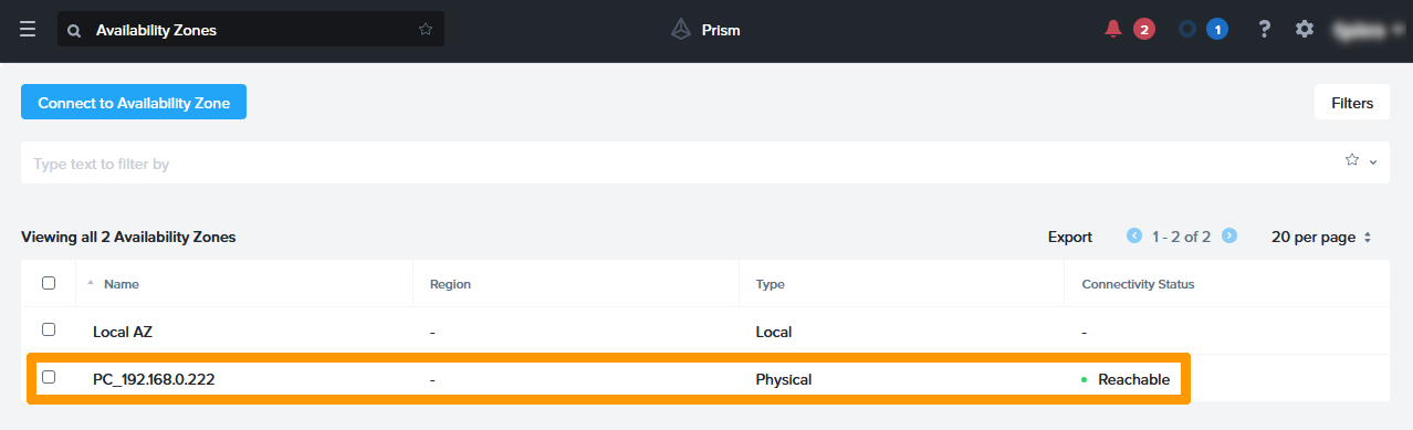

Each cluster now has an Availability zone, which allows them to be interconnected.
Connecting both clusters.

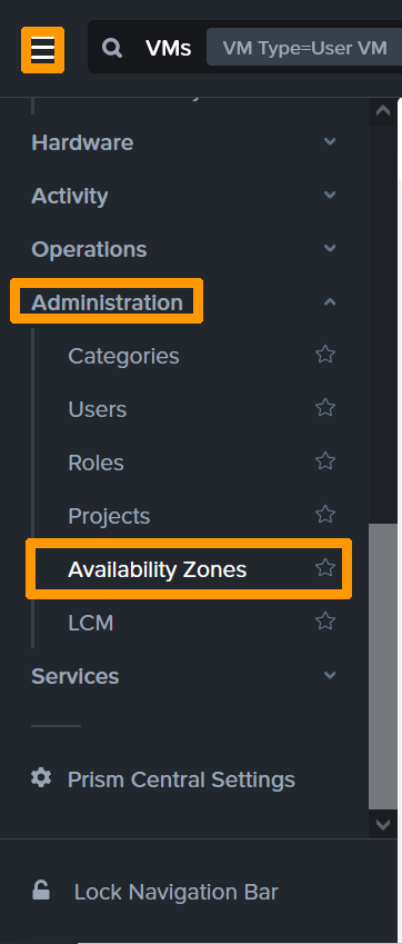

Stay on Prism Central in the cluster in Canada.

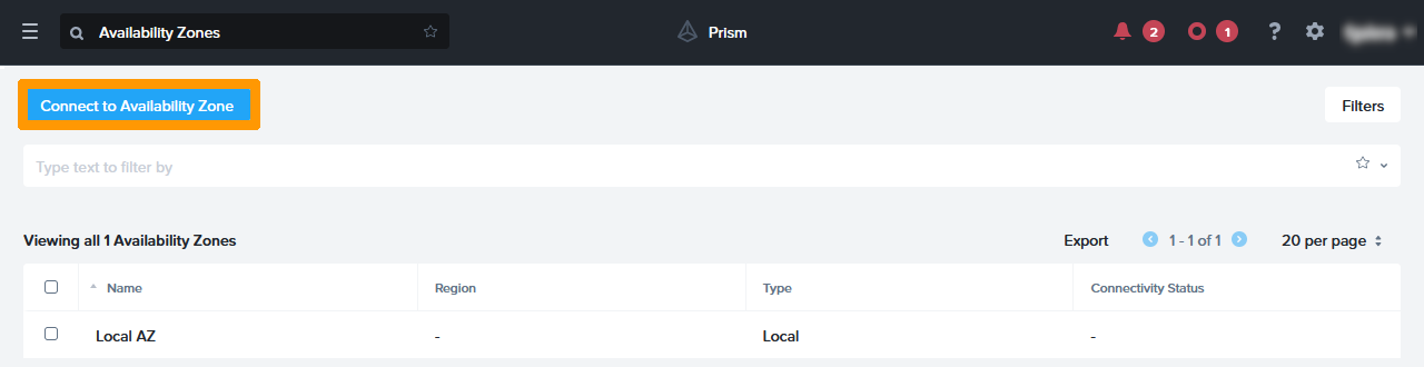

From the main menu, click Availability Zones under Administration.
Connect clusters 01

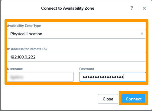

Then click Connect to Availability Zone.
Connect clusters 01
Enter this information:
  • Availability Zone Type: Physical Location.
  • IP Address for Remote PC: IP address of the remote Prism Central.
  • Username: Remote Central Prism administrator account.
  • Password Remote Central Prism account password.
Then click Connect.
Connect clusters 01

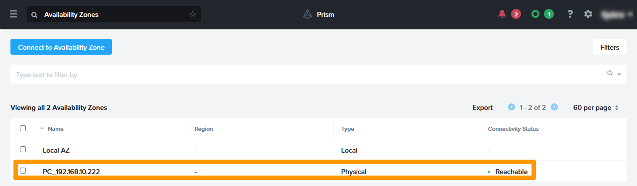

The remote cluster is named after the private IP address of the Prism Central in France, preceded by PC_.
Connect clusters 02
Connect to the cluster in France with Prism Central.
From the main menu, click Availability Zones on the Administration submenu. You will see that the remote site in Canada appears with the private IP address of the Prism Central in Canada preceded by PC_.
Connect clusters 03

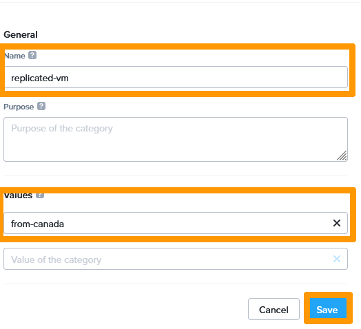

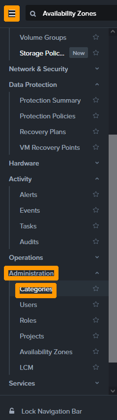

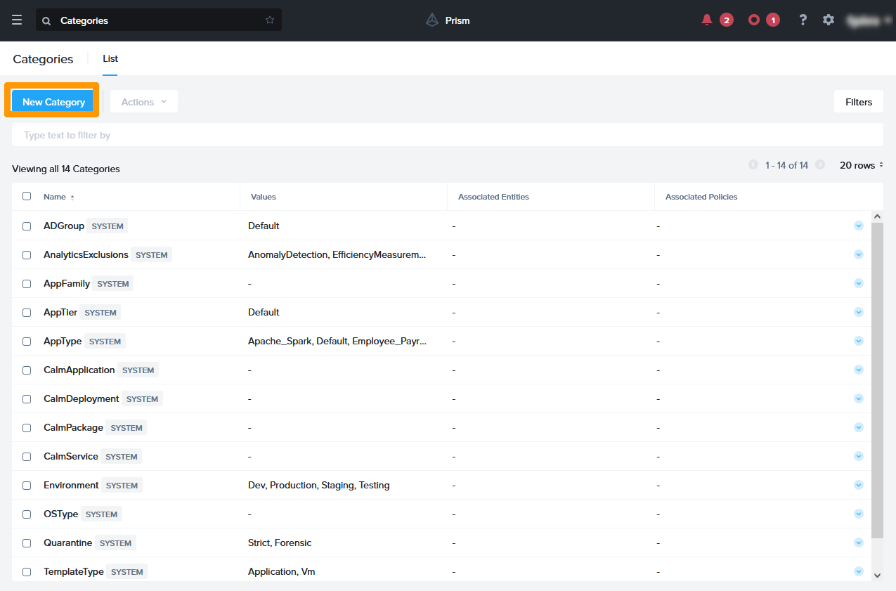

From the main menu, click Categories on the Administration submenu.
Create CATEGORIE 01
Click New Category.
Create CATEGORIE 02
  • Name: replicated-vm
  • values: from-canada
Then click Save.
Create CATEGORIE 03

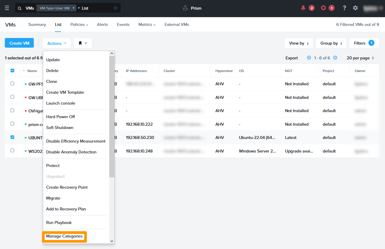

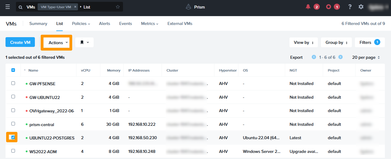

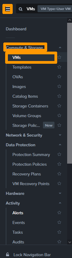

Go back to the main menu and select VMs under Compute and Storage.
Create CATEGORIE 04

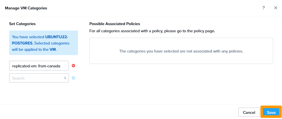

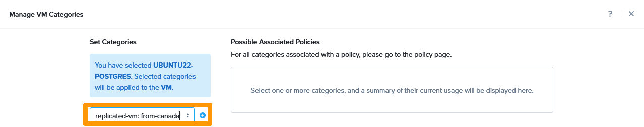

Select the virtual machine by using the check box to its left, then click the Actions button.
Create CATEGORIE 05
In this menu, click Manage Categories.
Create CATEGORIE 06
Select the category you created and click the blue + button.
Create CATEGORY 07
Click Save.

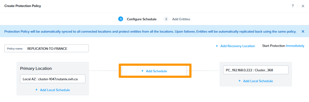

Creating the protection policy
A protection policy creates a scheduled replication between two Availability zones. You can choose this type of schedule depending on your licence:
  • asynchronous every hour
  • nearsync between 1 and 15 minutes
  • synchronous with a delay of 0 seconds (this mode requires a network latency of less than 5ms between the two clusters)

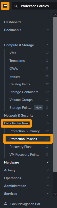

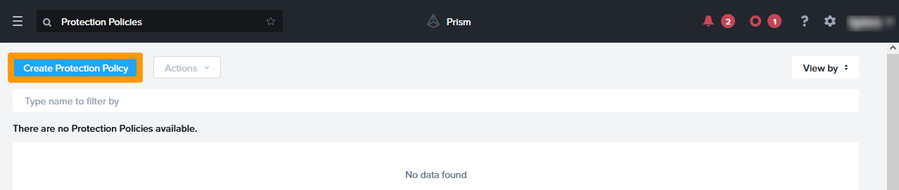

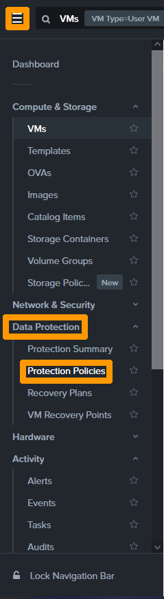

From the main menu, click Protection Policies under Data Protection.
Create Protection policy 01
Click Create Protection Policy.
Create Protection policy 02

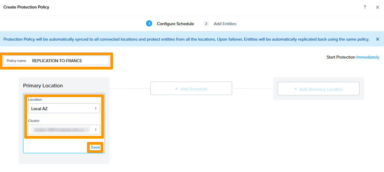

Enter a name in the Policy name field.
In the Primary location box, choose these options:
  • Location: Local AZ to choose the zone containing the local cluster.
  • Cluster: Cluster containing the virtual machines to be replicated.
Click Save.
Create Protection policy 03

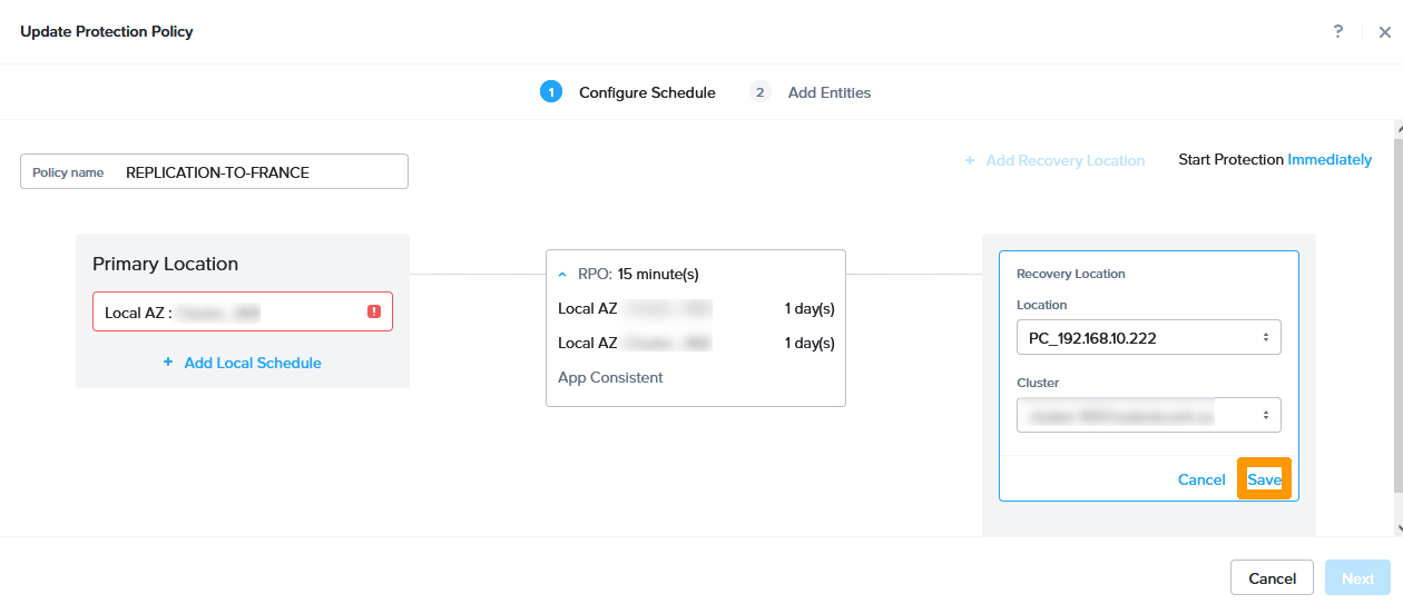

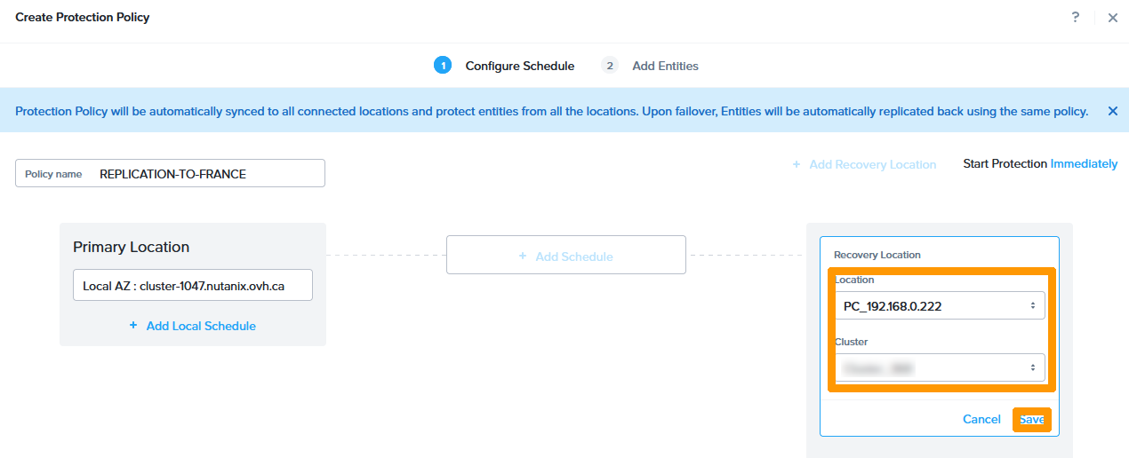

In the Recovery location frame, choose these options:
  • Location: Remote cluster zone.
  • Cluster: Destination cluster.
Click Save.
Create Protection policy 04
Then click + Add schedule.
Create Protection policy 05

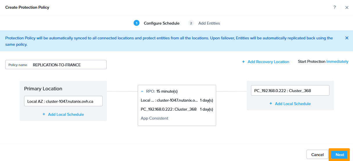

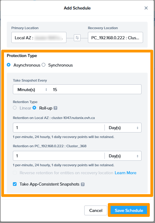

Choose Asynchronous as Protection Type.
Change the Take Snapshot Every option to Minutes: 15 to do nearsync replication.
Select the Take App-Consistent Snapshots checkbox and click Save Schedule.
Create Protection policy 06
Click Next.

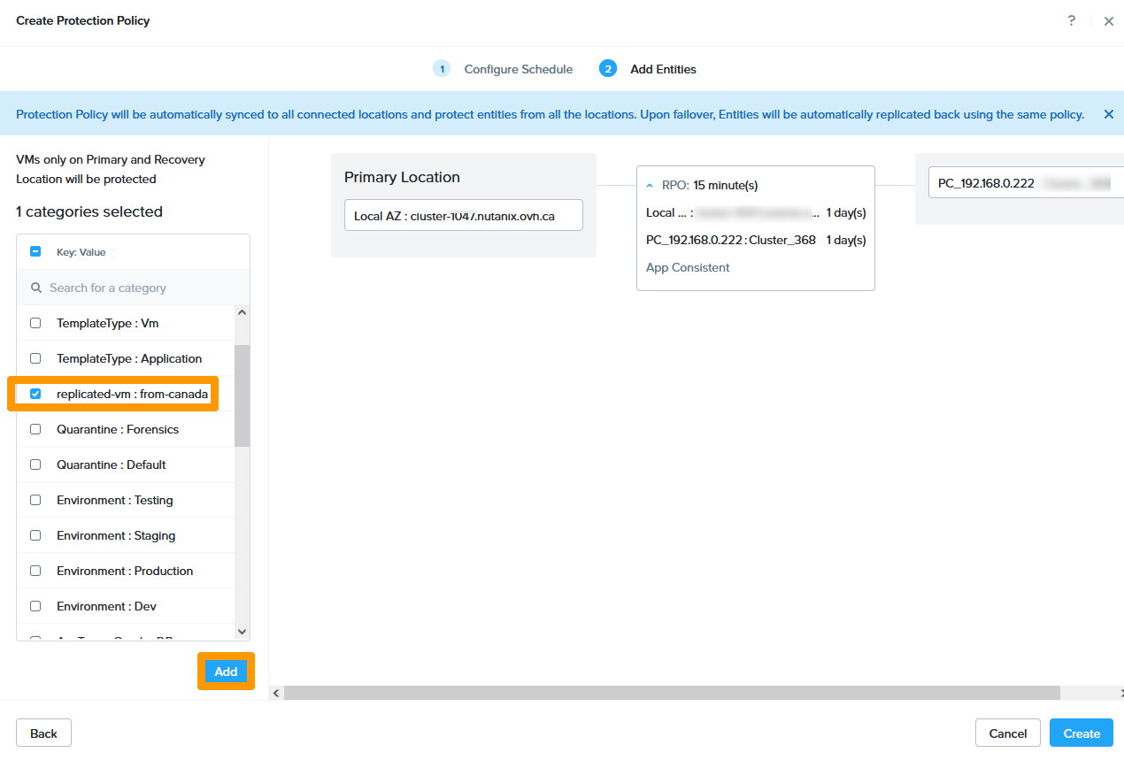

Create Protection policy 07

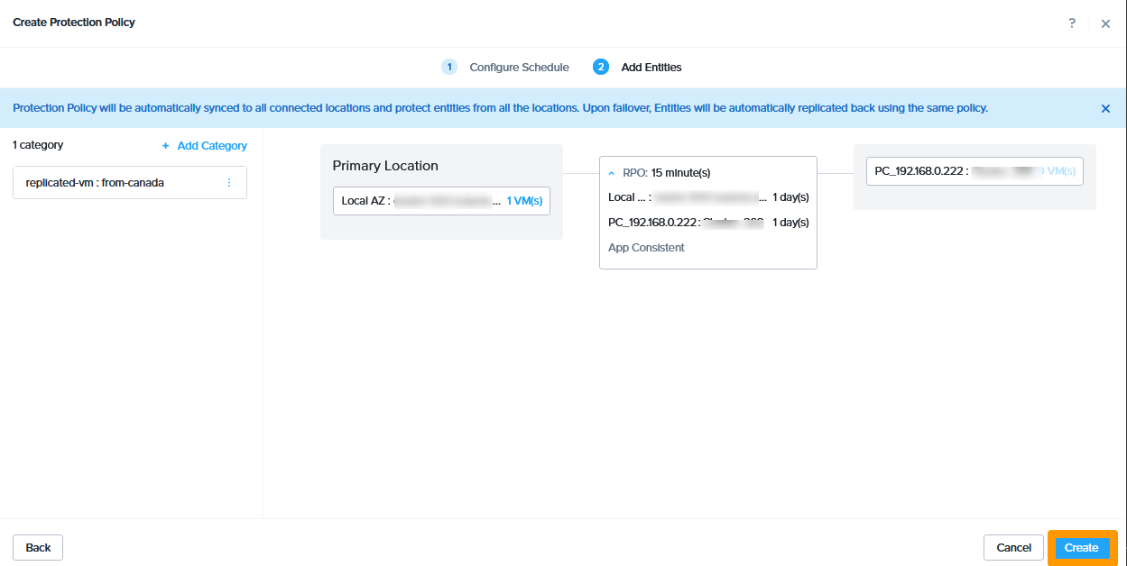

Select the category where the virtual machine was added and click Add.
Create Protection policy 08

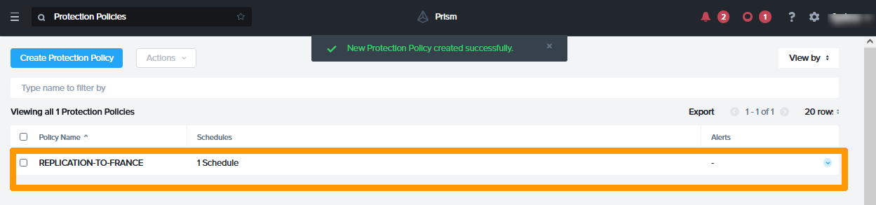

Click Create.
Create Protection policy 09
The protection policy is enabled and appears in the Protection Policies dashboard.

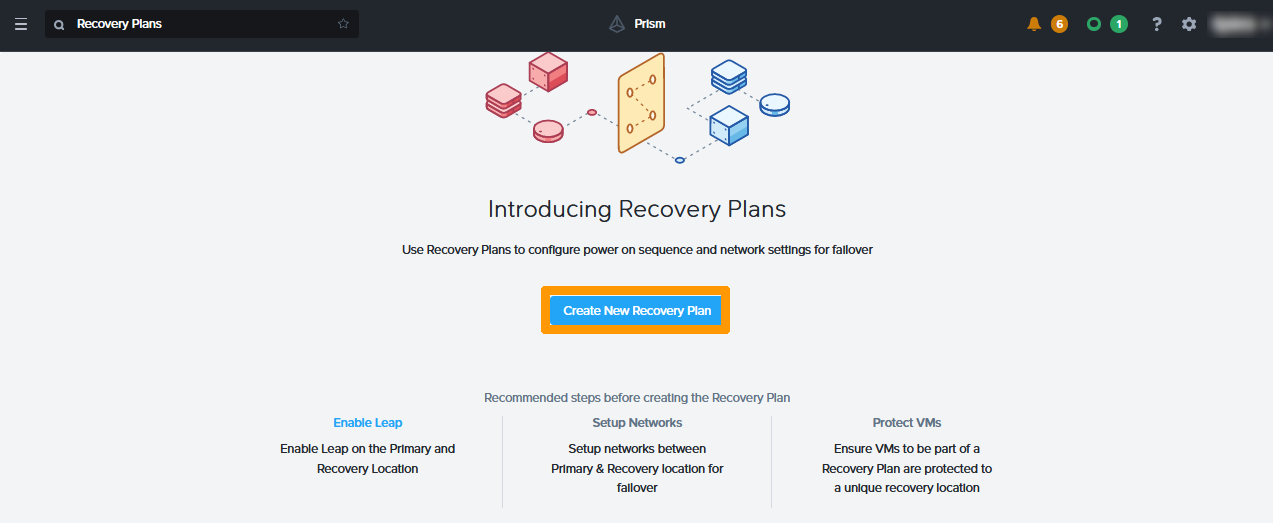

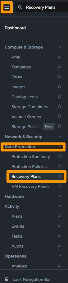

From the main menu, choose Recovery Plans under Data Protection.
Create Recovery Plan 01
Click Create New Recovery Plan.

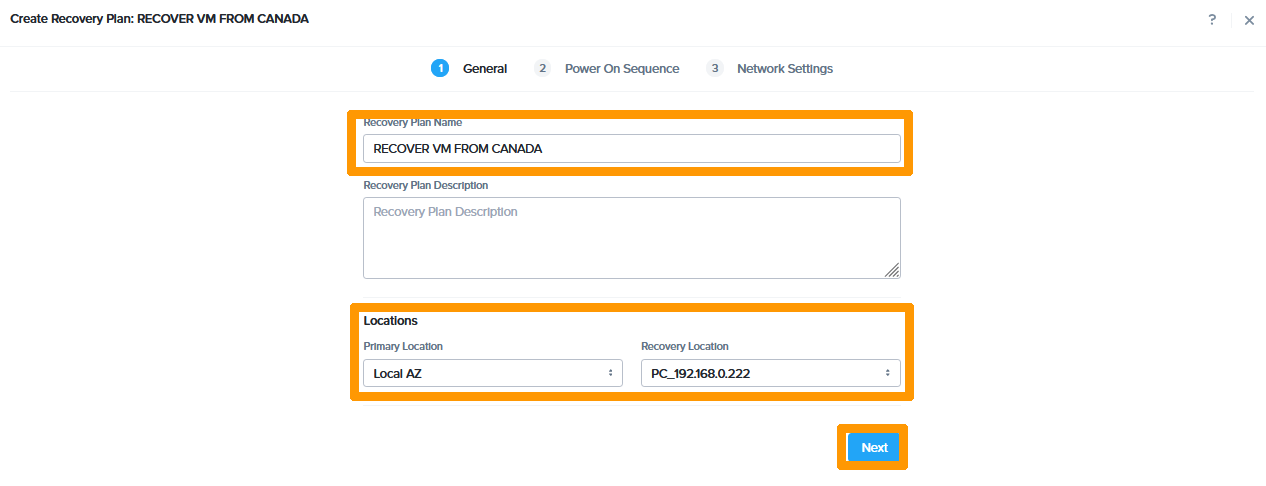

Enter these values:
  • Recovery Plan Name: the name of the disaster recovery plan.
  • Primary Location: Local AZ to choose the zone containing the local cluster.
  • Recovery Location: Name of the Remote Area that will be used for the disaster recovery plan.
Click Next.

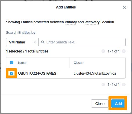

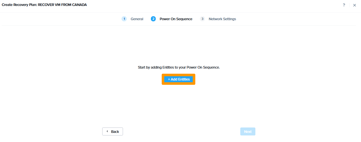

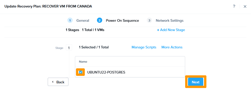

Click Add Entities.
Create Recovery Plan 04
Select the checkbox next to the virtual machine that is part of the disaster recovery plan, then click Add.
Create Recovery Plan 05

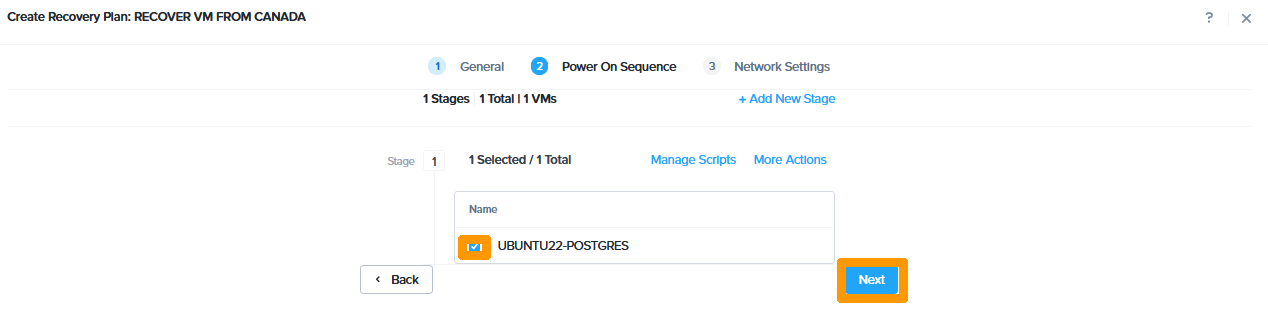

Select the checkbox next to the virtual machine that should start automatically when the disaster recovery plan is enabled.
Then click Next.

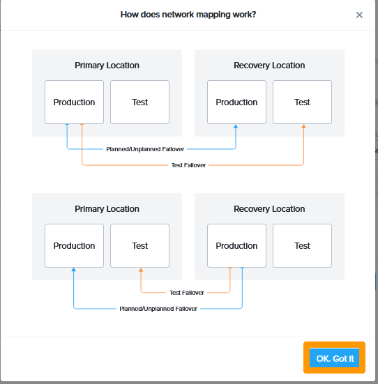

Create Recovery Plan 06
After reviewing the Disaster Recovery Plan presentation, click OK, Got it.
Create Recovery Plan 07

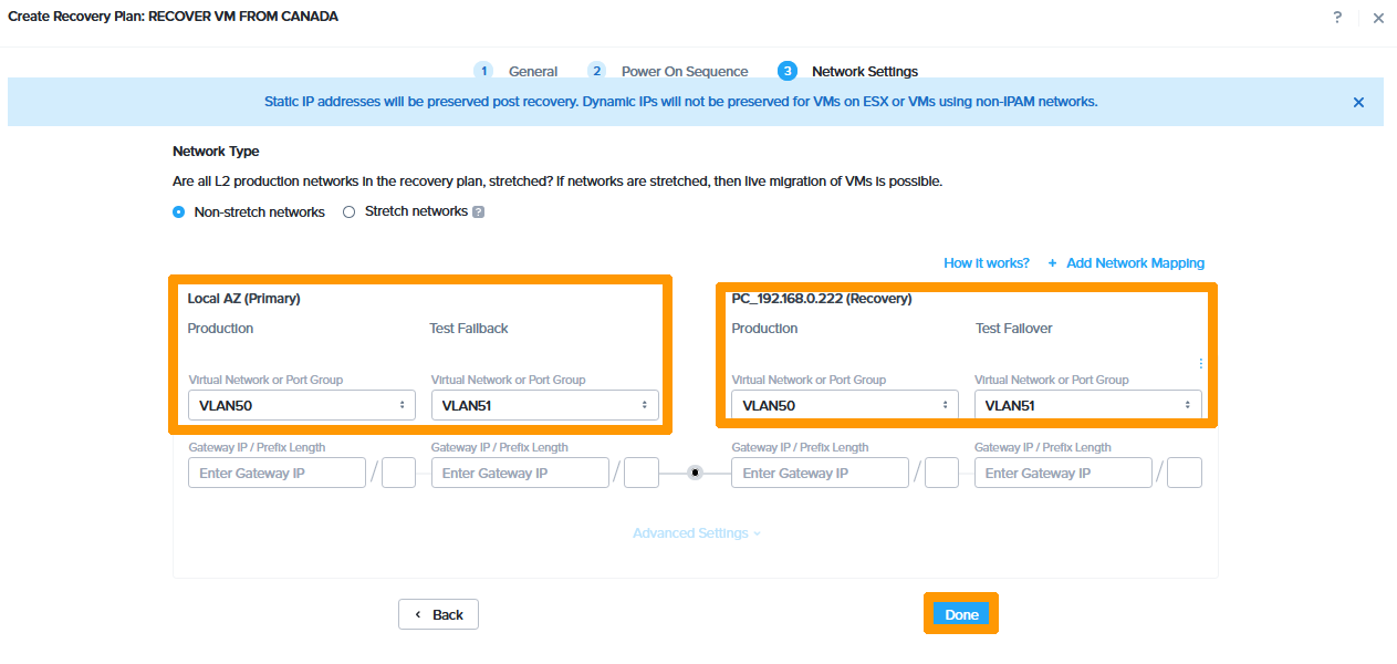

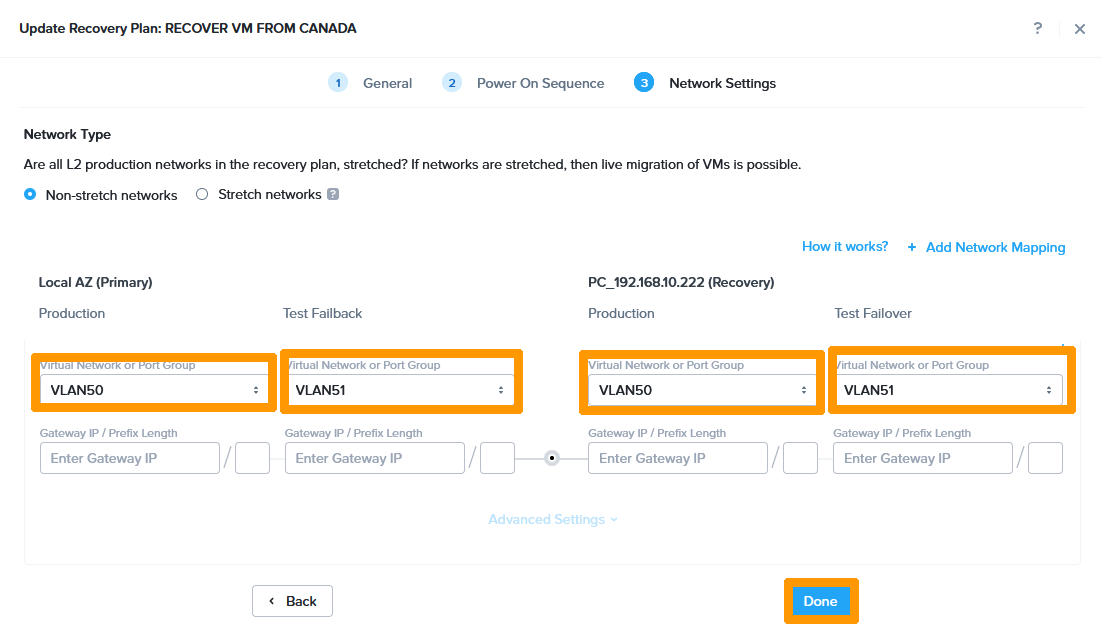

On the primary site, choose these options:
  • Production: Production VLAN
  • Test Failback: Test VLAN
On the recovery site, choose these options:
Then click Done.
Create Recovery Plan 08

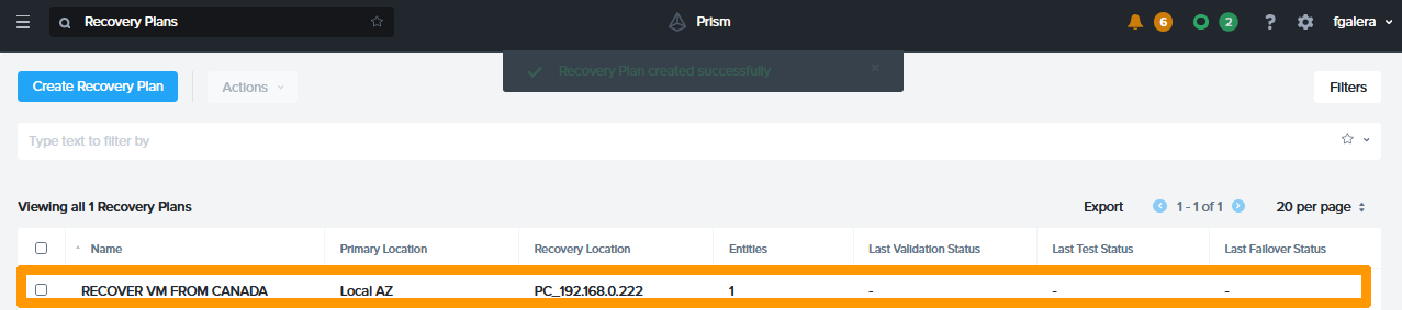

The disaster recovery plan appears in the list.
Create Recovery Plan 09

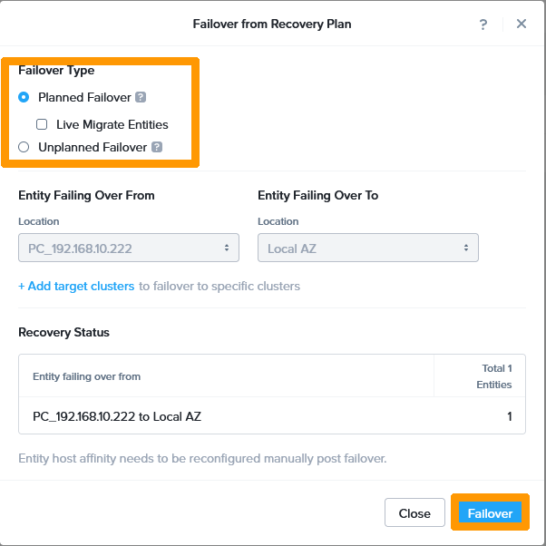

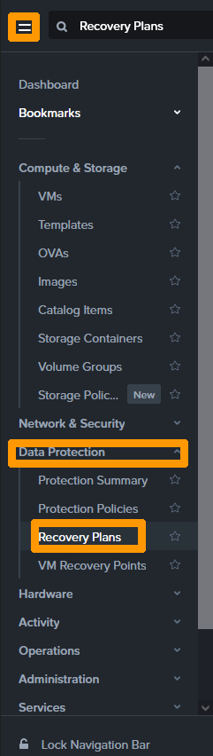

Connect with Prism Central on the cluster in France to switch the virtual machine from Canada to France.
From the main menu, choose Recovery Plans in the Data Protection section.
Planned Migration 01

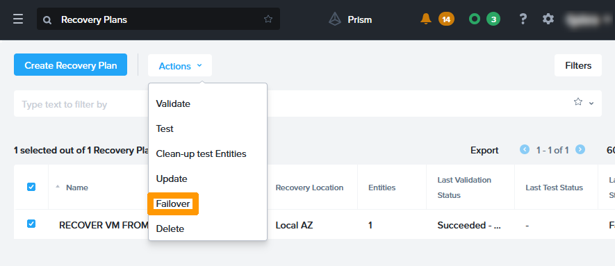

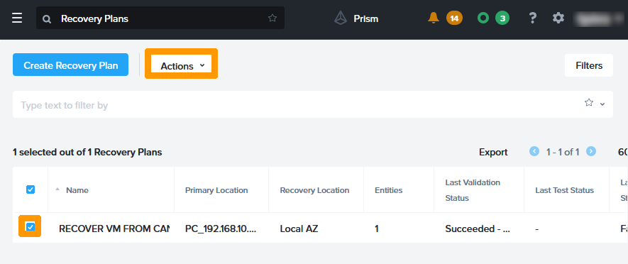

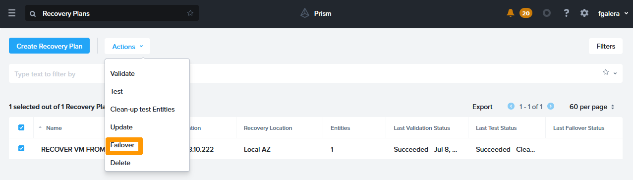

Select the disaster recovery plan by using the checkbox to the left of it, then click the Actions button to open the menu.
Planned Migration 02

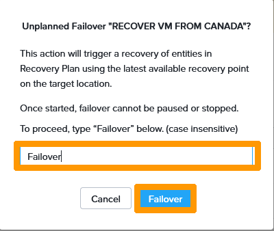

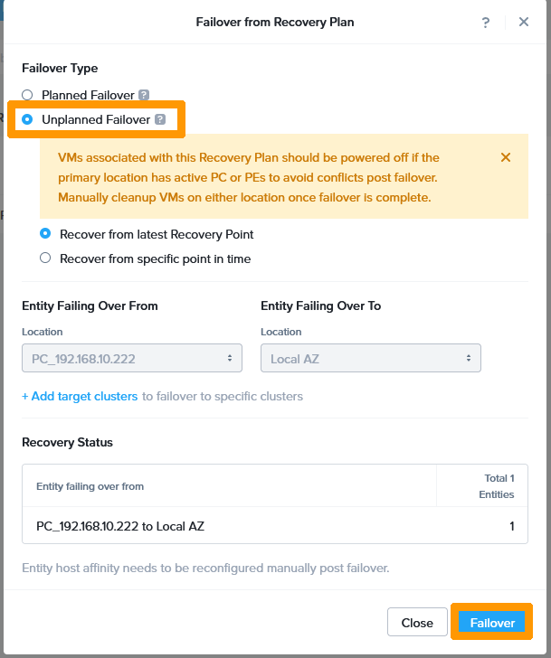

Click Failover.
Planned Migration 03

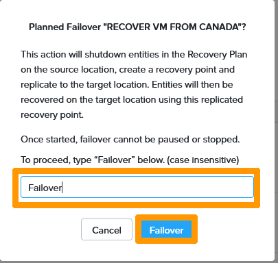

Select Planned Failover as the type of Failover and click the Failover button.
Planned Migration 04
Type Failover in the confirmation field and click the Failover button.
Planned Migration 05

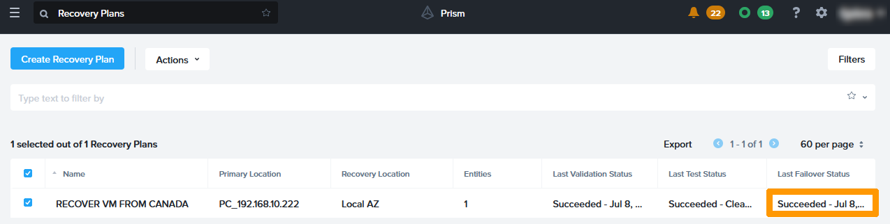

The migration steps are described below:
  1. Stopping the virtual machine on the original cluster.
  2. Synchronising the latest changes.
  3. Deleting the virtual machine on the original cluster.
  4. Adding the virtual machine on the destination cluster.
  5. Starting the virtual machine on the destination cluster.
The result of the migration appears in the Last Failover Status column with the status Succeeded if everything went well.

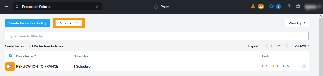

Using Prism Central, log in to the destination cluster in France.
From the main menu, choose Protection Policies from the Data Protection submenu.
Replication Inversion 01

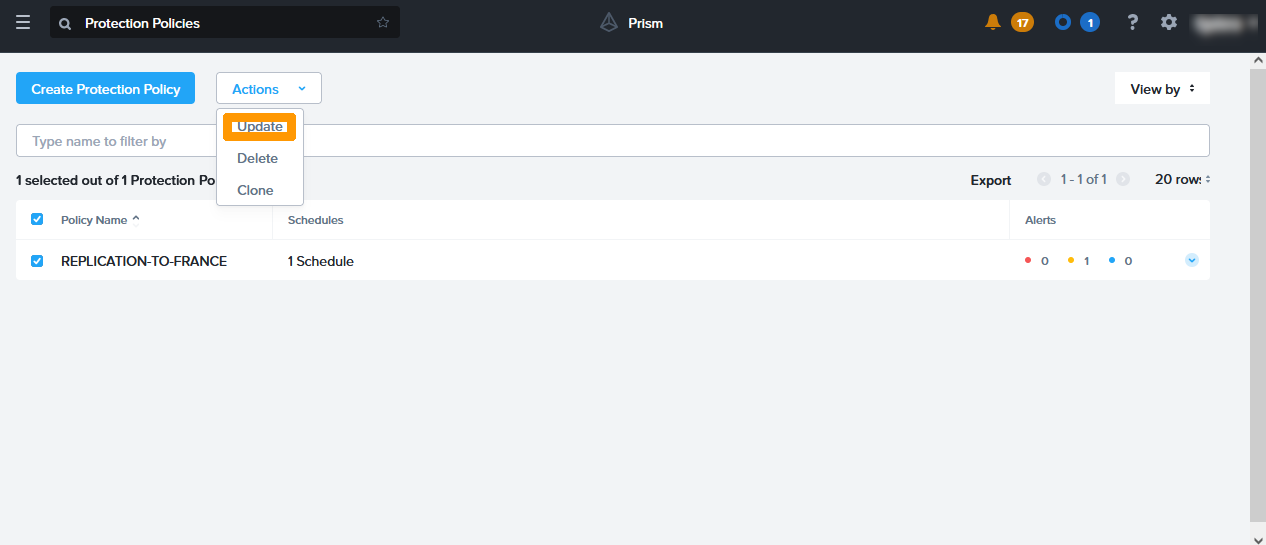

Select the checkbox to the left of the protection policy and click the Actions button.
Replication Inversion 02
Click the Update button.

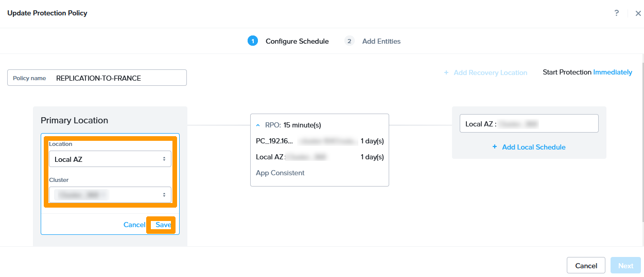

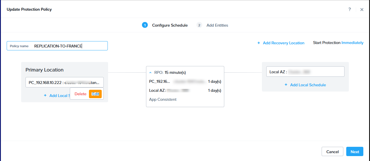

Move left under Primary Location until a menu appears. Click Edit.
Replication Inversion 04

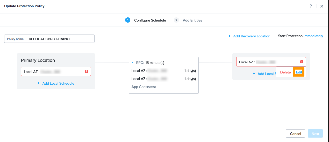

Edit the following information in the Primary Location frame:
  • Cluster: local area cluster
Then click Save.

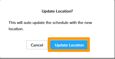

Replication Inversion 05

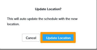

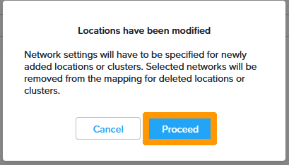

Click Update Location.
Replication Inversion 06
Move to the right below the destination until a menu appears. Click Edit.

Then edit the following information as part of Recovery Location:
  • Location: destination area.
  • Cluster: cluster of the destination area.
Click Save.
Replication Inversion 08

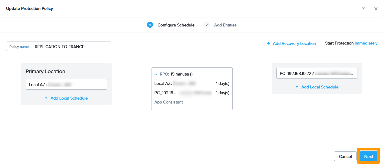

Replication Inversion 09

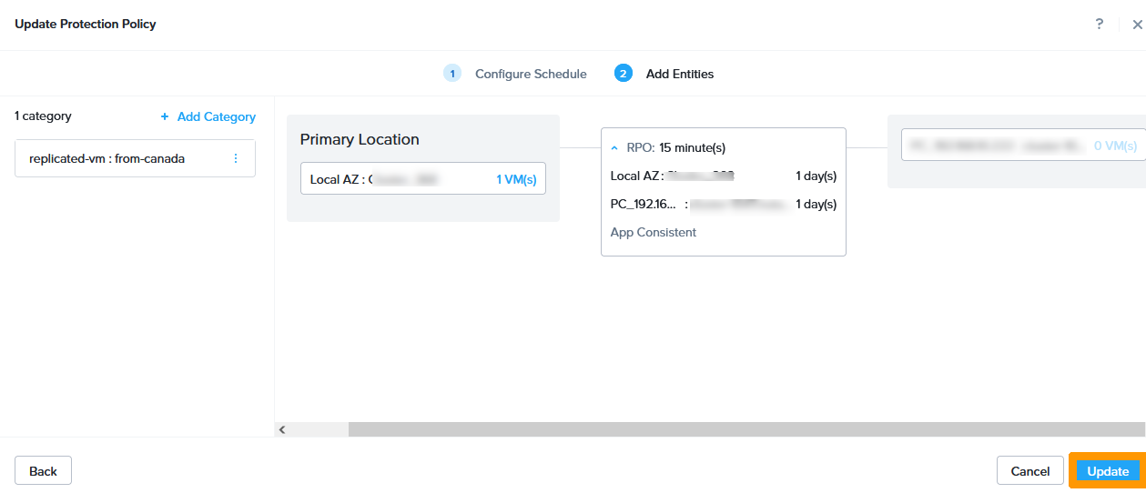

Click Next.
Replication Inversion 10
Click Update to complete the inversion.
Replication Inversion 11

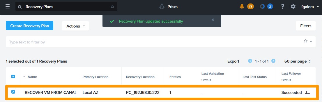

Modifying Disaster Recovery Plan
You must also change the disaster recovery plan by reversing the source and destination.

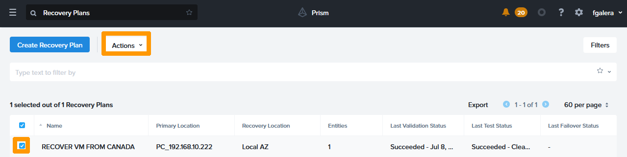

From the main menu, choose Recovery Plans from the Data Protection submenu.
Recovery Plan Inversion 01

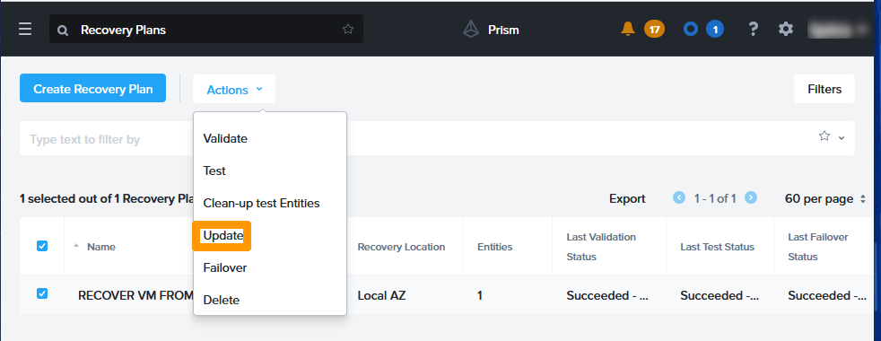

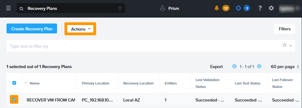

Select the disaster recovery plan by using the checkbox to the left of the plan, then click the Actions button.
Recovery Plan Inversion 02

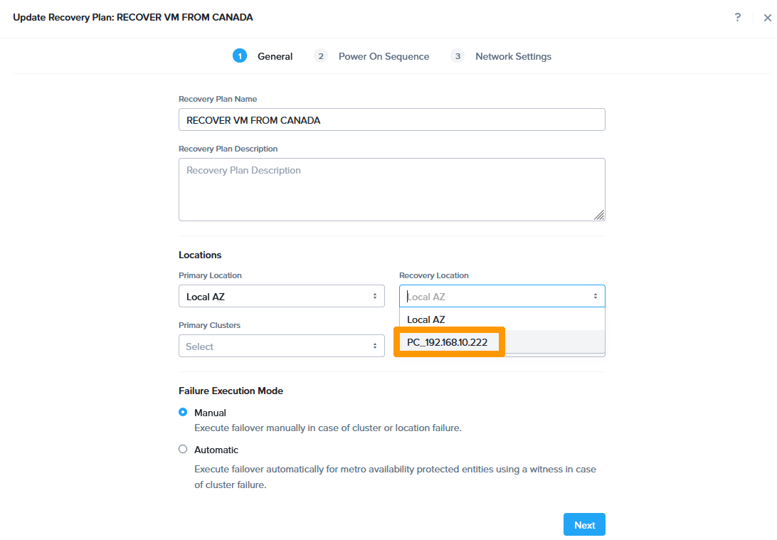

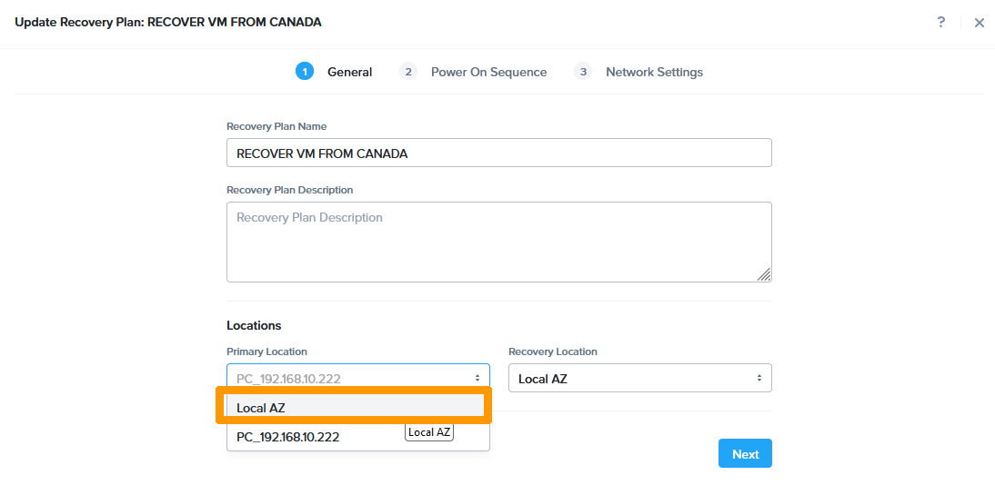

From the actions menu, click Update.
Recovery Plan Inversion 03

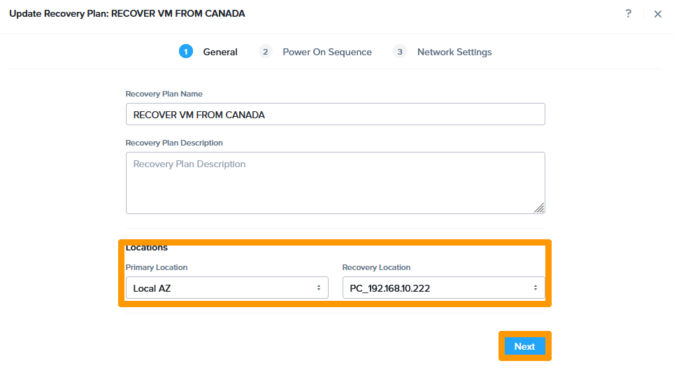

In the Primary Location drop-down menu on the left, replace the remote cluster with Local AZ.
Recovery Plan Inversion 04
Choose The remote area in Recovery Location on the right instead of Local AZ.
Recovery Plan Inversion 05
Now that the source and destination of the disaster recovery plan have changed, click Next.
Recovery Plan Inversion 06
Click Proceed.
Recovery Plan Inversion 07
Select the Virtual Machine that you want to start during the disaster recovery plan and click Next.
Recovery Plan Inversion 08
At the destination site, choose these options:
  • Test Failover: Test VLAN
Then click Done.

The disaster recovery plan has been modified to allow the virtual machines in the cluster to be switched from the French to the Canadian virtual machines.
If you want to return to the original operation, you will need to failover, change replication, and change the disaster recovery plan.

In our case, replication is scheduled every 15 minutes, the risk of data loss can, in the worst case, corresponds to this duration.
From Prism Central, connect to the cluster that is receiving replicas.
From the main menu, choose Recovery Plan from the Data Protection submenu.
Unplanned Recovery 01
Select the Disaster Recovery Plan with the checkbox and click the Actions button.
Unplanned Recovery 02
Choose Failover from the menu.
Unplanned Recovery 03
Check Unplanned Failover and click Failover
Unplanned Recovery 04
Type Failover in the confirmation field and click Failover
Unplanned Recovery 05
The virtual machine that is a member of the disaster recovery plan will boot to the destination cluster with the contents of the last replication.
