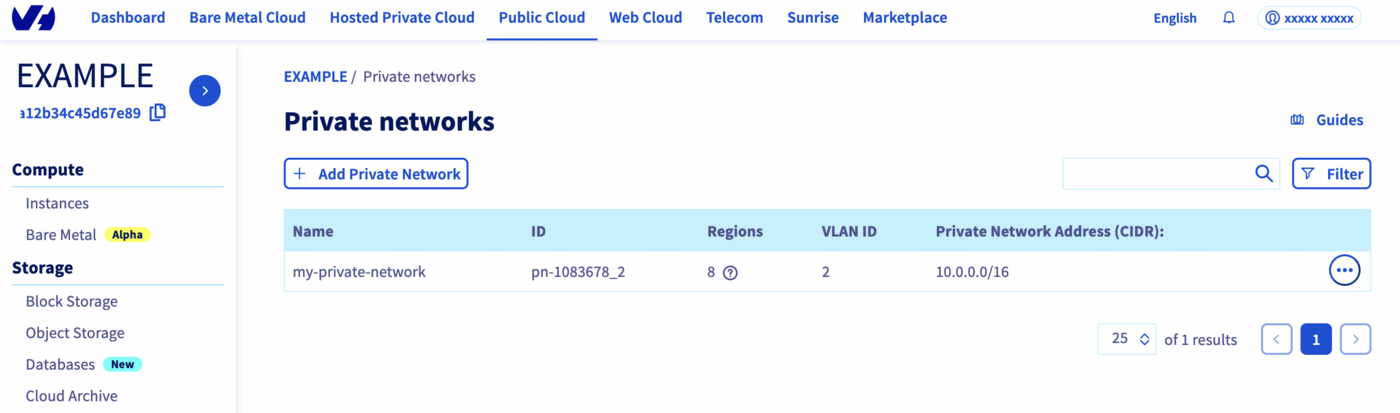

First of all, we will need to set up vRack Private Network for our Public Cloud. To do it, we follow the Configuring vRack for Public Cloud guide. Once you have created a vRack and added it into a Private Network, you can continue.
Setting-up the vRack

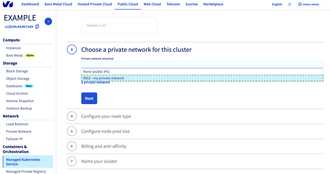

Then we create a Kubernetes cluster, as explained in the Create a cluster guide. Integrating a cluster into a vRack Private Network must be done at the third step on cluster creation, when we can choose an existing private network for the cluster:
Choose a private network for this cluster
Our new cluster will be created inside the vRack Private Network we have chosen.

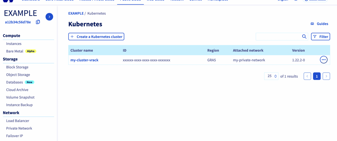

In the Managed Kubernetes Service Dashboard, we can see the cluster, with the chosen private network in the Attached network column:
Private network information in Attached network column

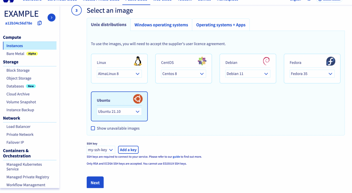

We are going to create an Ubuntu instance:
Setting-up PCI - Ubuntu instance

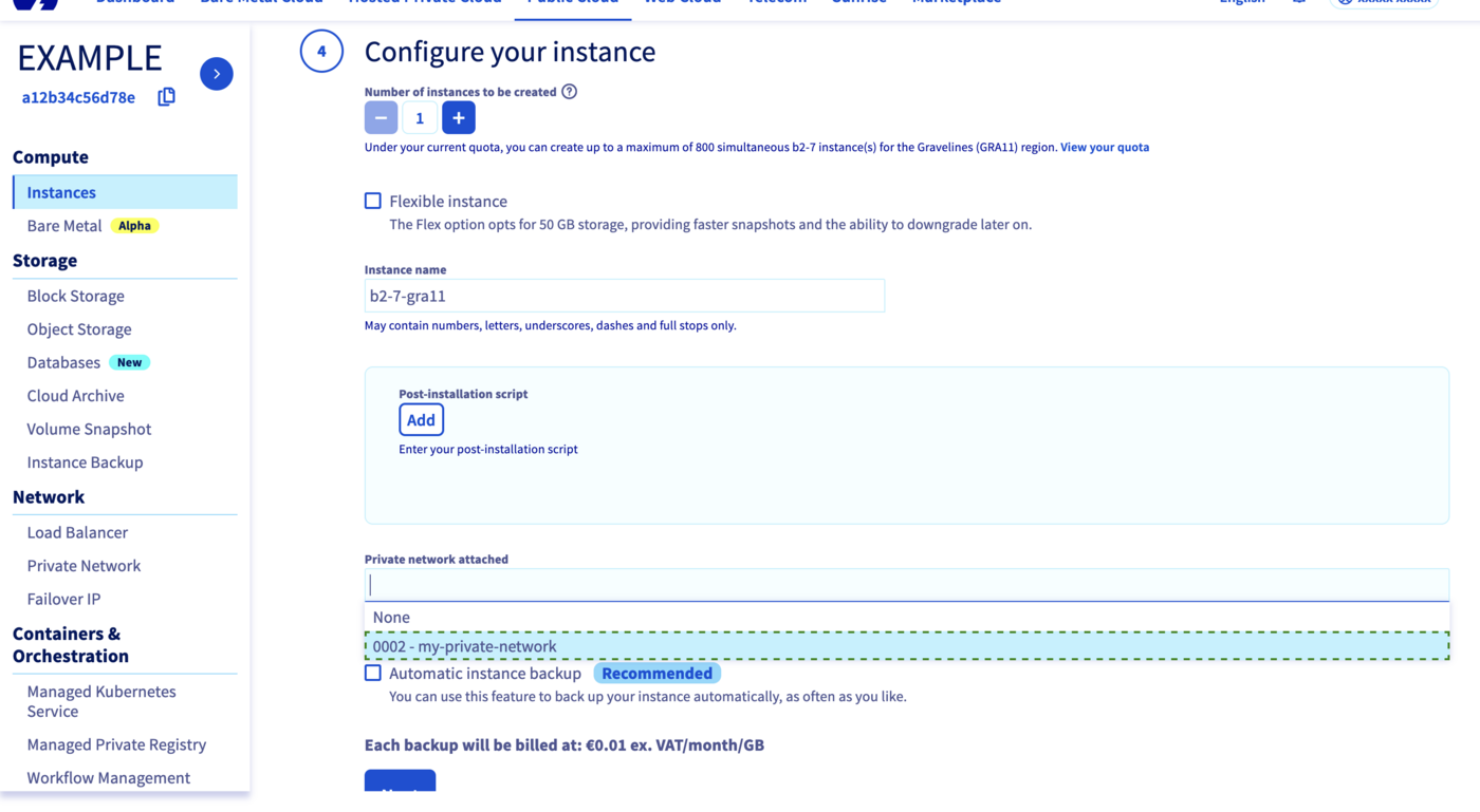

In the fourth step of creation, we attach it to the private network we created before:
Setting-up PCI - Attaching to a private network

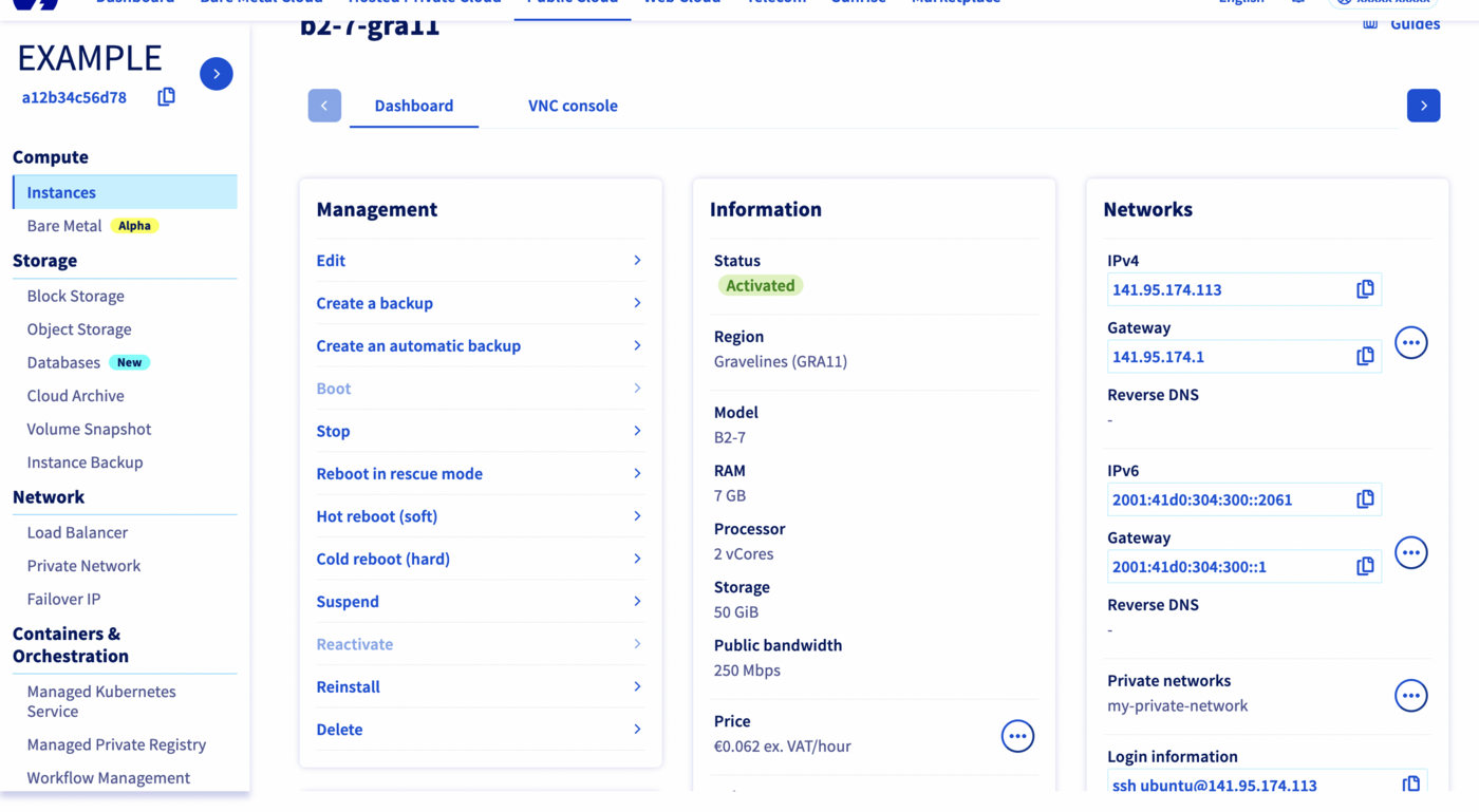

After instance creation, click on the name of the newly created instance, and then scroll down a little in order to see the connection details in the OVHcloud Control Panel.
Setting-up PCI - SSH connection information

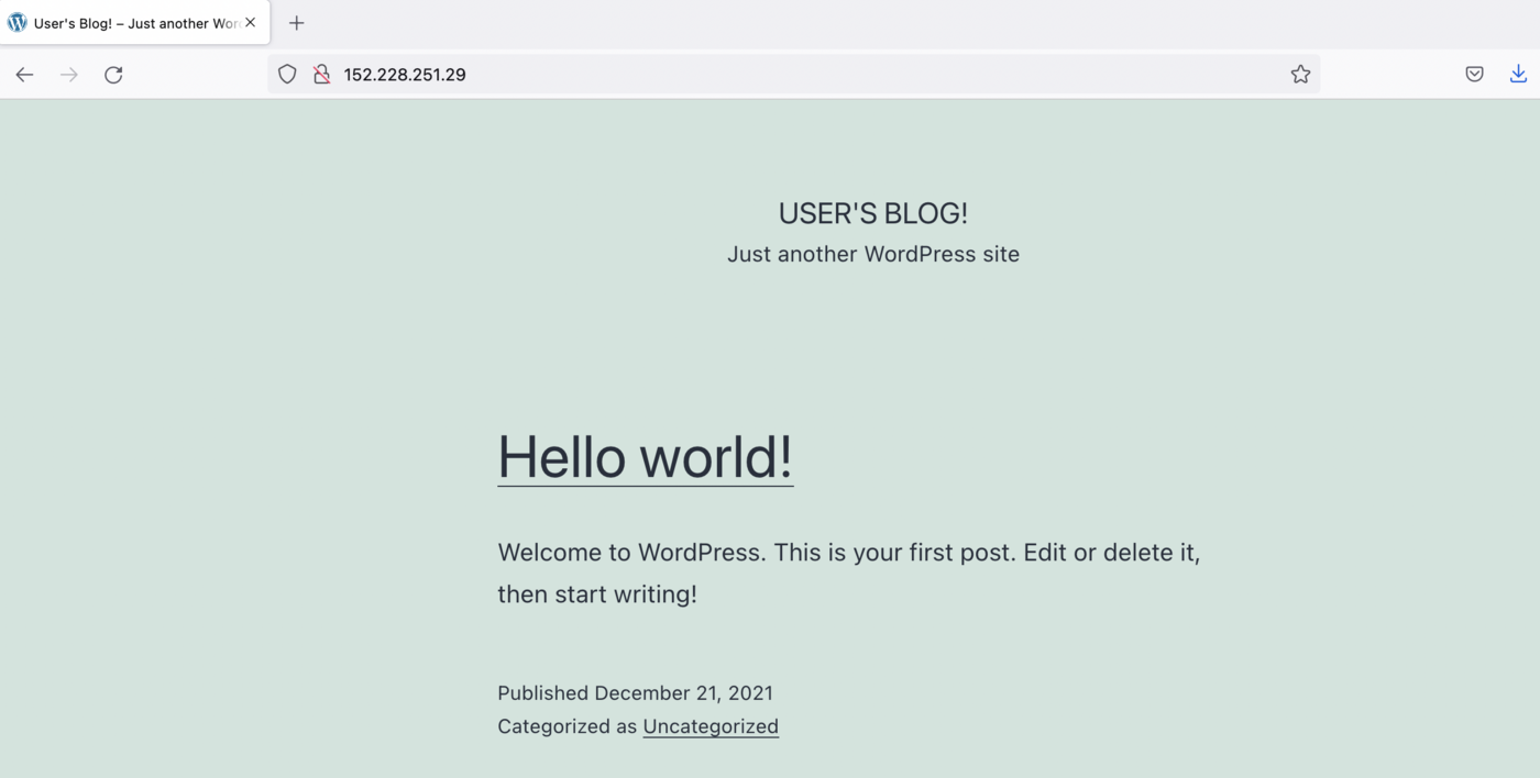

Setting up WordPress
Now we have set up the database, we can deploy WordPress on the Kubernetes cluster. We are following a similar process as in our Installing WordPress tutorial, but adapting it to use an external database.
Pre-requisites
We (the OVHcloud Managed Kubernetes Service team) are working on a patch to be released in early 2022. In the meantime, please remove the default storage class and install the new one.
  • Delete the concerned StorageClass that you are using by default
kubectl delete storageclasses.storage.k8s.io csi-cinder-high-speed
It will delete the existing StorageClass:
$ kubectl delete storageclasses.storage.k8s.io csi-cinder-high-speed
storageclass.storage.k8s.io "csi-cinder-high-speed" deleted
  • Create a new StorageClass with the required fix
kubectl apply -f https://raw.githubusercontent.com/ovh/docs/develop/pages/public_cloud/containers_orchestration/managed_kubernetes/fix-persistent-volumes-permissions/files/fixed-cinder-high-speed-storage-class.yaml
It will apply the correct StorageClass YAML manifest:
$ kubectl apply -f https://raw.githubusercontent.com/ovh/docs/develop/pages/public_cloud/containers_orchestration/managed_kubernetes/fix-persistent-volumes-permissions/files/fixed-cinder-high-speed-storage-class.yaml
storageclass.storage.k8s.io/csi-cinder-high-speed created
Using the WordPress Helm chart
For this tutorial we are using the WordPress Helm chart found on Bitnami repository. The chart is fully configurable, but we will only need to tweak the external database parameters:
mariadb.enabled
externalDatabase.host
externalDatabase.user
externalDatabase.password
externalDatabase.database
externalDatabase.port
As externalDatabase.host we will need to use the MariaDB instance's private network IP address, that be written down after creating the PCI.
helm install my-first-k8s-wordpress bitnami/wordpress --set mariadb.enabled=false,externalDatabase.host=<MARIADB_ADDRESS>,externalDatabase.user=wordpress_user,externalDatabase.password=a_strong_password,externalDatabase.database=wordpress_db,externalDatabase.port=3306
Don't forget to replace <MARIADB_ADDRESS> with the private network IP address of the MariaDB instance (in this case 10.0.64.51).
$ helm install my-first-k8s-wordpress bitnami/wordpress --set mariadb.enabled=false,externalDatabase.host=10.0.64.51,externalDatabase.user=wordpress_user,externalDatabase.password=a_strong_password,externalDatabase.database=wordpress_db,externalDatabase.port=3306
LAST DEPLOYED: Tue Dec 21 10:30:26 2021
NAMESPACE: default
STATUS: deployed
REVISION: 1
TEST SUITE: None
NOTES:
CHART NAME: wordpress
CHART VERSION: 12.2.7
APP VERSION: 5.8.2
** Please be patient while the chart is being deployed **
Your WordPress site can be accessed through the following DNS name from within your cluster:
    my-first-k8s-wordpress.default.svc.cluster.local (port 80)
To access your WordPress site from outside the cluster follow the steps below:
1. Get the WordPress URL by running these commands:
  NOTE: It may take a few minutes for the LoadBalancer IP to be available.
        Watch the status with: 'kubectl get svc --namespace default -w my-first-k8s-wordpress'

Then we can follow the instructions to get the Admin URL:
export SERVICE_IP=$(kubectl get svc --namespace default my-first-k8s-wordpress --template "{{ range (index .status.loadBalancer.ingress 0) }}{{.}}{{ end }}")
$ echo "WordPress URL: http://$SERVICE_IP/"
WordPress URL: http://152.228.251.29/
$ echo "WordPress Admin URL: http://$SERVICE_IP/admin"
WordPress Admin URL: http://152.228.251.29/admin
And putting the URL in the browser will take us to the new blog, accessing the MariaDB database from the PCI instance via the vRack.
