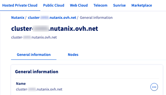

  1. From the OVHcloud Control Panel, navigate to your Nutanix cluster via the Hosted Private Cloud and Nutanix menus.
    Nutanix cluster overview

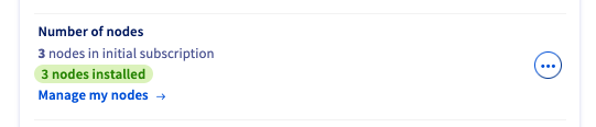

  2. In the General information tab, you can see the Number of nodes. Click Manage my nodes.
    Number of nodes

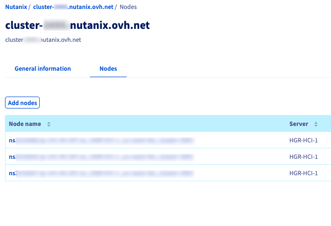

  3. In the Nodes tab, select Add nodes.
    Add nodes tab

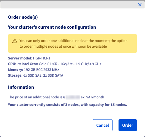

  4. Review the configuration and pricing in the pop-up window, then click Order to add the node(s).
    Order popup

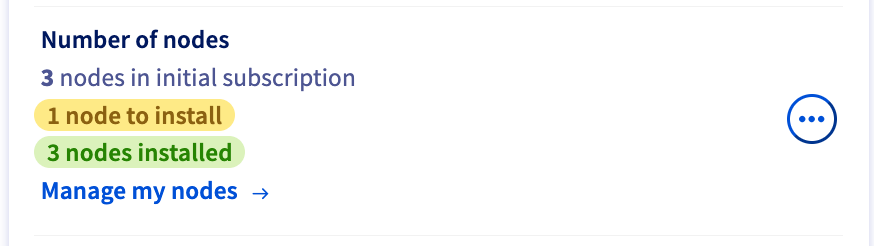

Once the node is delivered, you can see the status in the General information tab.
The Number of nodes area will show a new node to install.
New node to install

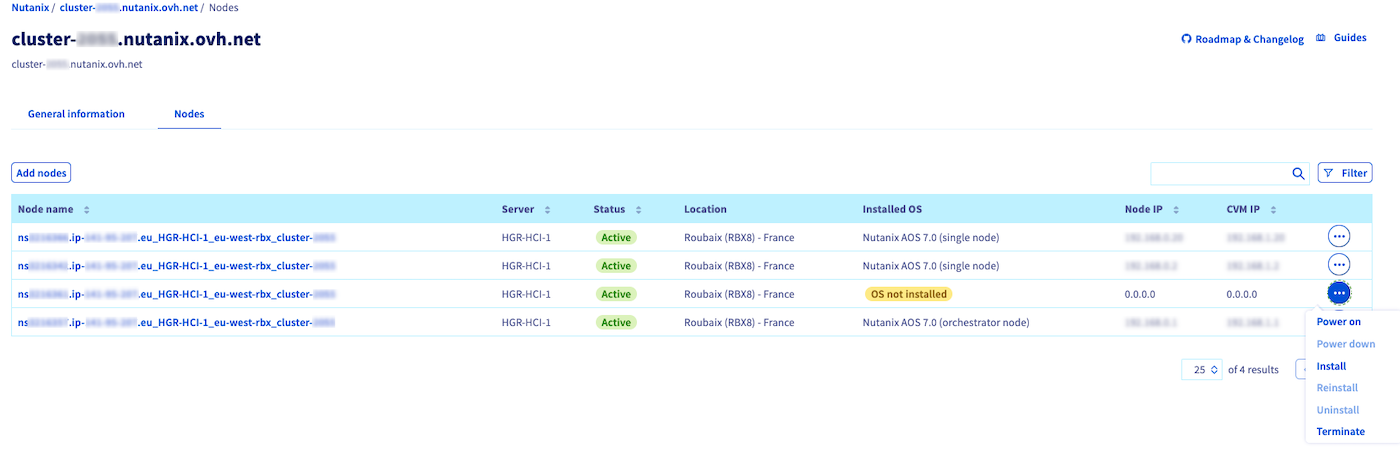

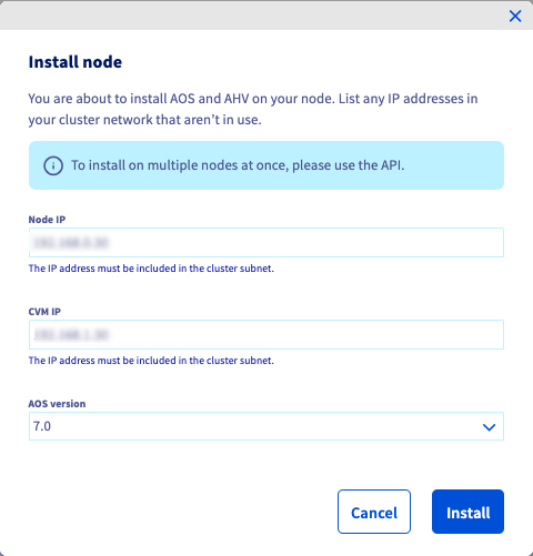

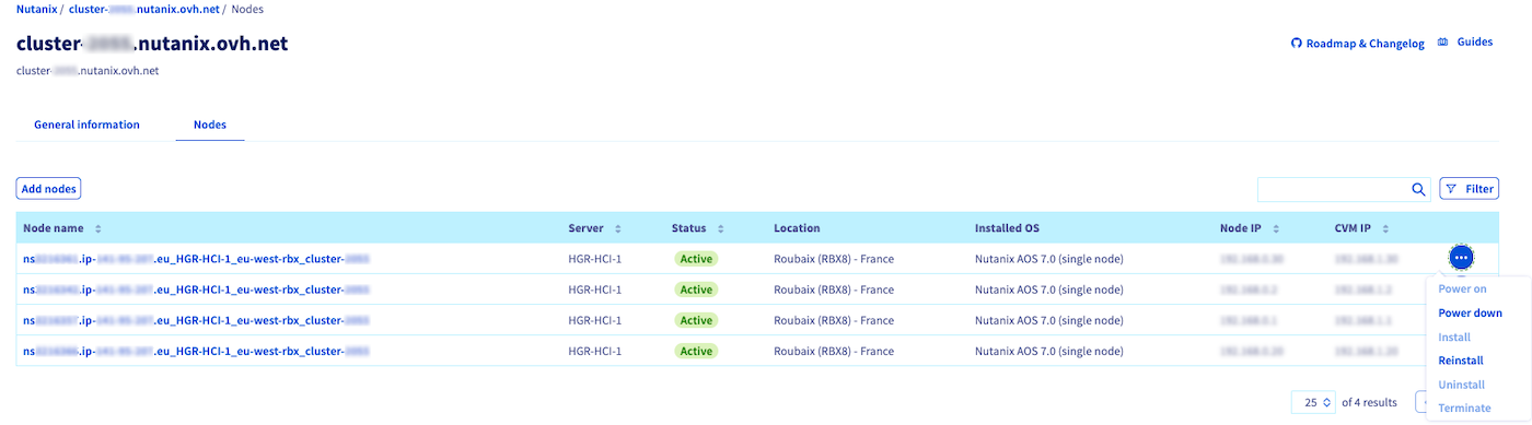

If you click Manage my nodes again, you will see a list of your nodes. For any node with an OS not installed status, click the more options ... button and select Install.
Node status
Enter the configuration details for your node. Be sure to install the same AOS version as your cluster.
Click Install.
Install option
A confirmation banner will appear.
Confirmation message

For the node you wish to remove, click the more options ... button and select Power down.
Power down

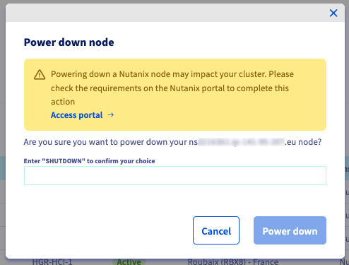

A warning pop-up will appear. Type the required term and click Power down.
Powering down a Nutanix node may impact your cluster. Please check the requirements on the Nutanix portal to complete this action.
Power down warning

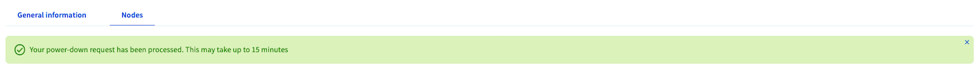

Power down confirmation

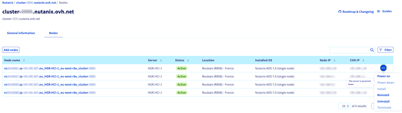

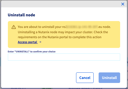

Once the node is powered down, click the more options ... button and select Uninstall.
Uninstall button
A warning pop-up will appear. Type the required term and click Uninstall.
Uninstalling a Nutanix node may impact your cluster. Please check the requirements on the Nutanix portal to complete this action.
Uninstall warning

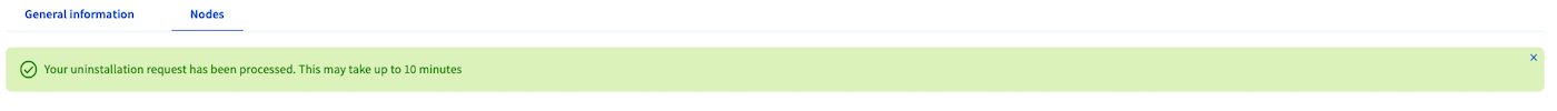

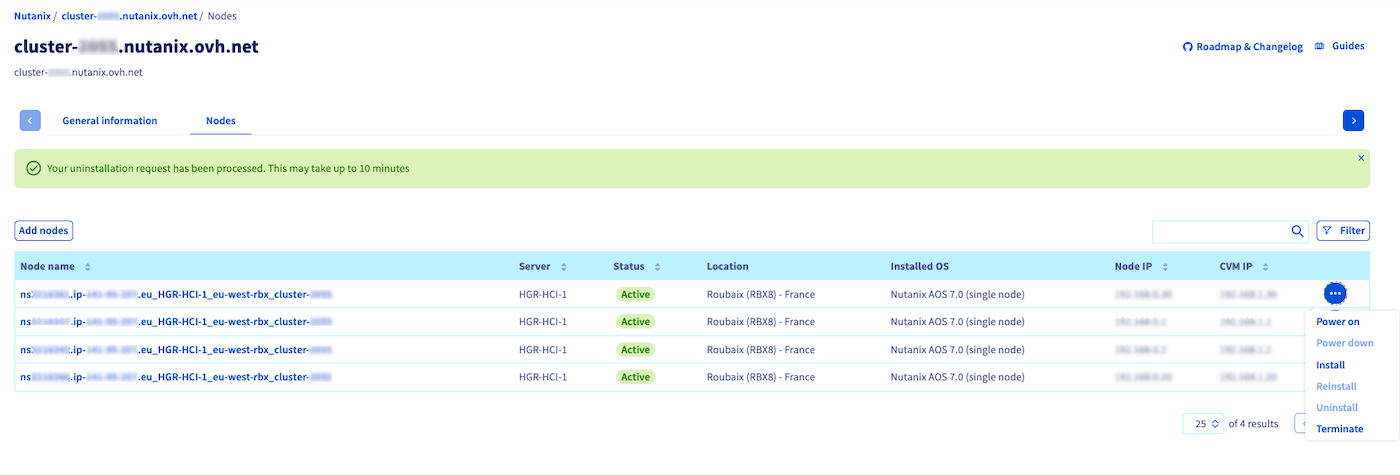

Uninstall confirmation
Remove the node
Once the node is uninstalled, click the more options ... button and select Terminate.
