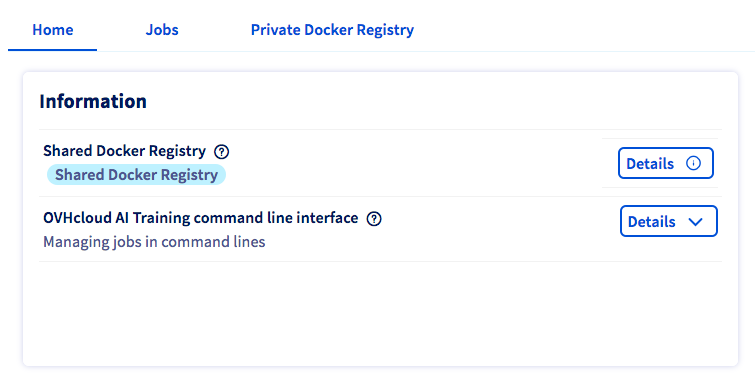

If you want to know the exact commands to push on your shared registry, please consult the Details button of the Shared Docker Registry section, in the Home panel of AI Training.
