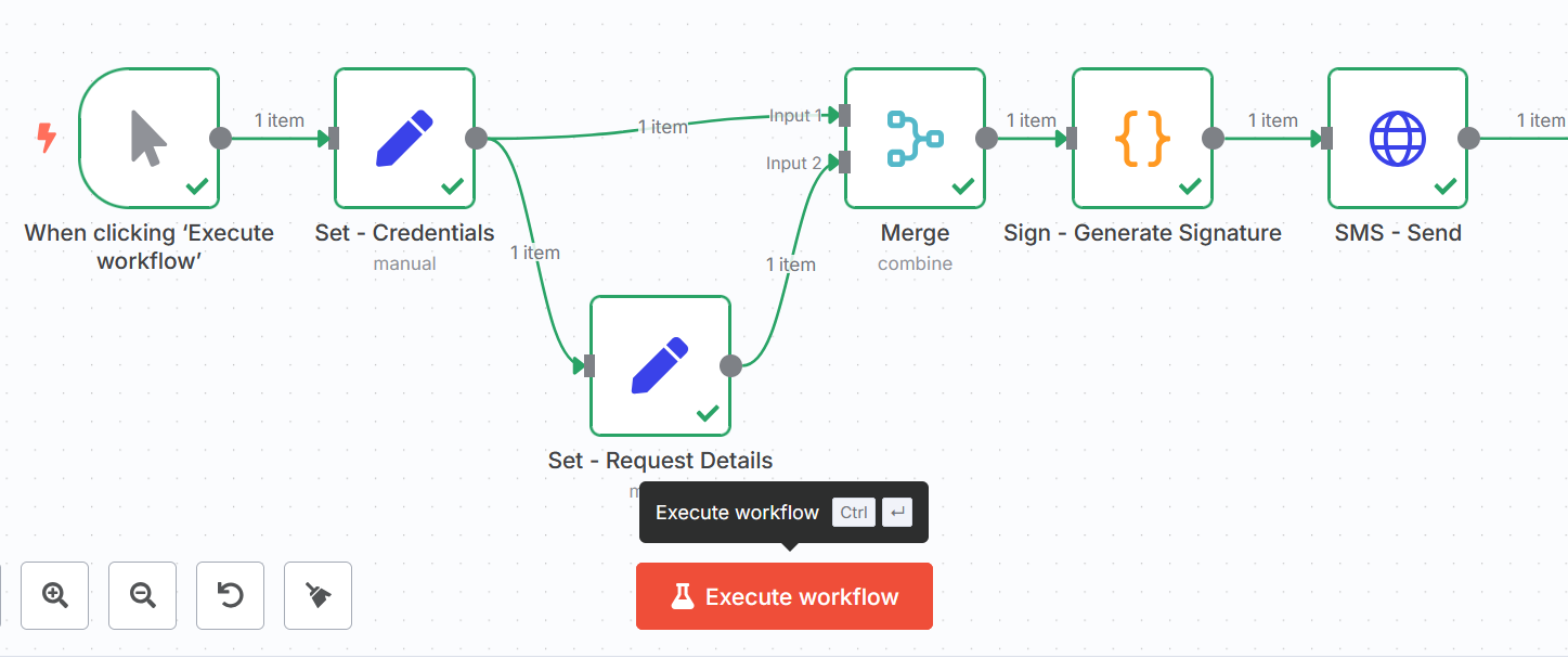

Connect the nodes in this order:
N8N SMS
The Merge node receives the outputs from the two Set - Credentials and Set - Request Details nodes, then feeds into Sign - Generate Signature, which feeds into SMS - Send.

Step 5 – Configure the Merge node
Configure the Merge node:
  • Mode: Combine.
  • Combine by: Position.
  • Number of Inputs: 2.
Connect Set - Credentials to Input 1 and Set - Request Details to Input 2.
At the output (output), you should have at the same level: applicationKey, applicationSecret, consumerKey, serviceName, timestamp and body.
