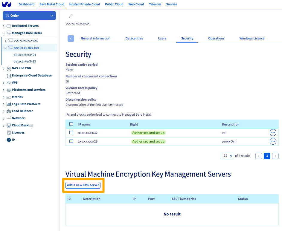

With the OVHcloud Control Panel
In your OVHcloud Control Panel, open the "Bare Metal Cloud" section, then select your service under Managed Bare Metal in the left-hand navigation bar.
From the main page of the service, click on the Security tab.
controlpanel
In the section Virtual Machine Encryption Key Management Servers, click on Add a new KMS Server.
controlpanel
In the new window, enter the following information:
  • IP address of the KMS
  • SSLThumbprint of the KMS
  • check the box to agree the correct consideration of this documentation
Then validate with Next.
controlpanel
A last window displays the progress of the task.

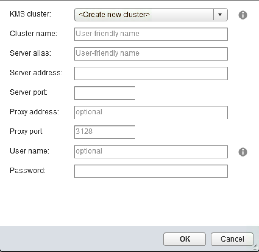

  • Connect to the Managed Bare Metal with the vSphere Web Client.
  • Browse the inventory list and select the vCenter.
  • Click on Manage then Key Management Servers.
  • Click Add KMS, specify the KMS information in the wizard, and then click OK.
  • Trust the certificate and click on Trust.
Choose the following options:
  • KMS cluster: Select Create new cluster for a new cluster. If a cluster exists, you can select it.
  • Cluster name: Name of the KMS cluster. You may need this name to connect to the KMS if your vCenter becomes unavailable. The name of the cluster is very important to be unique and keep a note of the same thing.
  • Server alias: Alias for the KMS. You may need this alias to connect to the KMS if your vCenter becomes unavailable.
  • Server address: IP address or FQDN of the KMS.
  • Server port: Port on which the vCenter server connects to the KMS. The standard KMIP port is 5696. It may vary if the KMS of another supplier is configured on a specific port.
  • Proxy address: leave empty
  • Proxy port: leave empty
  • User name: Some KMS providers allow users to isolate the encryption keys used by different users or groups by specifying a user name and password. Specify a user name only if your KMS supports this feature and you intend to use it.
  • Password: Some KMS providers allow users to isolate the encryption keys used by different users or groups by specifying a user name and password. Specify a password only if your KMS supports this feature and you intend to use it.

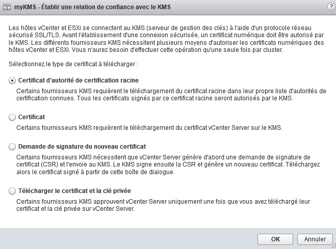

Import of the KMS certificate
Most KMS providers need a certificate to trust the vCenter.
From the vCenter where we added the KMS server
  • Select the KMS server that has been added
  • All options → Establish a trust relationship with KMS
WARNING
Make sure that the certificate is not encrypted with a password when we download the certificate from the KMS. Example: If you create a user, create a user without a password and download the certificate for the KMS user.

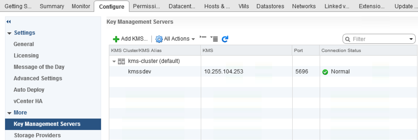

Check that the KMS is configured
Check that the Connection Status of the KMS is Normal:

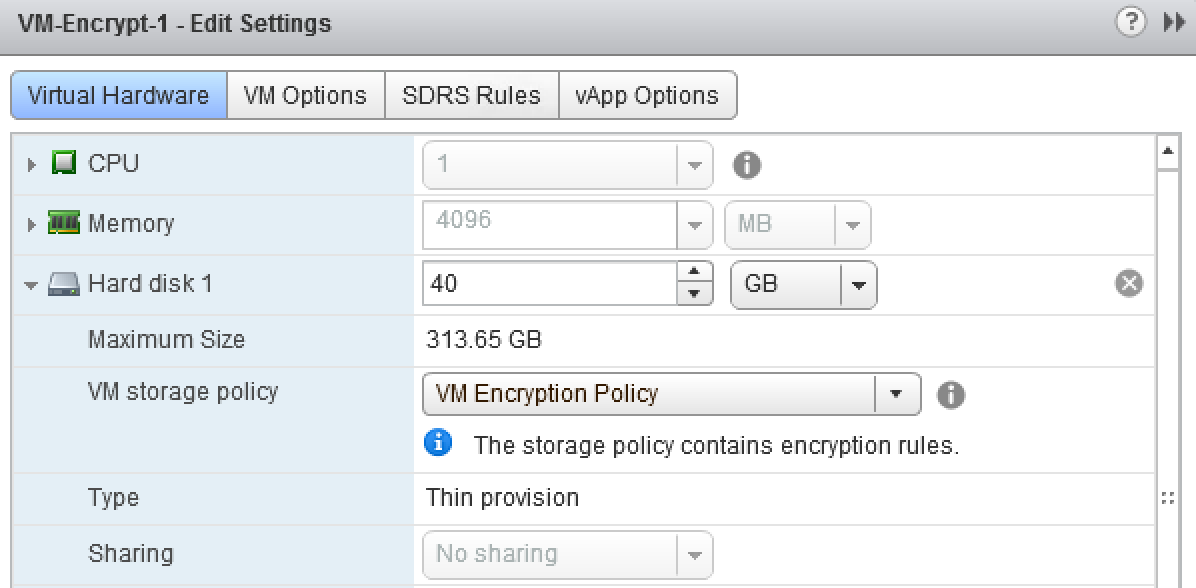

Change the storage policy of "VM Encryption Storage"

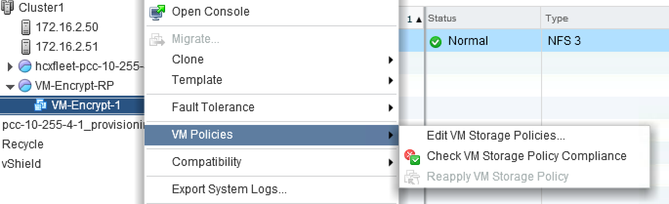

Create a virtual machine
Once the VM has been created, right-click on the virtual machine and choose VM PoliciesEdit VM Storage Policies.

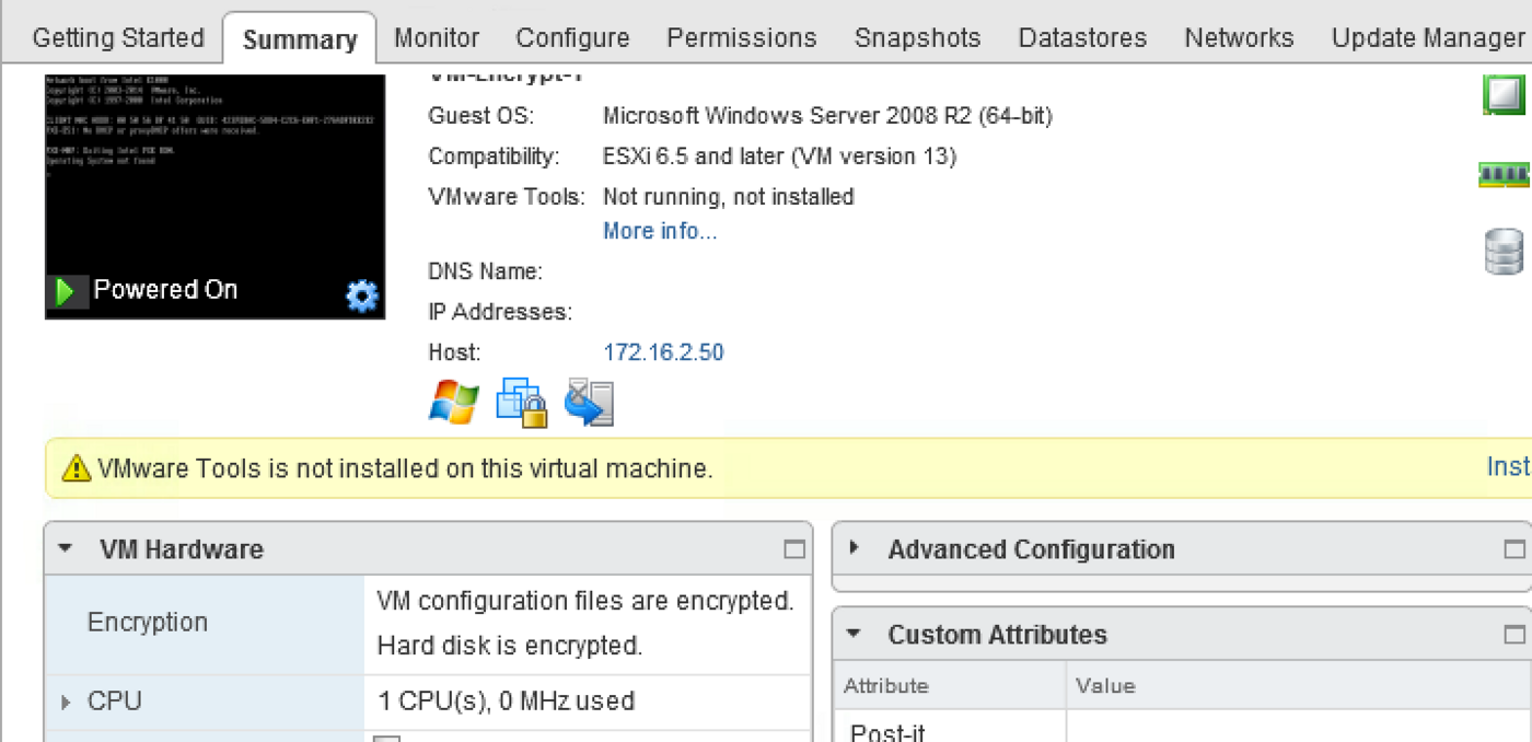

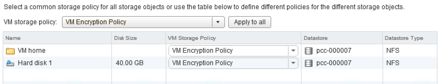

Select the VM files and other hard disks that need to be encrypted.

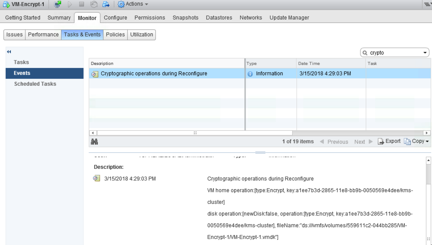

Make sure that the tasks are performed without errors.
INFO
If the KMS is not configured correctly and there are problems with the key exchange between vCenter and KMS, there will be a RuntimeFault error in the task with the error message Cannot generate Key.

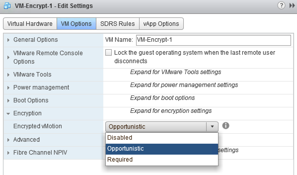

vMotion encrypted
For vMotion, encryption works at the VM level and for synchronization, 256-bit encryption keys are used.
VMotion traffic encryption works at the VM kernel level with the widely used AES-GCM (Advanced Encryption Standard / Galois Counter Mode) algorithm.
Modify the virtual machine and navigate to VM Options
We must select the options explicitly if we need encrypted vMotion
There are 3 policies for encrypted vMotion:
  • Disabled: Off.
  • Opportunistic: Encryption only if supported by the source host and ESXi target host, otherwise vMotion will not be encrypted.
  • Required: encryption is used.
The movement of machines between hosts is achieved by exchanging unique keys, which are generated and served by the vCenter server, rather than by KMS.
