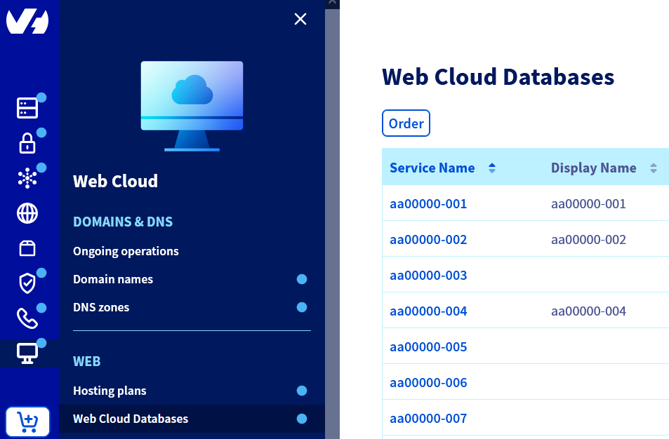

Click on the Web Cloud Databases menu, then choose the Web Cloud Databases solution concerned.

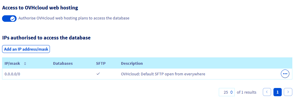

On the page that opens, click on the Authorised IPs tab.
On the page that appears, click the Add an IP address/mask button above the table.
TIP
If you want to modify an IP address or an IP address range that is already authorized, click the ... button in the line corresponding to the IP address or IP address range you want to modify, then click Edit the whitelist.
In the window that opens, you will need to enter the following information:
IP/mask *: Enter here the IP address (e.g.: 203.0.113.44) or IP address range (e.g.: 203.0.113.0/24 representing all IP addresses from 203.0.113.0 to 203.0.113.255) that you would like to authorize on your Web Cloud Databases solution.
Description (optional): For example, you can add information about the role of the IP address or IP address range concerned.
Databases: Tick this box if you want the IP address or IP address range to be authorized to access the databases on your Web Cloud Databases solution.
SFTP: Tick this box to authorize the IP address or IP address range to access the logs of your Web Cloud Databases solution.
WARNING
It is strongly recommended not to tick the Databases box to authorize the IP address range 0.0.0.0/0 to access your databases.
This would grant access to your databases to all IPv4 addresses.
Once you have entered the information, click Confirm.
When you activate your Web Cloud Databases solution, a line for the IP address range 0.0.0.0/0 is already present by default, to authorize SFTP access to the solution.
This authorization is voluntarily set up to allow you to access the log files of your Web Cloud Databases solution without having to declare the IP address of your Internet access point.
This IP address can change regularly, depending on the ISP.
In addition, we recommend that you do not modify this authorization, and do not authorize blanket access to the databases on your Web Cloud Databases solution.
Effectively, this would allow all existing IPv4 addresses to have access to your databases, which represents a risk for your data security.
