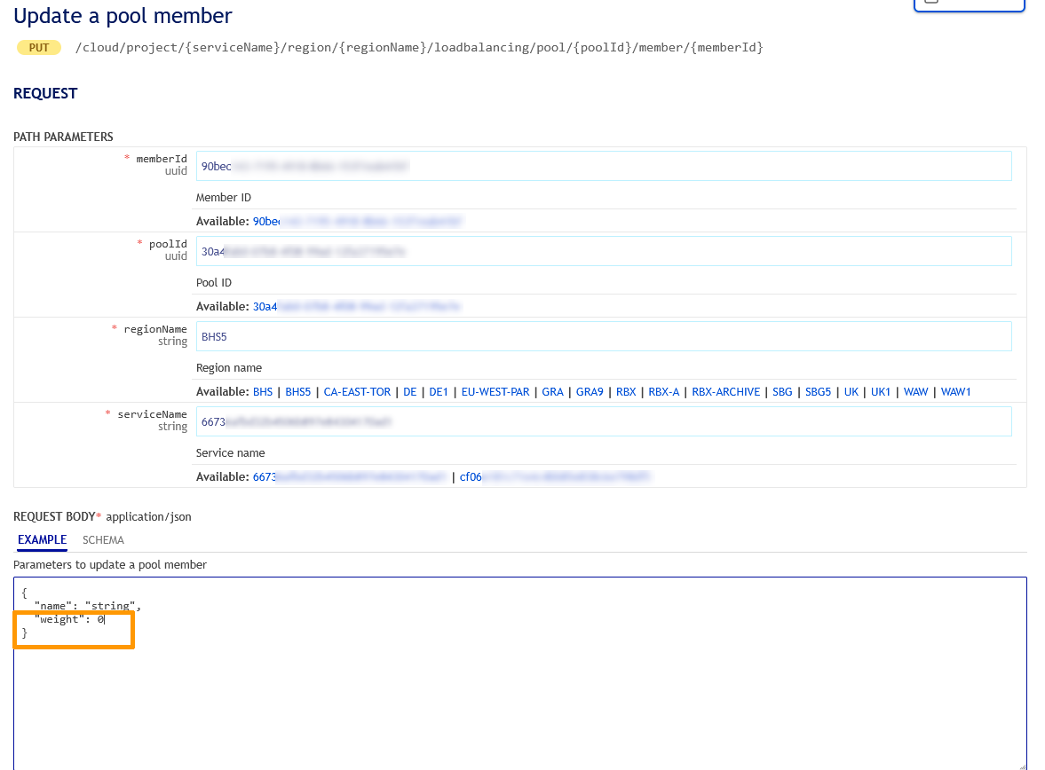

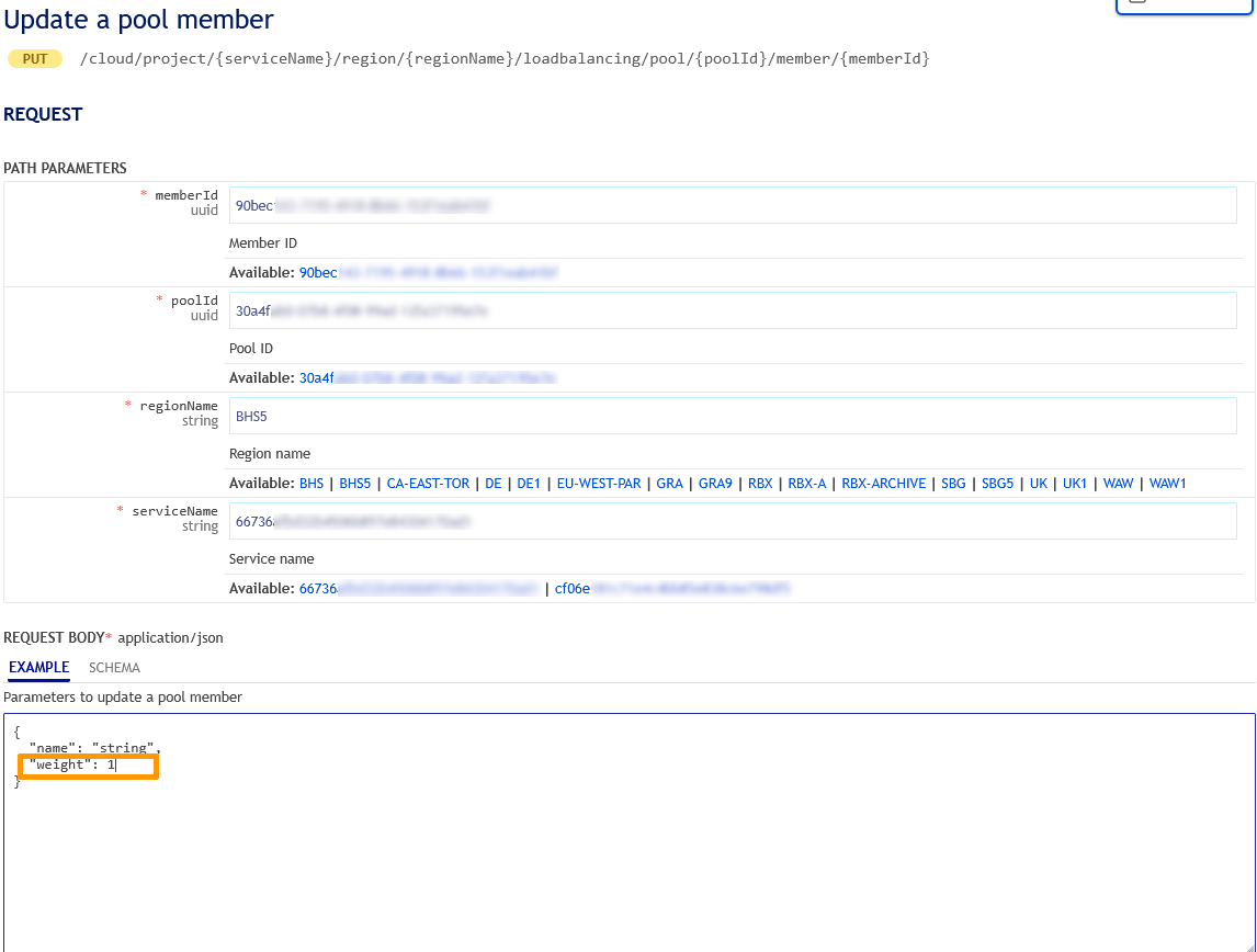

Fill in the fields with the previously obtained information:
serviceName: The Public Cloud project ID in the form of a 32-character string.
regionName: The name of your region.
poolId: The Pool ID in the form of a 32-character string.
memberId: The Member ID in the form of a 32-character string.
weight: Set the weight to 0.
Click on Execute.

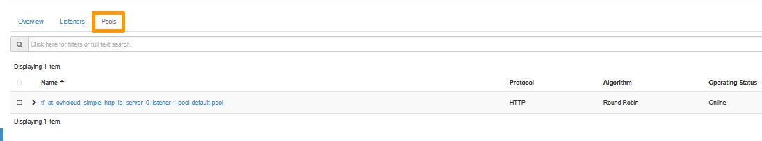

In the left tab, click the Network tab then on Load Balancers.
Click the load balancer concerned.

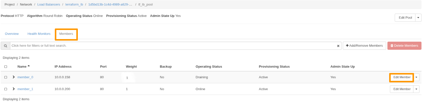

In the tab, click on Pools and then on the pool in which the member is.

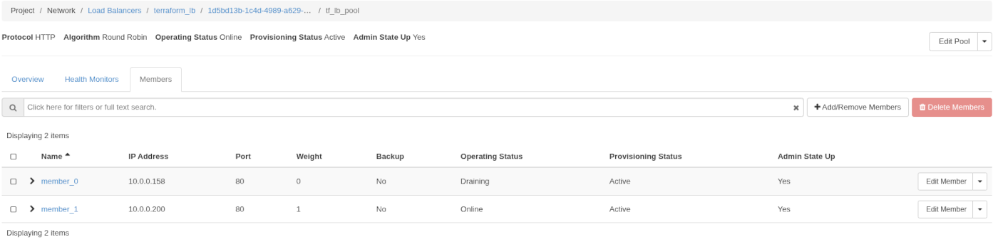

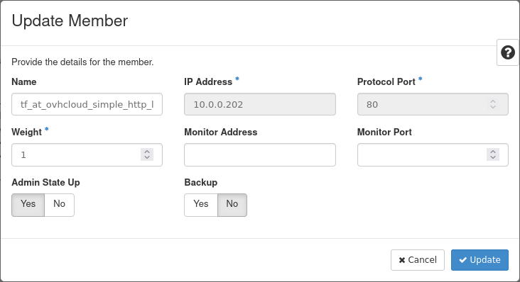

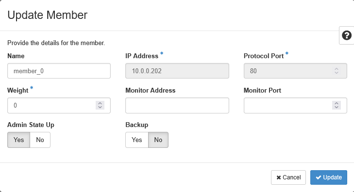

In the tab, click on Members and then on Edit Member.
Edit the Weight to 0, then click on Update.

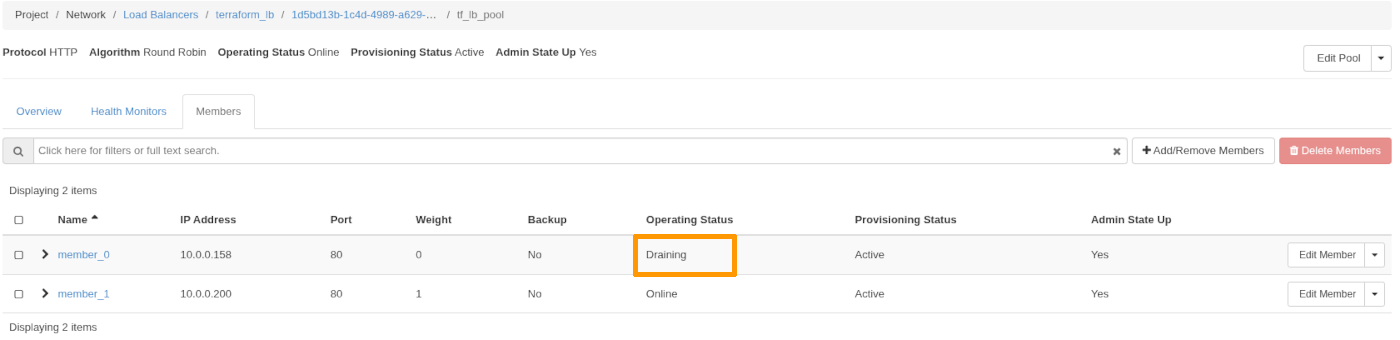

After setting the member's weight to 0, its status will change from ONLINE to DRAINING.
INFO
It is important to note that in the current system, the member will remain in the DRAINING state even after all traffic has been drained.
This can be confusing because some users expect a final status of DRAINED once all traffic has been redirected. However, the system does not automatically transition to DRAINED.
DRAINING simply means that the member is no longer receiving traffic, not that it is still actively draining traffic.
The DRAINED status is not yet supported in the current OpenStack API.
If having a final DRAINED status is critical for your operations, it is recommended to submit a feature request to OVHcloud for this functionality in a future update. However, this will only be possible once this feature is supported by OpenStack.
To check the member's status, click on Network in the left tab then on Load Balancers.
Click on the load balancer concerned.
Click the Members tab:
