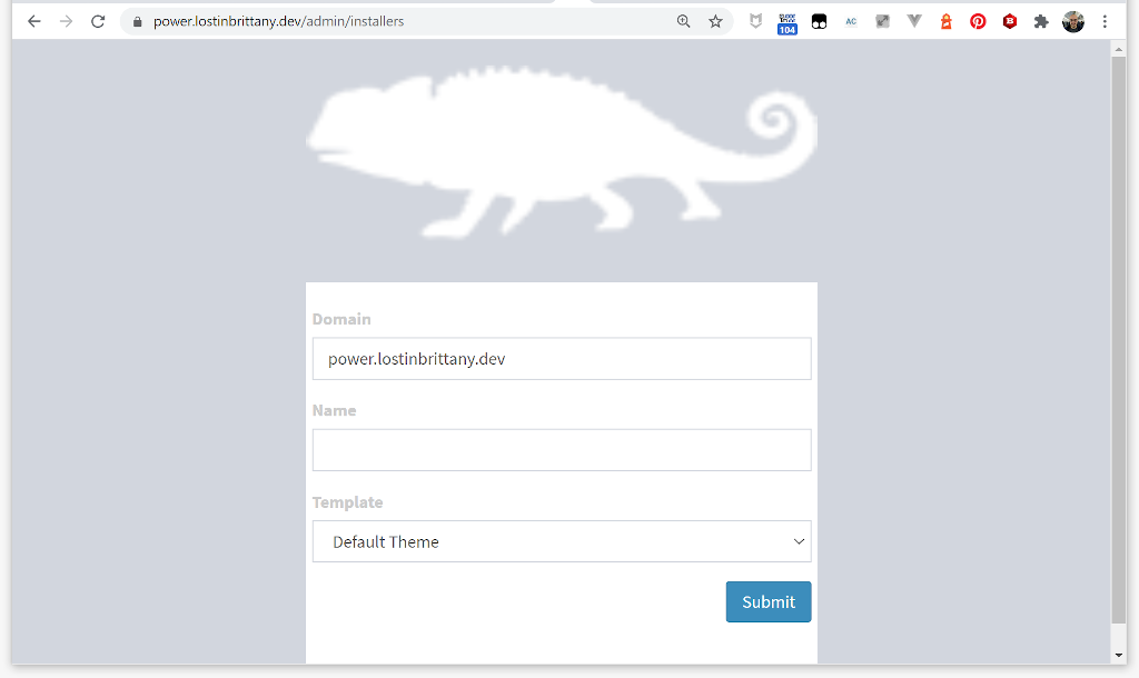

Then restart your instance and your Camaleon will be online.
Camaleon
