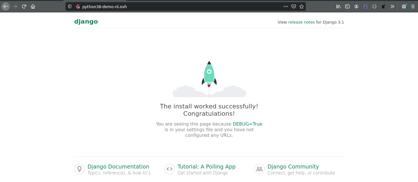

Django needs to declare the allowed hosts used for the website. It's configured in config/settings.py, for example:
ALLOWED_HOSTS = ['yourdomainname', 'www.yourdomainname', 'yourFTPuser.cluster022.hosting.ovh.net']
Then restart your instance and your Django will be online.
Django
