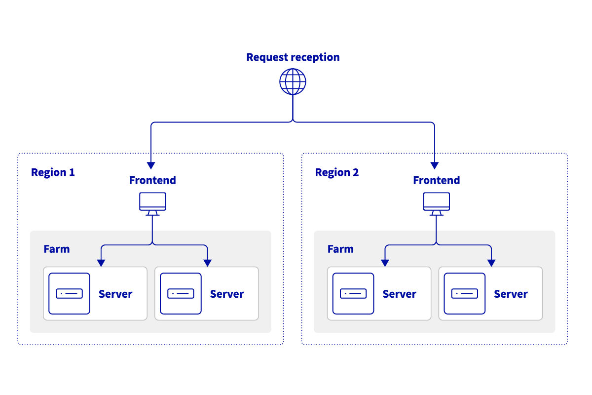

Multi-region configuration
Load balancing across multiple regions offers maximum disaster recovery against widespread regional outages and allows for worldwide entry points that significantly reduce latency by routing users to the nearest server. Most regions only have one availability zone, which means that working with several zones usually involves working with several regions.
By leveraging an Anycast network, the OVHcloud Load Balancer can redirect requests coming from a specific region to the geographically nearest backend servers.
To achieve this, you need to specify a frontend in each zone that uses a cluster in the same zone. This will allow you to declare backend servers in different clusters per zone and to control which backend servers are used in which zone.
Operation with several zones and several clusters Diagram representing a load balancer distributing traffic across two regions
For example, if you have backend servers in the Gravelines (GRA) and Beauharnois (BHS) regions, you can order a Load Balancer service in the GRA and BHS zones and configure:
  • A frontend in the GRA zone with a default cluster in the GRA zone which contains servers in the Gravelines datacenter.
  • A frontend in the BHS zone with a default cluster in the BHS zone that contains servers in the Beauharnois datacenter.

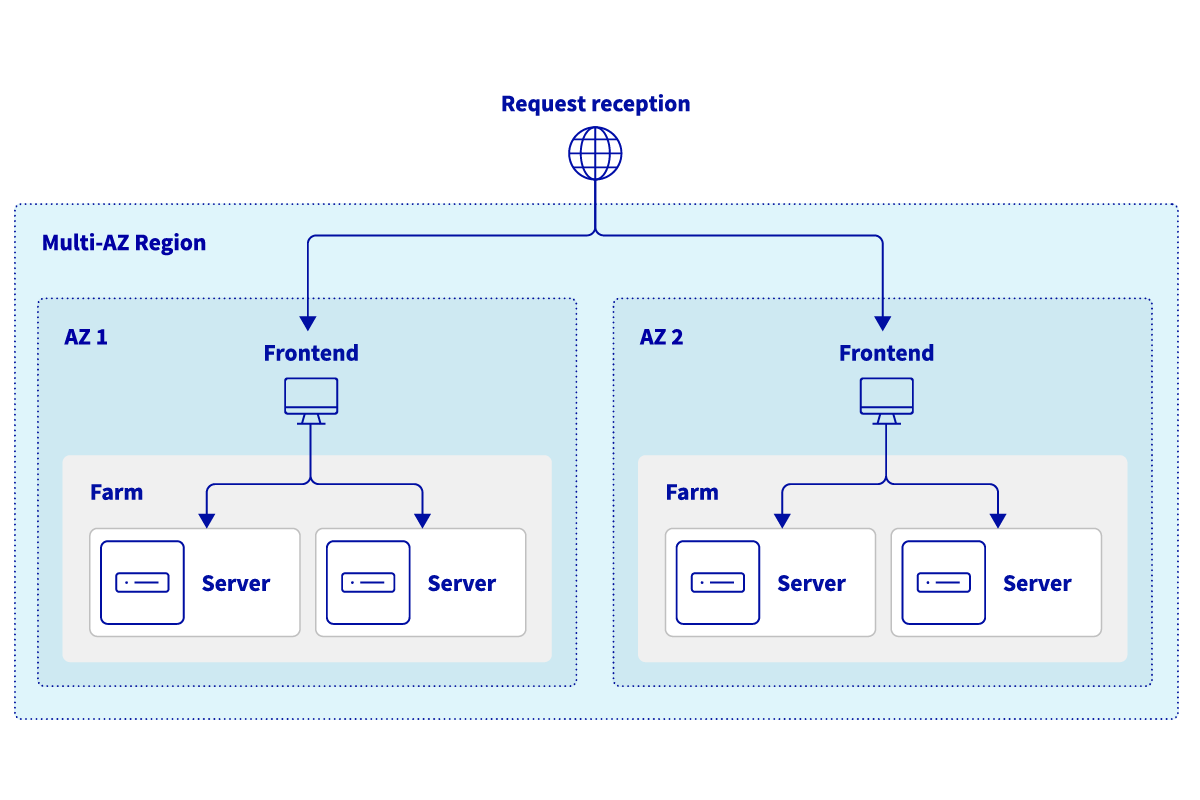

Multi-AZ regions
OVHcloud is currently rolling out its strategic plan for multi-Availability Zone (multi-AZ) regions, beginning with the launch of Paris 3-AZ in April 2024 and Milan 3-AZ in November 2025.
Load balancing across several Availability Zones (AZs) within the same region, in contrast to a multi-region configuration, ensures high availability, high performance and fault tolerance against local outages, using low-latency connections and Anycast to distribute traffic in the most efficient way.
Difference between multi-region and multi-AZ deployments Diagram representing a load balancer distributing traffic across the zones of a single multi-AZ region

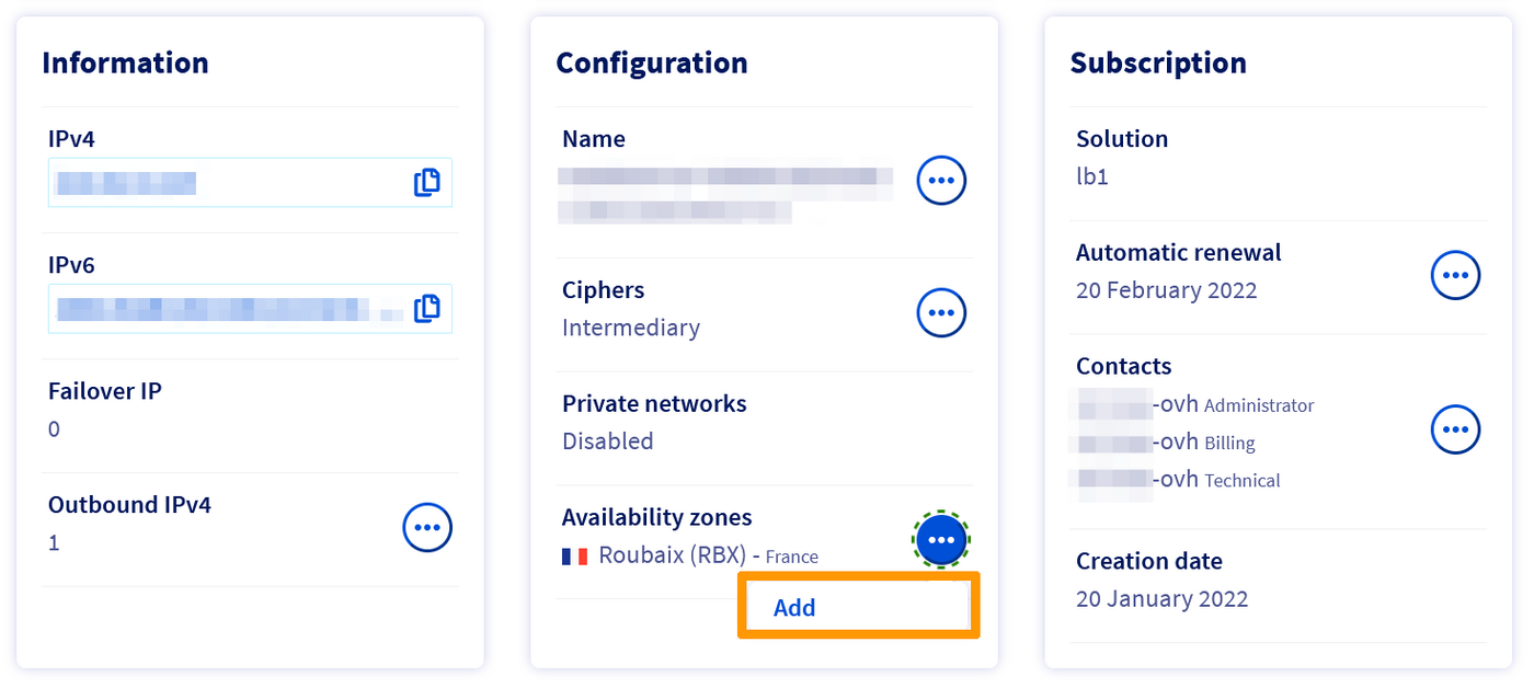

You can order an additional zone from the OVHcloud Control Panel. In the Network section, under Network services, click on Load Balancer.
Select your Load Balancer, then in the Home tab and the Configuration menu, click Add in the "Availability zones" section.
Add a Load Balancer zone from the manager

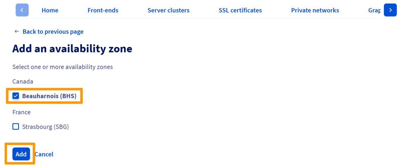

Then select the zone(s) you wish to order and click Add.

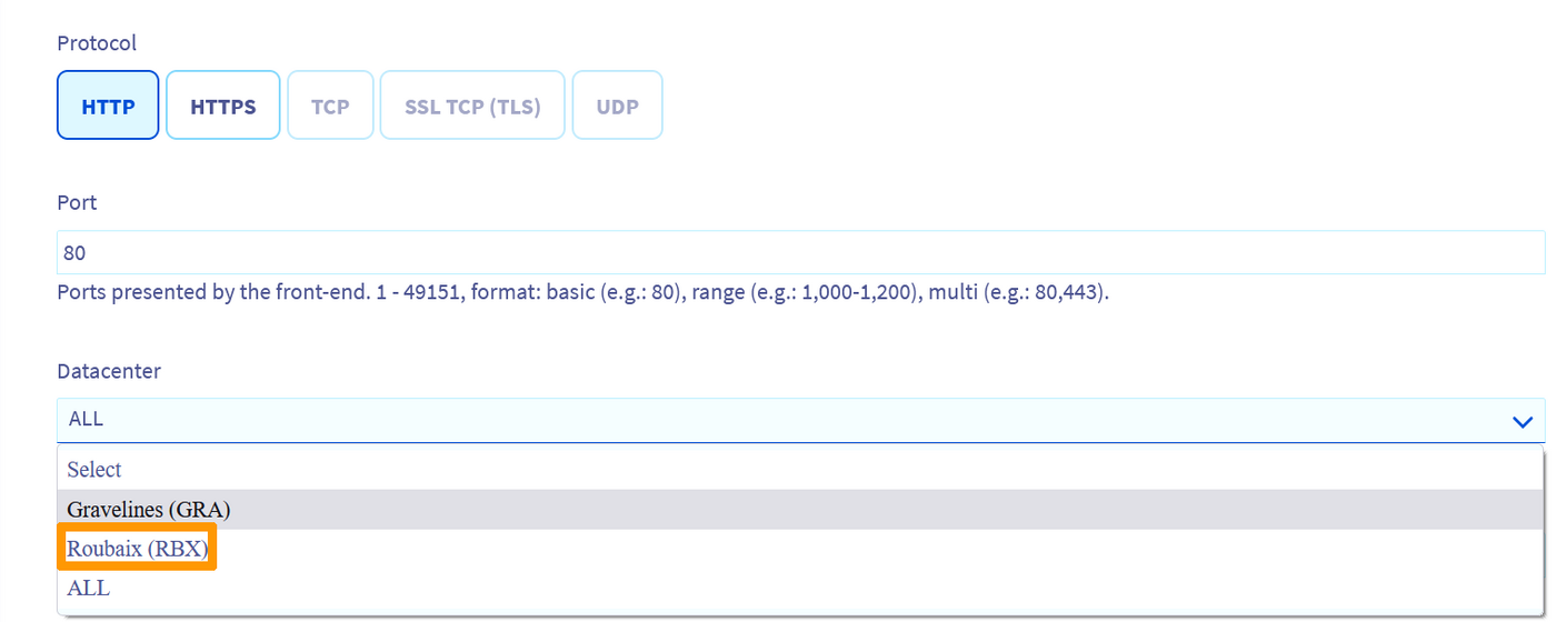

In the Datacenter field, choose the zone you wish to associate with your frontend.
If you want to use multiple zones, you can choose the special ALL zone. This special zone will allow you to deploy the same configuration on all zones subscribed to your Load Balancer service, which spares you having to duplicate the configuration for all zones.
Zone selection
Once the frontend is configured, click Add or Modify depending on whether you are configuring a new frontend or an existing one.

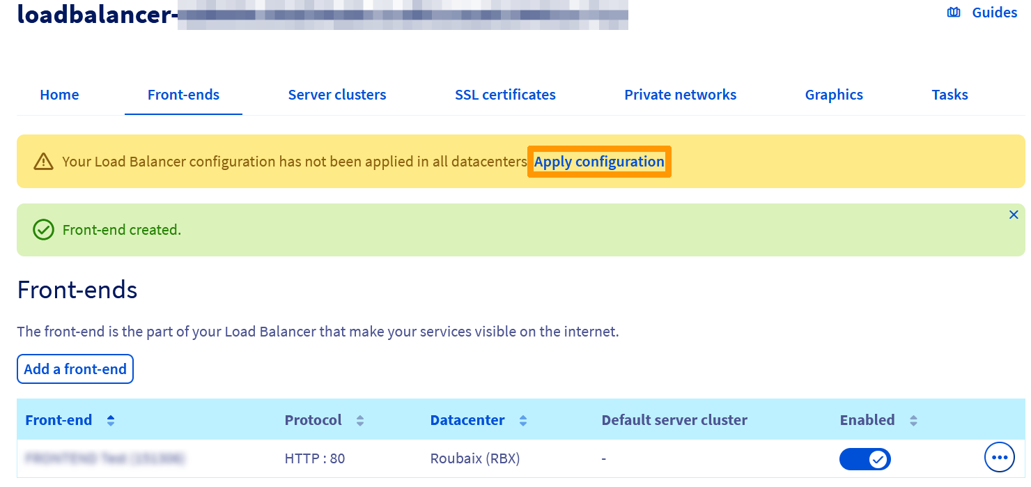

Don't forget to deploy the configuration. To do this, click Apply configuration in the reminder banner stating that the configuration is not applied.
Applying a Load Balancer Configuration
