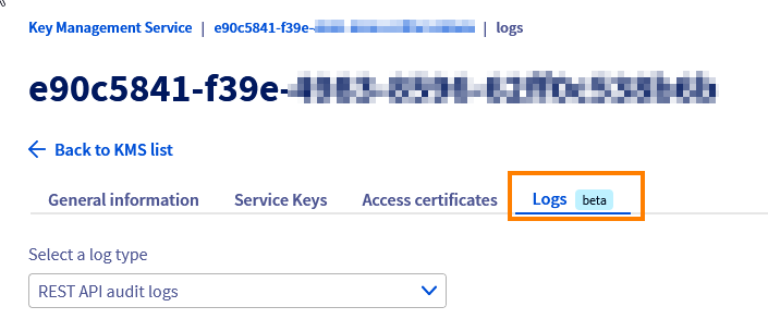

KMS logs are available from each KMS Logs tab.
Logs tab
This tab displays all KMS logsin real time. A selector allows to switch display between the two types of logs:
  • REST API audit logs.
  • KMIP audit logs.

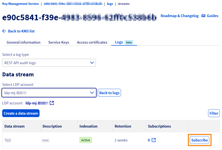

Logs access through LDP
From the Logs tab, you can subscribe to an LDP data stream. Once the subscription is enabled, all the logs will be pushed to Logs Data Platform to archive generated logs and perform advanced searches, create alerts and visualisations.
LDP Subscription
For more information, please refer to our guide "Quick start for Logs Data Platform".
