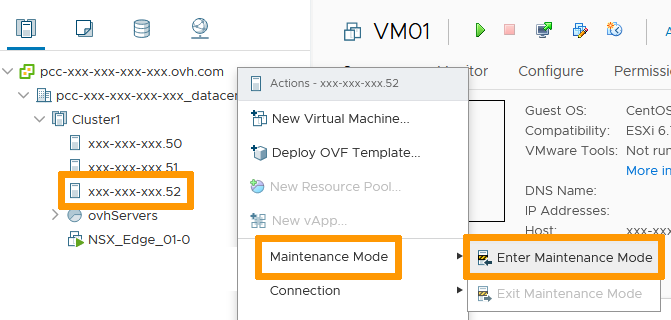

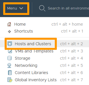

With that in mind, in the vSphere interface menu, go to the Hosts and Clusters dashboard.
Maintenance
On the left side, find your host and right-click on it.
In the Maintenance Mode section, select Enter Maintenance Mode.

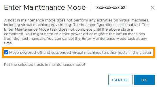

Make sure the box in the following window is checked and click OK.

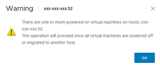

Assuming DRS is implemented, any live VM will be moved.
INFO
If you customized your environment, you may have to manually move live VMs from your host before putting it in Maintenance Mode.
You may see the following warning:

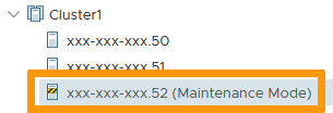

Your host is now showing in maintenance mode.
Maintenance

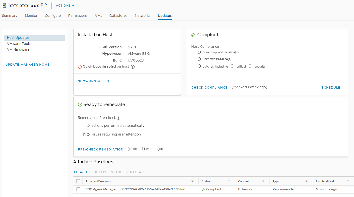

Select your host and go to the Update tab.
You can see a summary of what is set and its compliance.

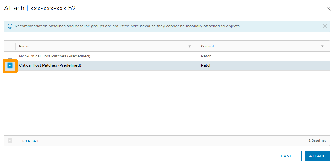

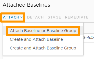

In the Attached Baselines section, click on Attach then Attach Baseline or Baseline Group.
Update
There are predefined Baselines which are the recommended patching level for your hosts depending on criticality of the updates.
INFO
We'll be using the Critical Patches in this example but you can either use or create your own baselines. You can also apply several baselines to cover different scopes for a same host.
Select the required baseline and click Attach.

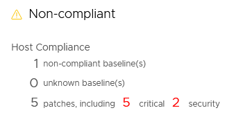

Now, the compliance summary may look very different than it used to.
Update

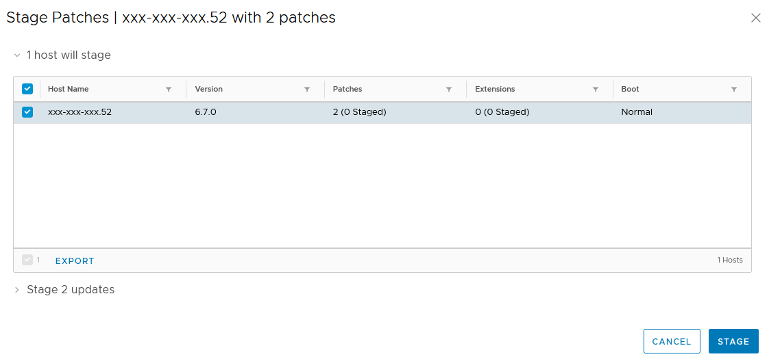

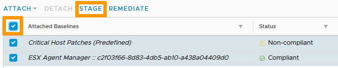

Back in the Attached Baselines section, check the box to select all assigned baselines and click on Stage.
Update
Select the host and click on Stage again.
Update
The staging process starts and will last for a while.

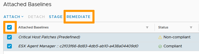

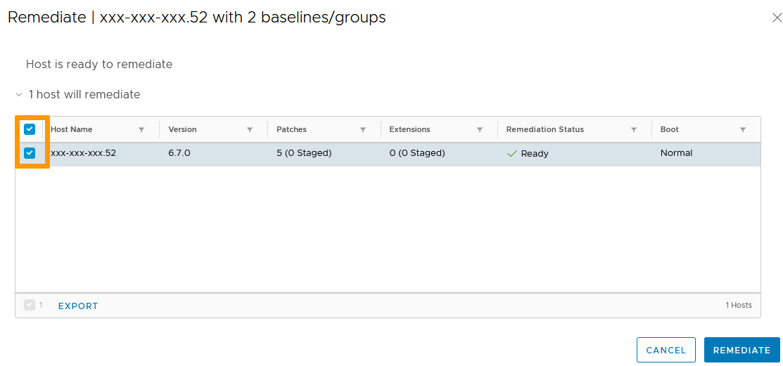

In the Attached Baselines section still, check the box to select all assigned baselines and click on Remediate.
Update
Select the host and click on Remediate again.
Update

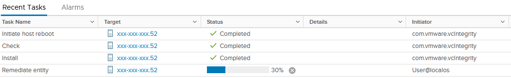

The updating process starts and will last for a while. Your host will restart if needed.
Update

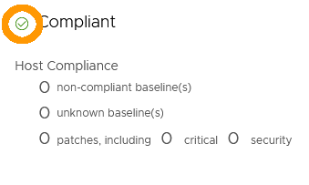

Once the process has gone through, the compliance check will happen again (you can force it by clicking on the check compliance link) and you will see a green checkmark on the Compliance level.
Update
Your host is now fully up-to-date.
