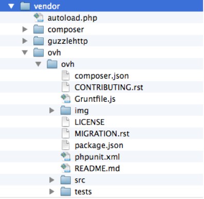

In your project, you will retrieve the directory ./vendor/ovh/ovh/, as well as the file autoload.php, which is used to manage all dependencies and imports.
your project with Composer

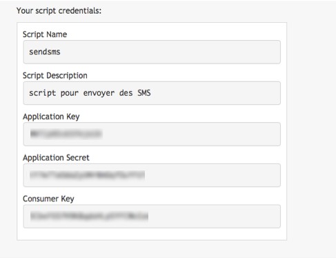

You can then retrieve the credentials for your script:
  • Application Key (identifies your application)
  • Application Secret (authenticates your application)
  • Consumer Key (authorises the application to access the methods chosen)
retrieving tokens
