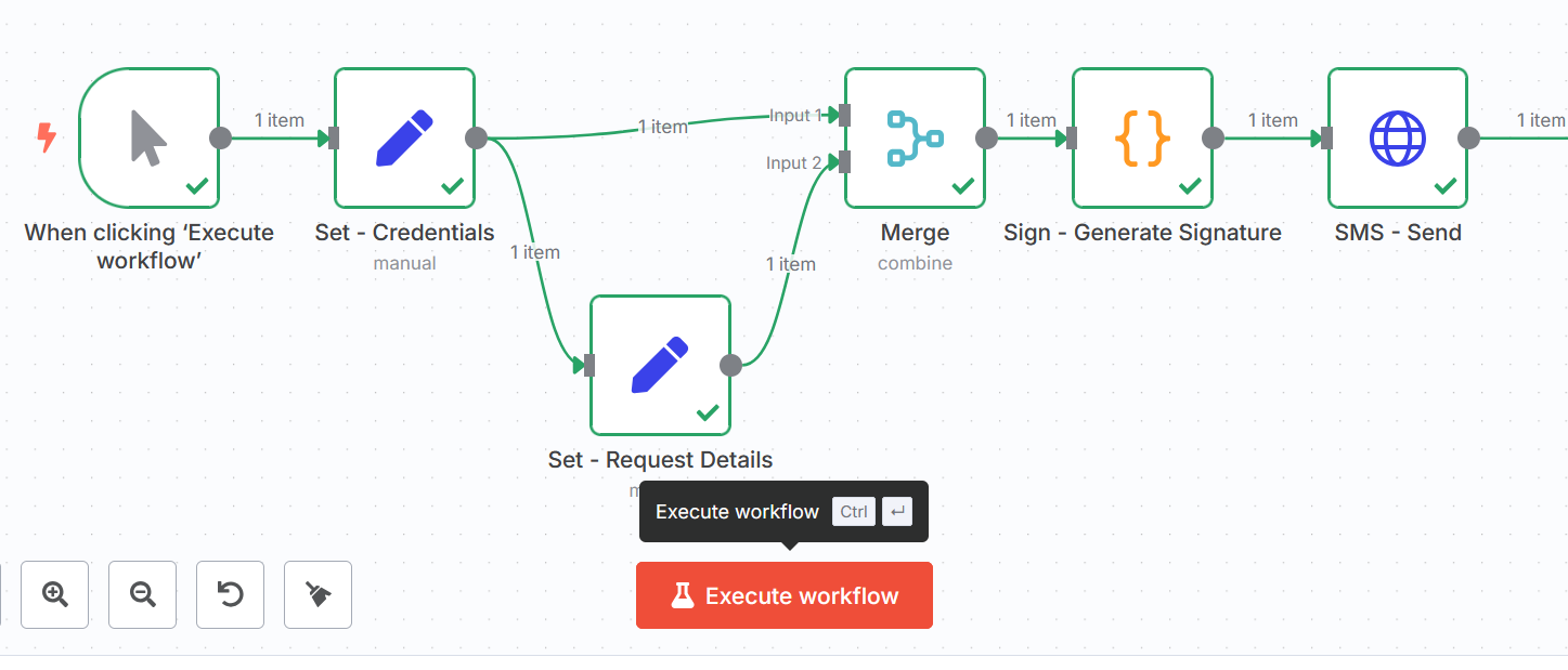

Connect the nodes in this order:
N8N SMS
The Merge node receives the outputs from the two Set - Credentials and Set - Request Details nodes, then feeds into Sign - Generate Signature, which feeds into SMS - Send.
