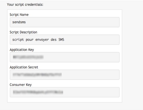

You can then retrieve the credentials for your script:
  • Application Key (identifies your application)
  • Application Secret (authenticates your application)
  • Consumer Key (authorises the application to access the methods chosen)
retrieving tokens
