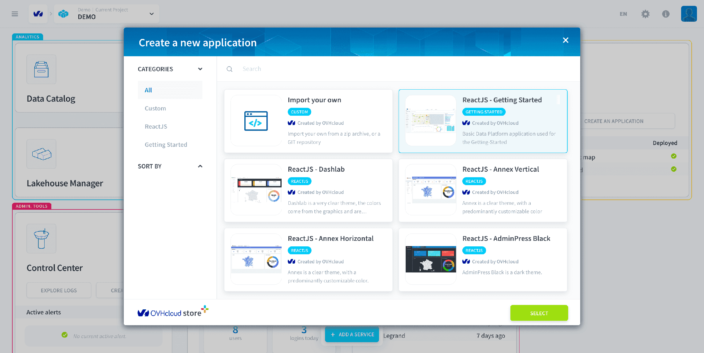

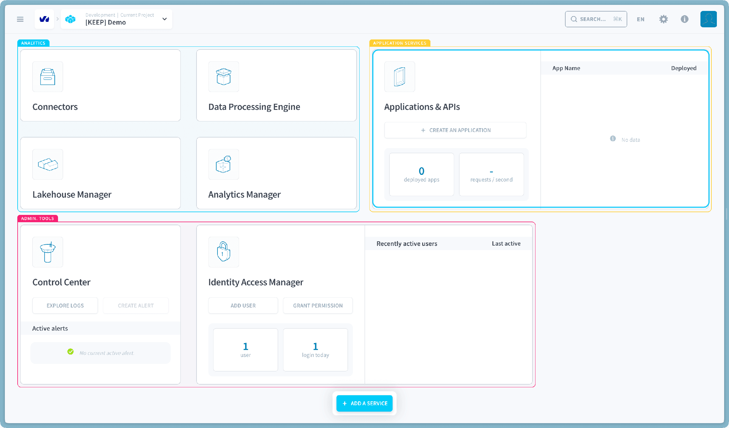

Initiate your application from Application Services by clicking Create an application.
Select the template ReactJS - Getting Started from the store. This template produces a complete BI dashboard.

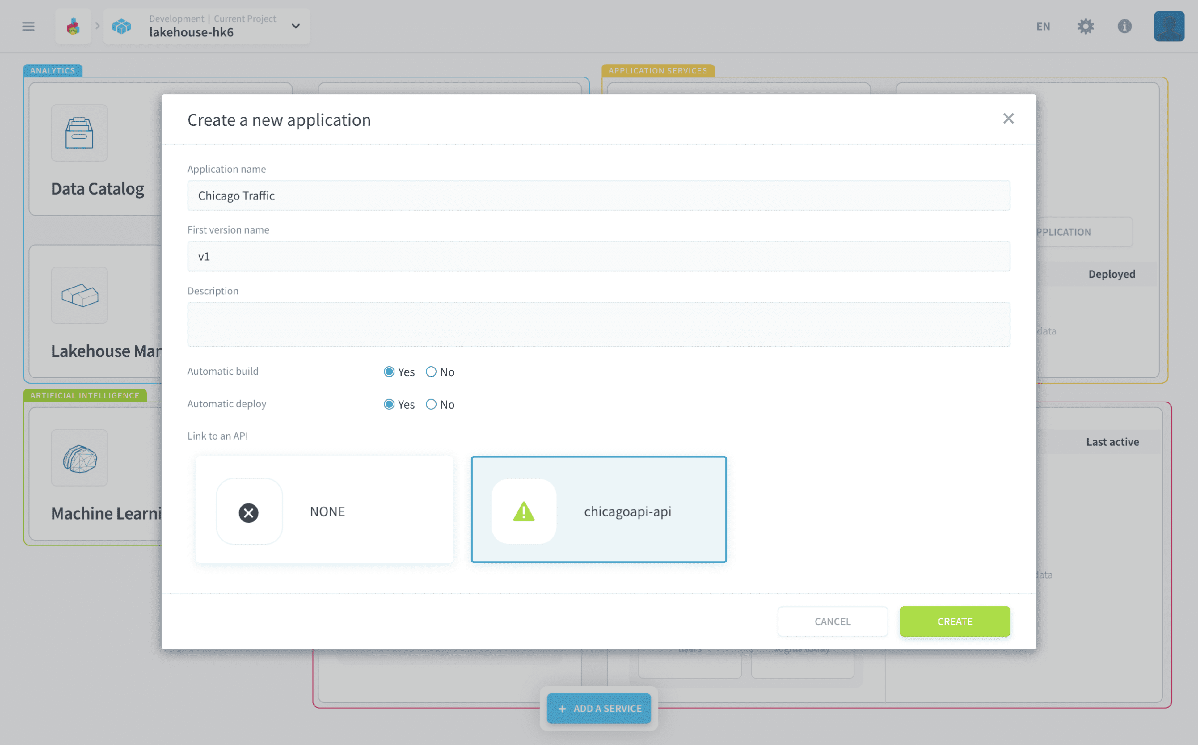

Fill in the different fields as shown in the screenshot below and press Confirm.
Click on Confirm, your app will automatically build and deploy. The process should take a couple of minutes, in the meantime feel free to read through the pre-requisites below.

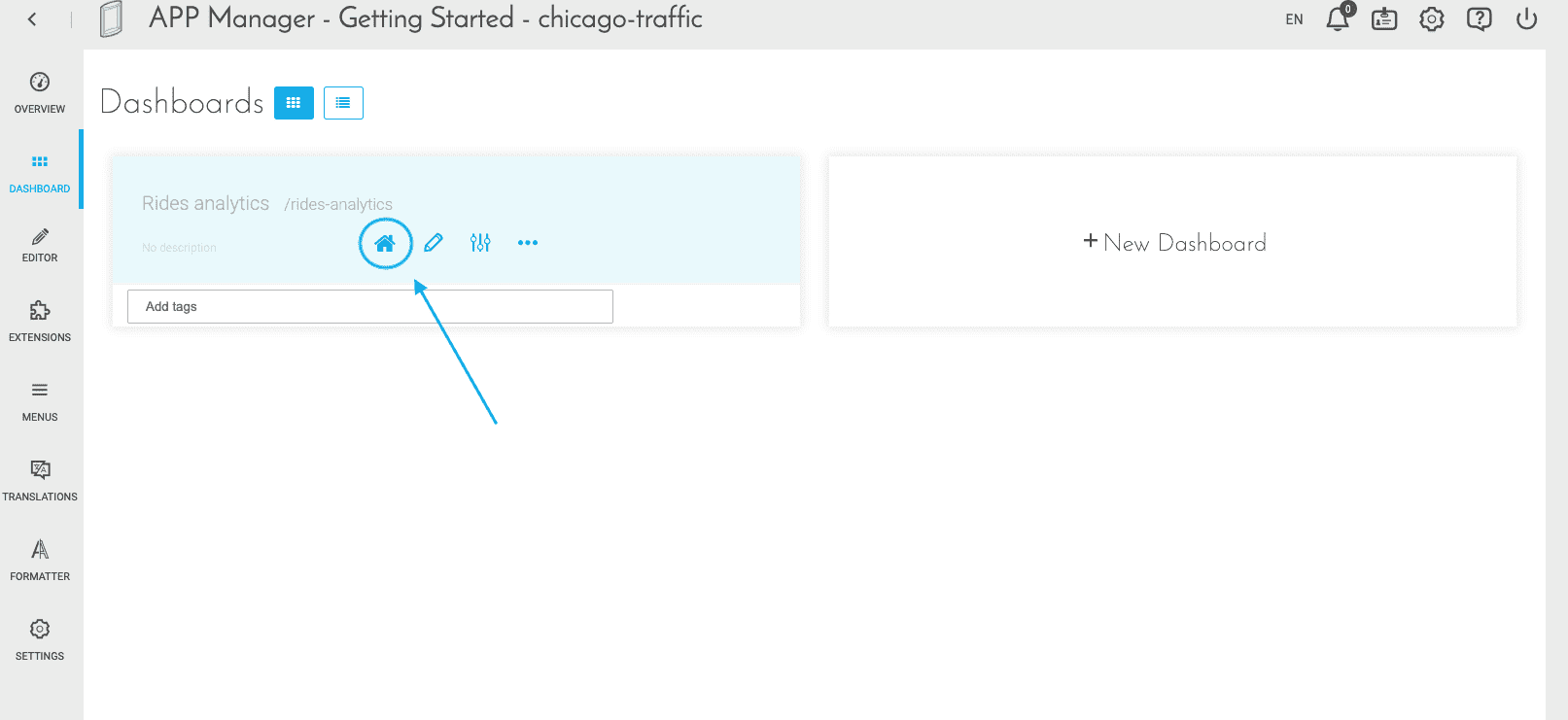

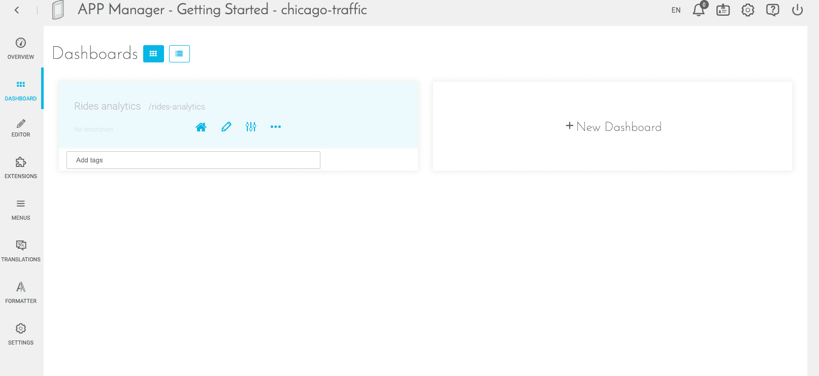

Click on the Dashboard menu. In an app, dashboards are its pages.
A first dashboard, Rides Analytics, has been added by default when you selected the template at the beginning. It comes with styles and logos!
Click on the house icon to set it as the default landing page of your app.

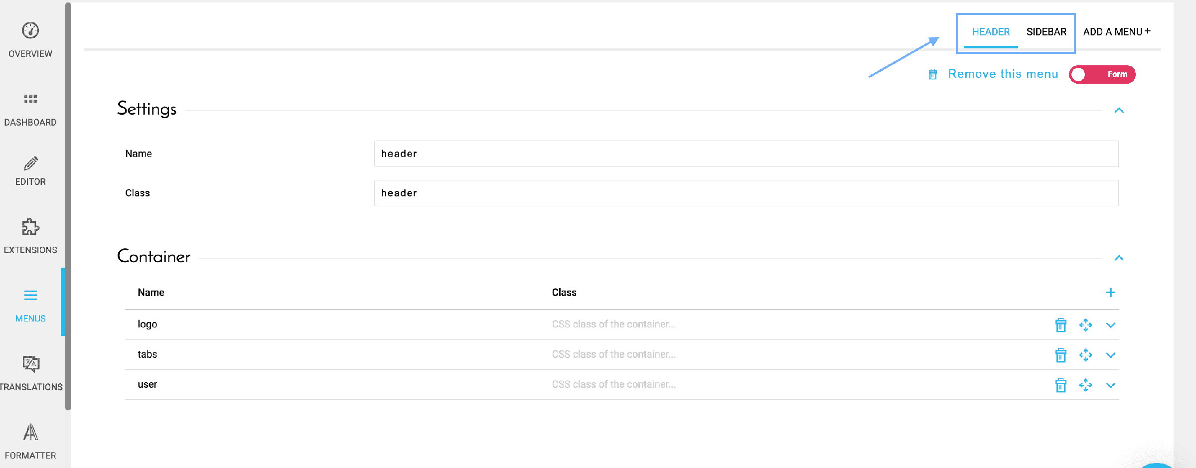

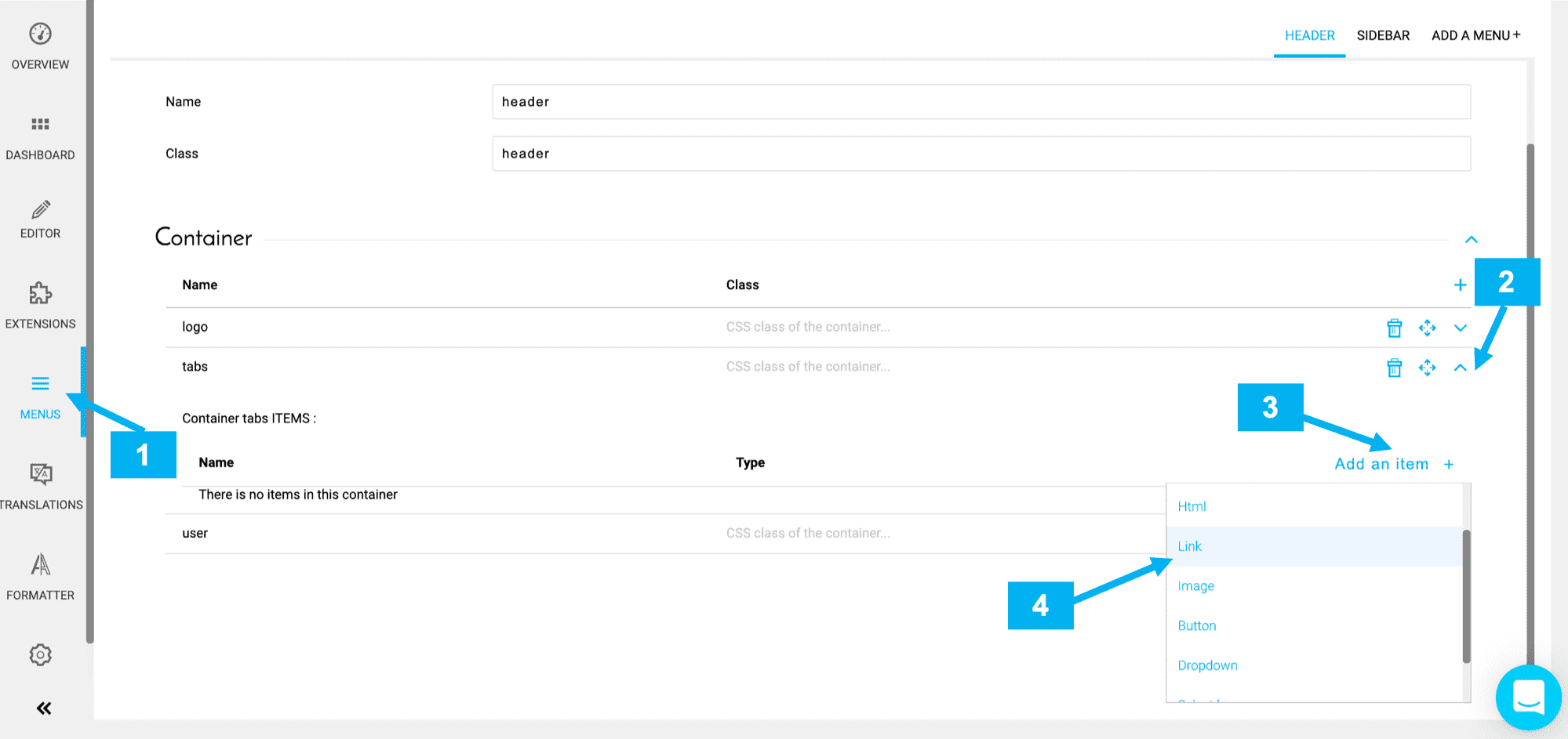

Head to the Menus menu. It is the page where you can define items such as header menus and filters for your whole app. It has already been pre-populated with several pages and items due to the template you used to initiate the app.
You should land on the header page. This means every item you add here will be embedded in the header of your app (i.e the upper part). You can switch to the sidebar page (to embed items in the left sidebar of your app) at the top right-hand corner.

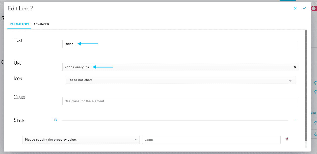

Switch back to the header page. Expand tabs to see the container's items. Click on Add an item to add a tab in your header. Select link.
Fill in the fields as shown below. You can also define a logo icon for your app header!

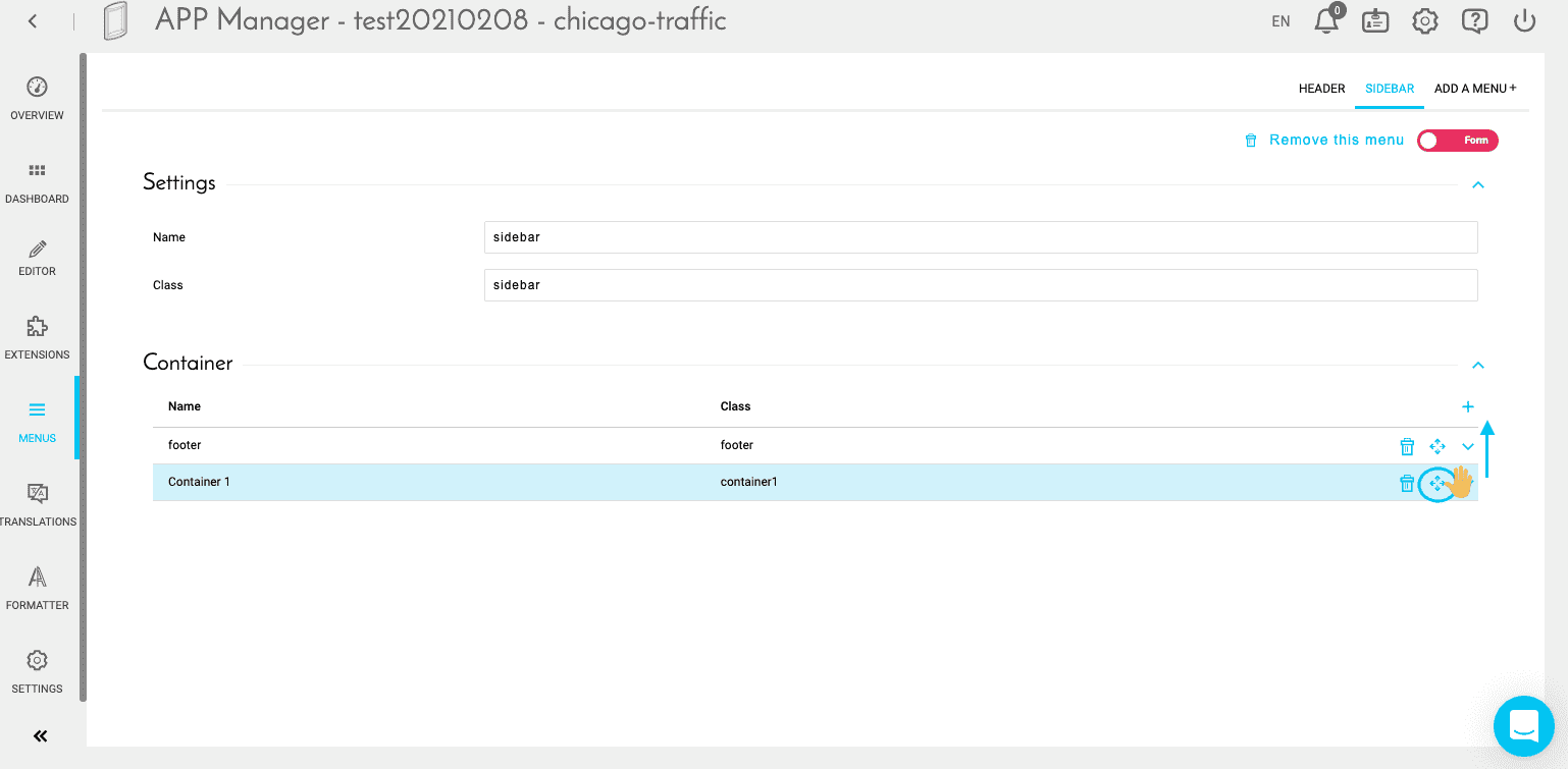

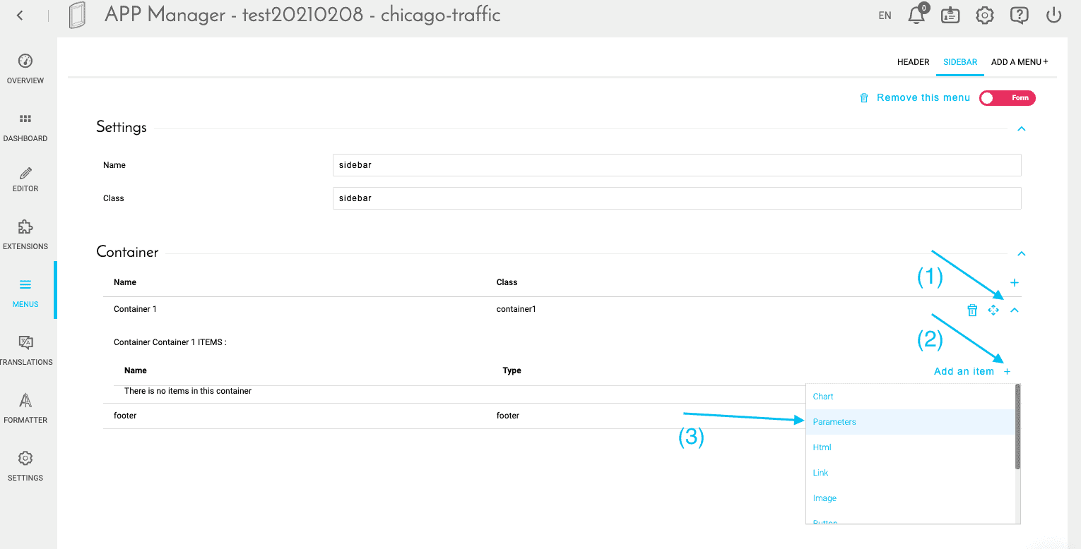

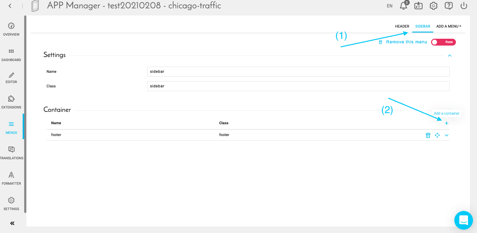

Click on Sidebar on the top right-hand corner and create a container.
If you are unfamiliar with containers, think of them as folders for items.
Drag the new container on top of the footer (which has to be at the bottom).

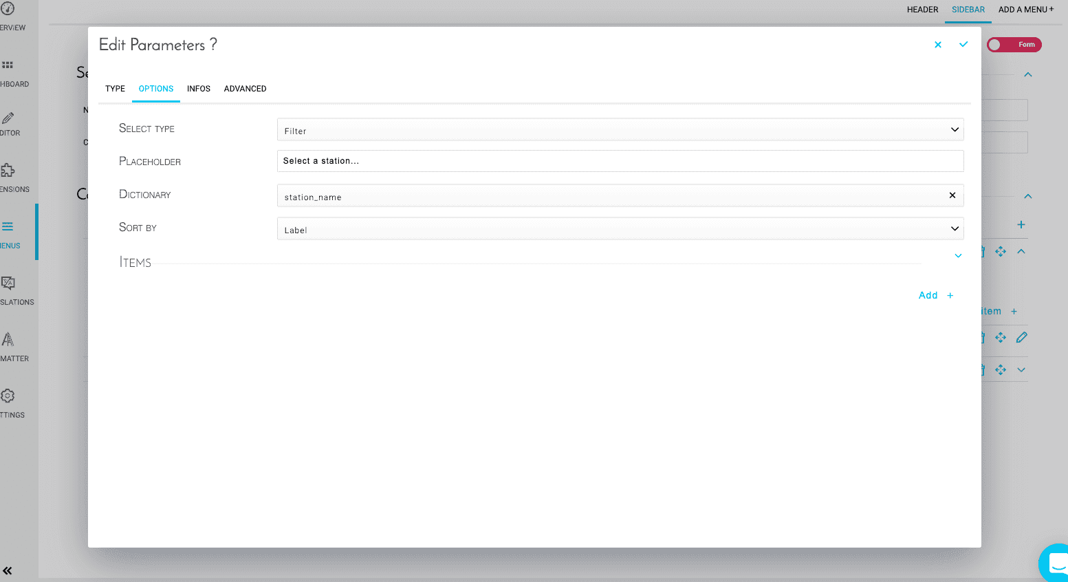

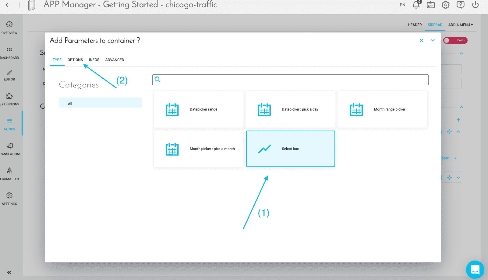

Open the container then add an item: select Parameters.
Pick the Select box one, then head to the options of the new parameter.
Fill in the options as shown in the screenshot below.
In the Infos tab, give it the following name: select_stations, and press Confirm.

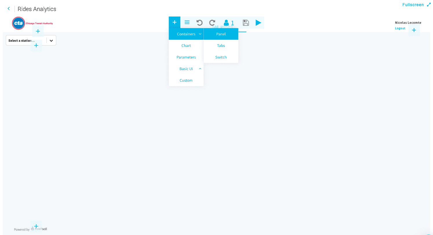

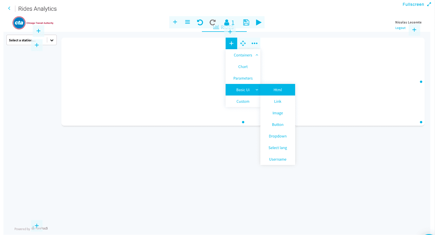

Step 1. Create a panel
Click on the ➕ icon to create a panel (Containers > Panel).
Once it's created, you can resize it so it spans across the screen.

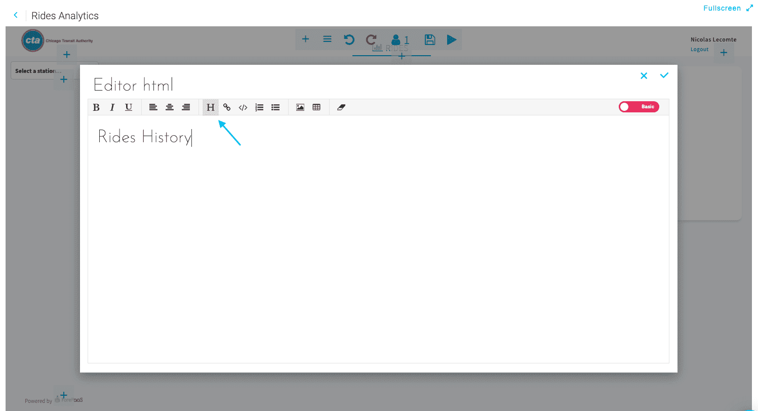

Step 2. Give a title to your chart
Inside your new panel, click on the ➕icon and select Basic UI > HTML.
Name it Rides history and apply the H1 style by clicking on the H button.

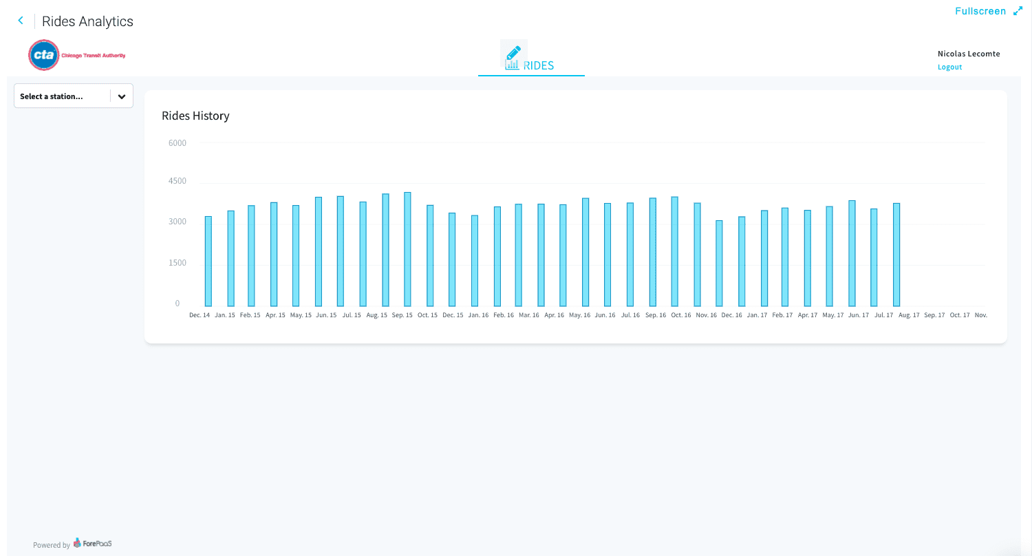

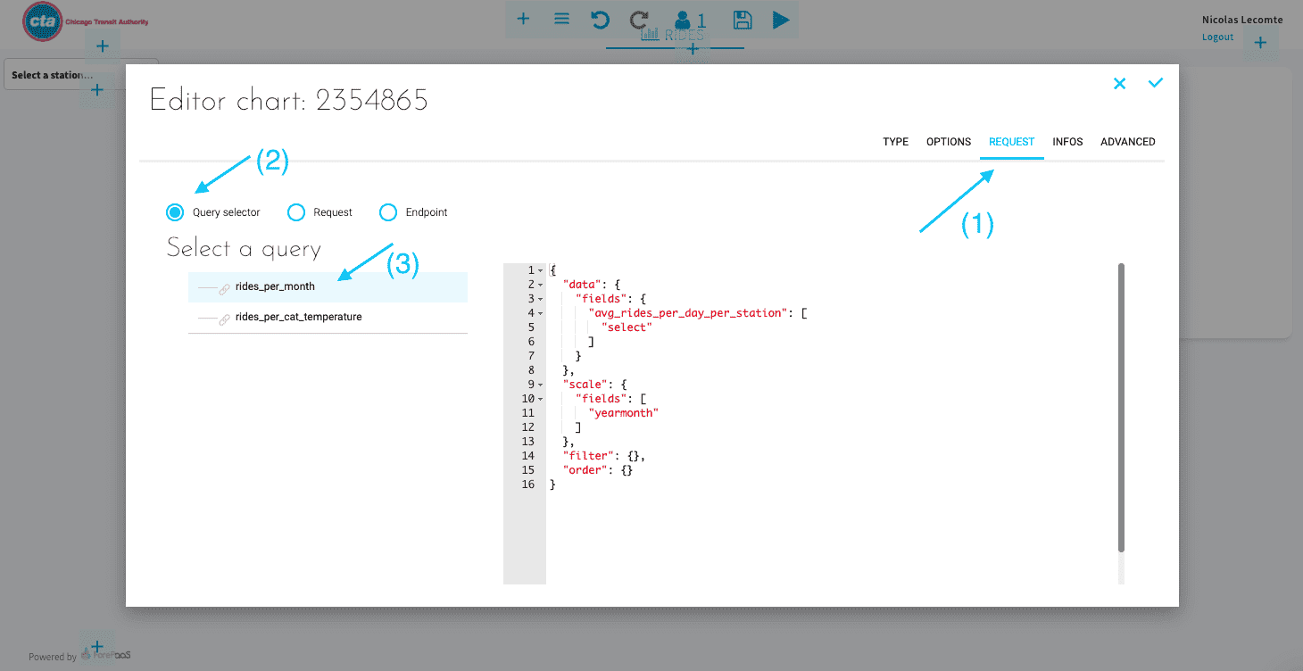

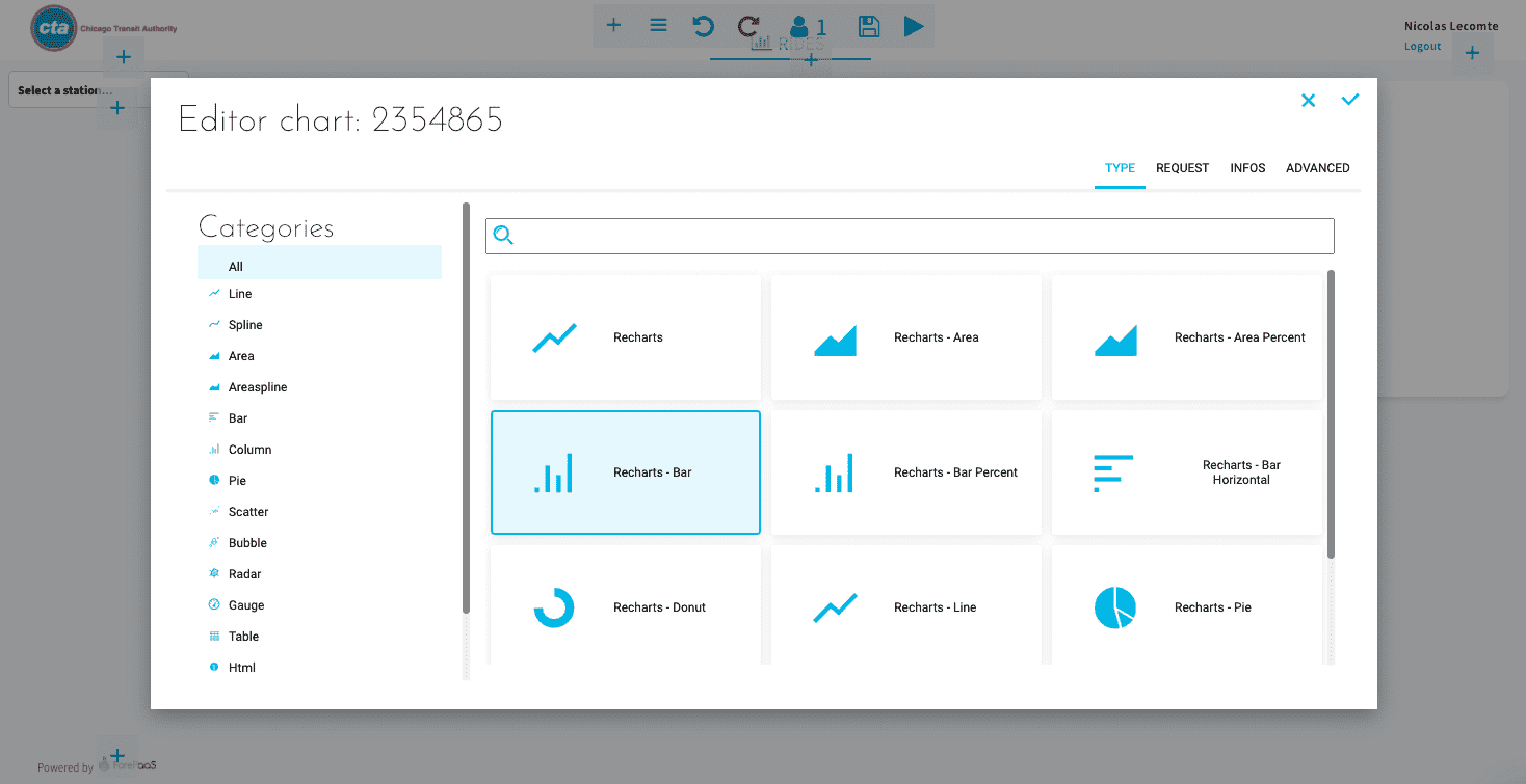

Inside your panel, click on the ➕icon and select Chart. Pick the Recharts - Bar type.
Click on Request, and select Query selector to pick the rides_per_month query you've created in the Analytics Manager.

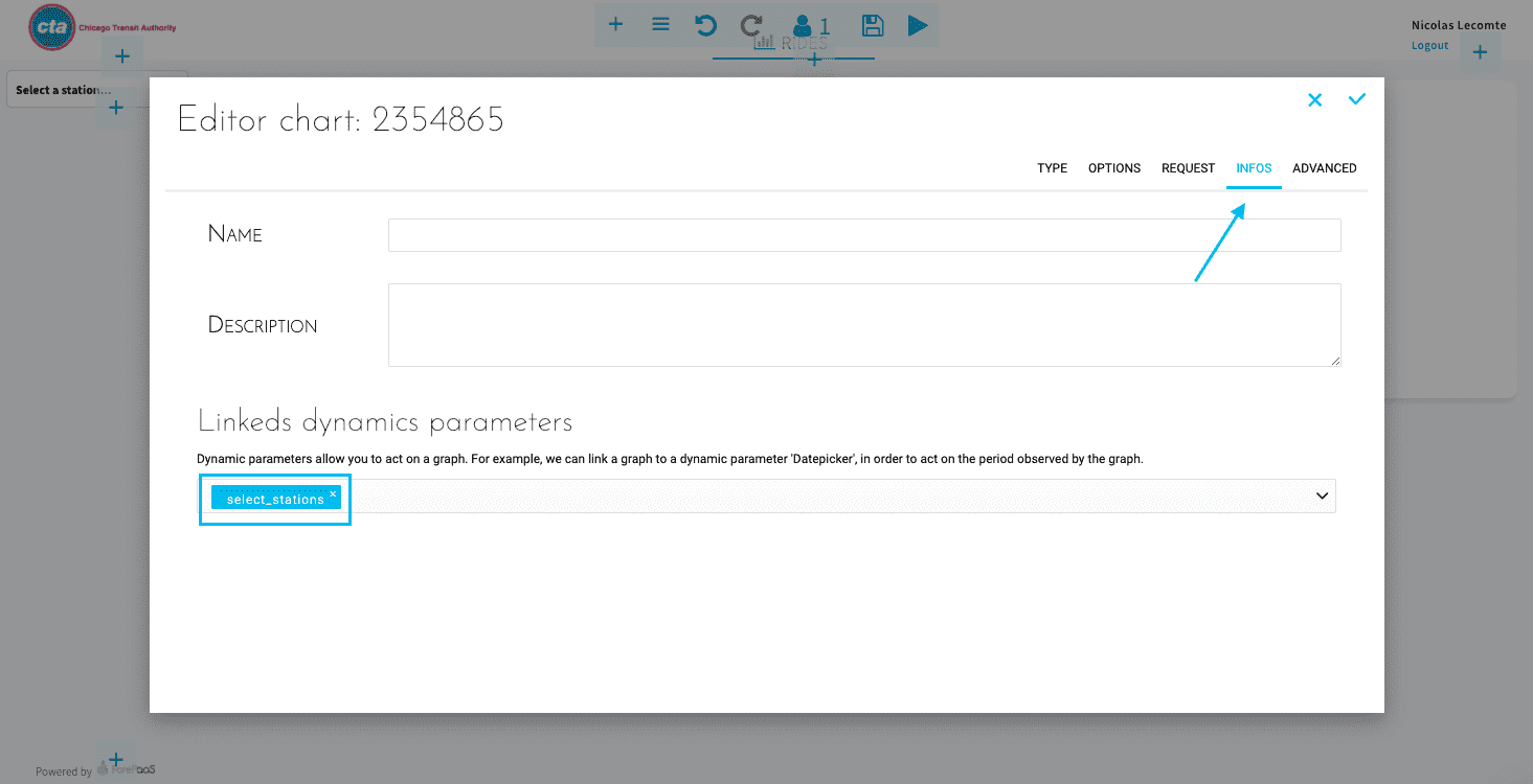

To complete the setup, you have to connect this chart with the filter we've already created. Go to the Infos tab, in the Linked dynamic parameters section, and add select_stations.
You can now test if your filter is properly working. Enter the read-only mode by clicking on the Play icon, and modify dates or holiday type to see how your data is changing. Your first chart is done!

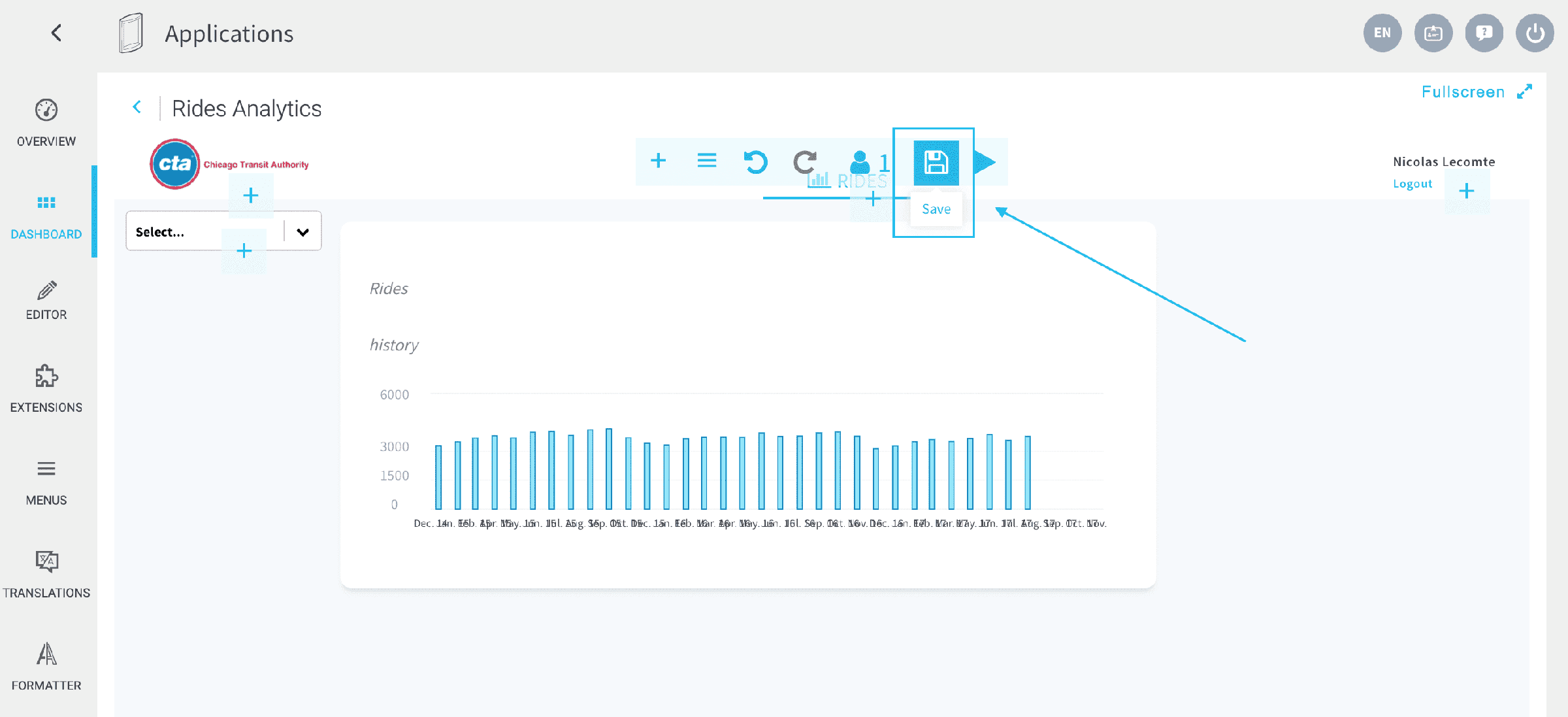

First, don't forget to Save your dashboard to make sure all your edits are consistently saved ( icon in the top middle bar).

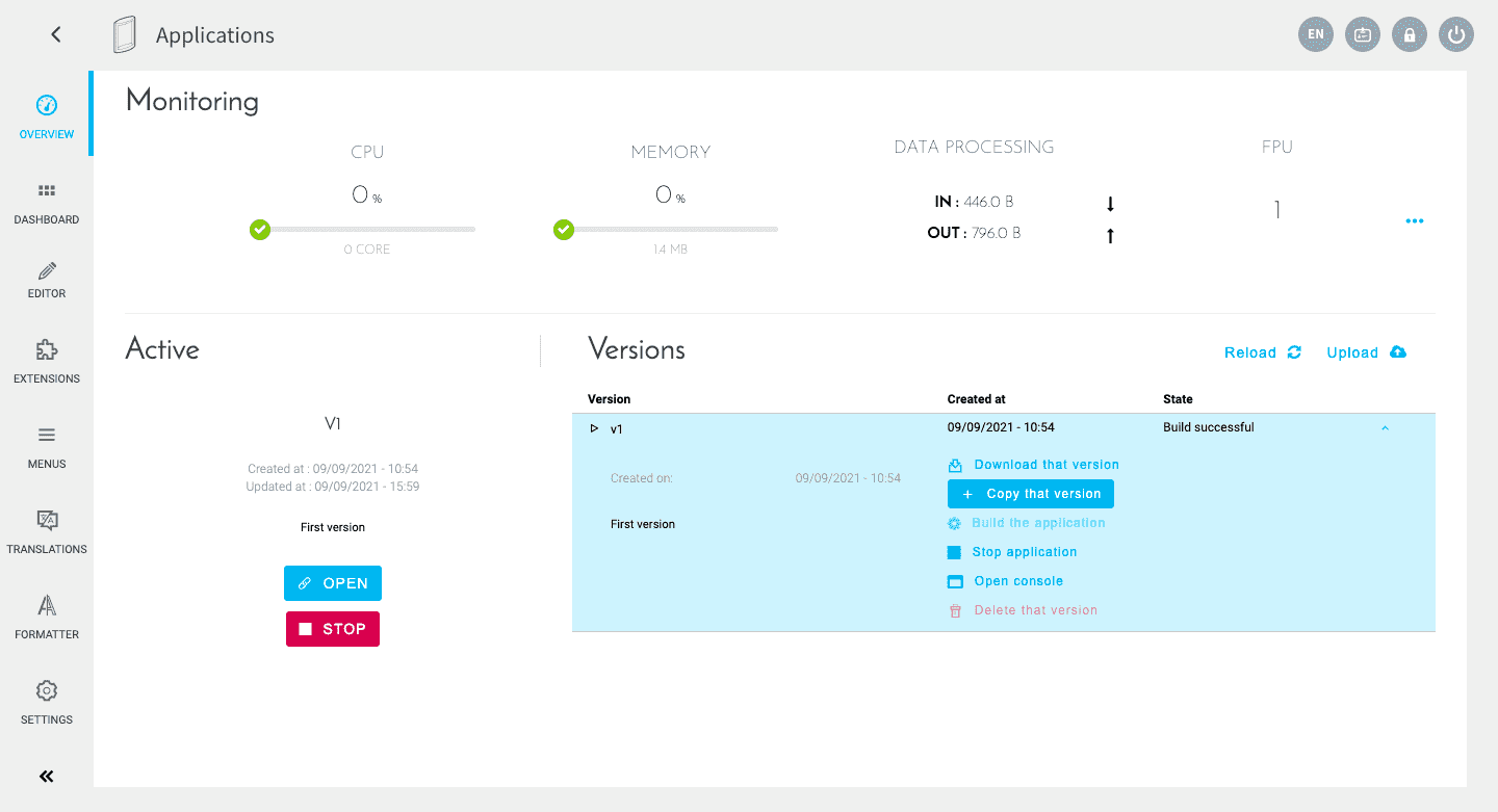

Then go back to the Overview tab of the Application Manager.

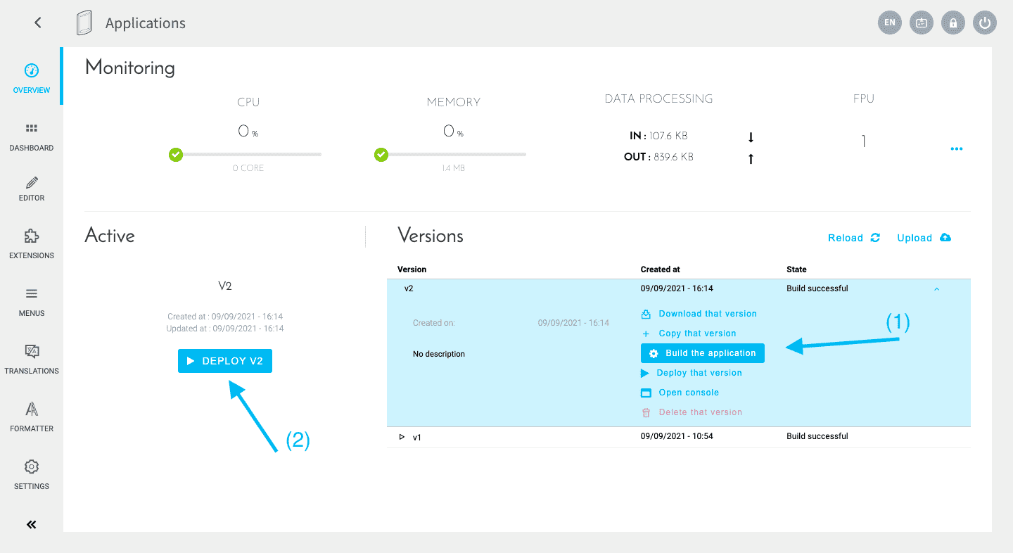

Changes brought to your application since you first created it must be builded in order to be visible by your end-users. You could stop the currently deployed version to build those changes, but the Platform also allows you to do it without interruption of service.

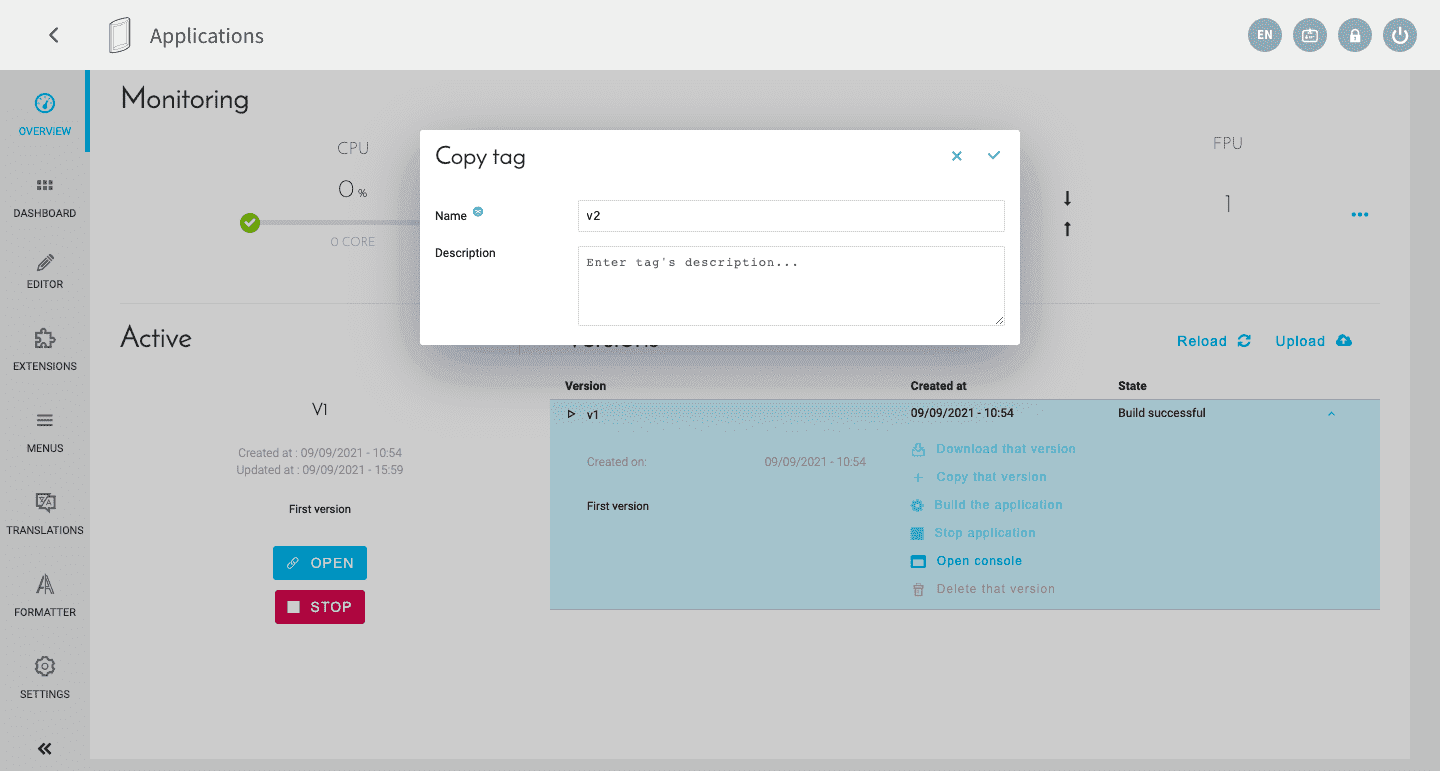

First, Copy the currently deployed
version of the application.
Then you need to name the new version (v2 in the screenshot below).

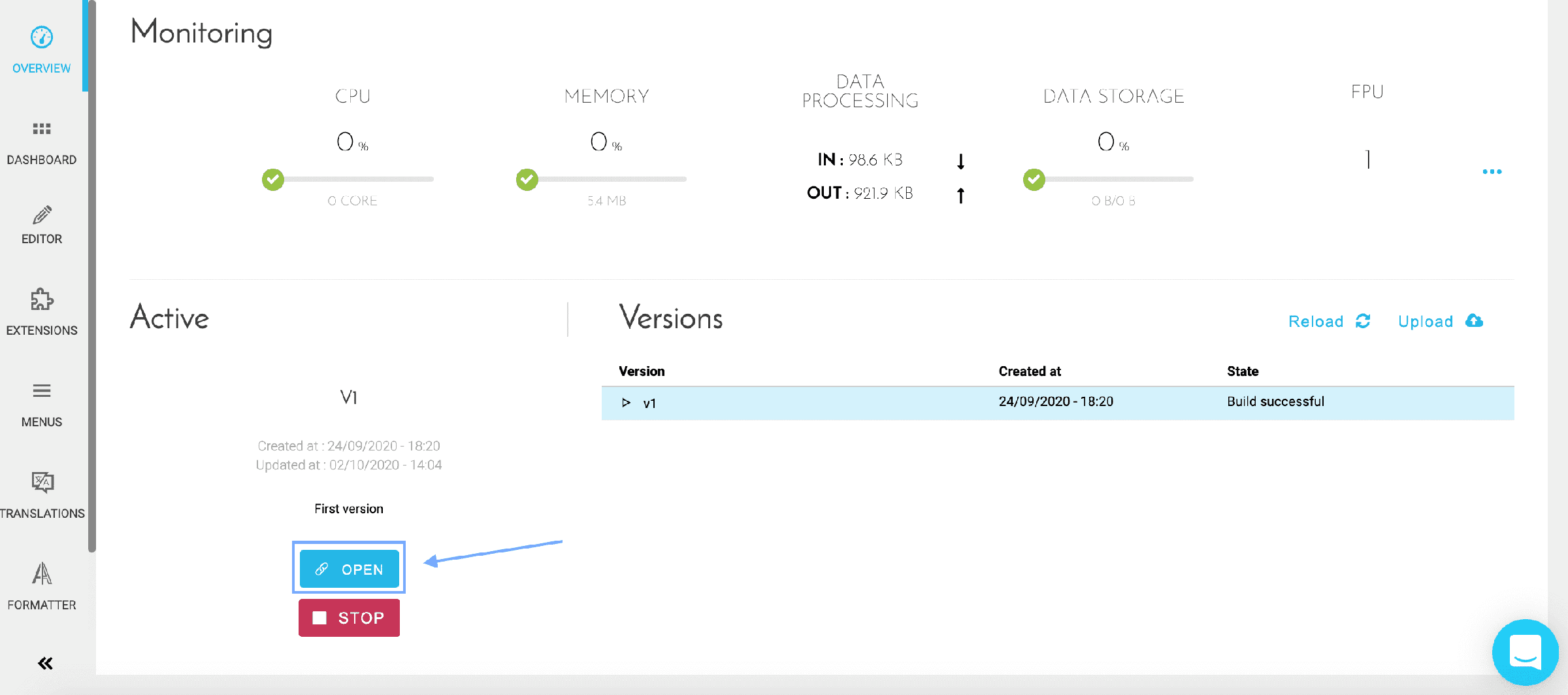

Now, click on Build, and then Deploy.
The build process usually takes a couple of minutes. If you're curious about what is going on or if the build fails, open the log console by expanding the version panel and inspect the logs. Feel free to send logs to our support team if you're not sure how to troubleshoot it yourself!
Your app is live and can now be accessed online! The link can be obtained in the Overview tab by clicking on Open.
