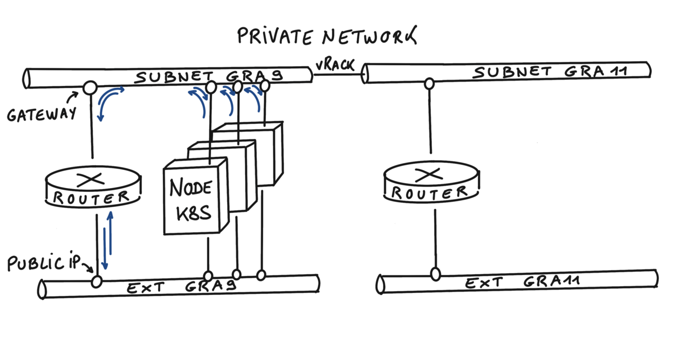

At the end of this tutorial you should have the following flow:
Schema vrack gateway

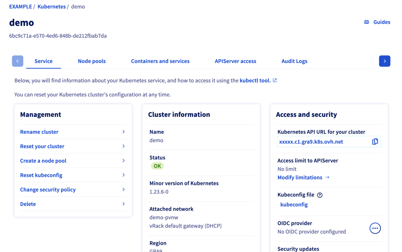

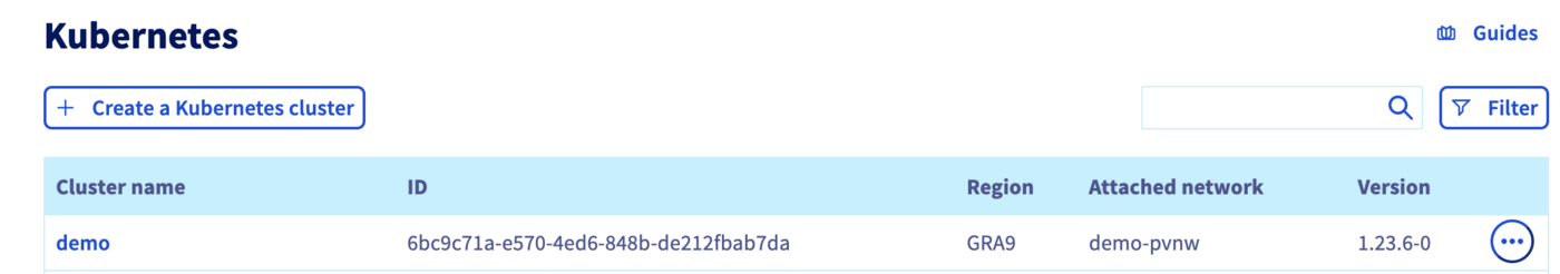

Now wait until your OVHcloud Managed Kubernetes cluster is READY.
For that, you can check its status in the OVHcloud Control Panel:
Access the administration UI for your OVHcloud Managed Kubernetes clusters by clicking on Managed Kubernetes Service in the left-hand menu:
Create a cluster
As you can see, your new cluster is attached to demo-pvnw network.
And now click in your demo created Kubernetes cluster in order to see its status:
Create a cluster
When your cluster's status is OK, you can go to the next section.
