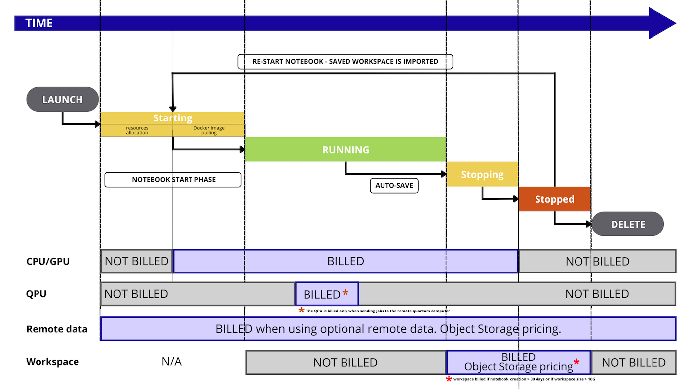

Here is a detailed graph that illustrates every step that is billed or not during the Quantum Notebooks workflow:
billing
Compute resources details
During the notebook creation, you can select compute resources, known as CPUs or GPUs. Their official pricing is available in the OVHcloud Control Panel or on the OVHcloud Public Cloud website.
When your program needs to access to the remote QPU, QPU time is charged by the second. You will only be charged for your QPU usage time.
Rates for compute are mentioned per hour to facilitate reading of the prices, but the billing granularity remains per minute.
As stated above and shown in the image above, you pay for these resources as long as you consume them. This happens when the image of your notebook is pulled, during the STARTING phase, but also during RUNNING and STOPPING phases, until you reach the STOPPED phase.

Workspace storage
By default, your notebook will be mounted in a remote Object Storage container on the /workspace location. This will be your default folder when you access your notebook.
You can store your data there.
The first 10GB are free for 30 consecutive days once your notebook is stopped, then you pay at the price of OVHcloud Object Storage.
Ephemeral local storage
Each compute resource (CPU or GPU) comes with local storage, that we can consider ephemeral since this storage space is not saved when you stop or delete your notebook.
The sizing depends on the selected amount of compute resources. Check the details on the OVHcloud Public Cloud website.
This concerns locations outside your /workspace, as well as outside any other remote Object Storage containers you may have mounted on your notebook.
This storage is not billed as it is directly linked to the compute resource(s) you have chosen.
