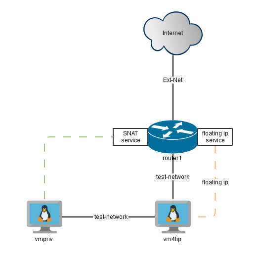

Target configuration architecture
diagram
The goal of this exercise is to have a VM (vmpriv) with only a private network (test-network), and to configure our deployment in such a way that vmpriv has external access to the Internet.
To do so, we need to configure the private network (test-network) with a subnet (test-subnet), and create a router (router1) for the SNAT service.
To perform the test, we need a "jump host" VM (vm4fip) through which we will connect to our VM (vmpriv). Since the jump host (vm4fip) will need access to external networks, we will attach a Floating IP to it.
To test the configuration, we will access the VM vm4fip from an external network via SSH, then connect from vm4fip to vmpriv using a private network and eventually check the Internet availability.
