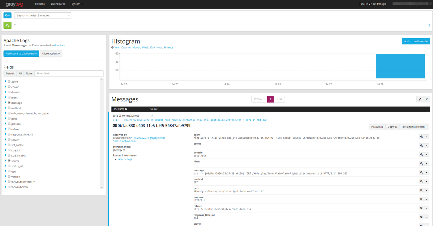

This is what you see on Graylog when you send your logs. The logs are already nicely parsed and you can immediately launch specific searches on them:
apache Logs
