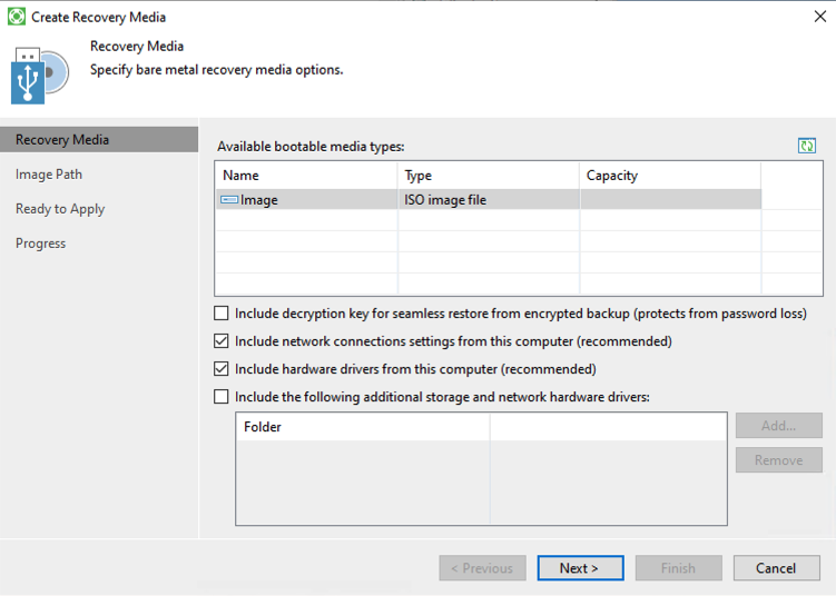

2. Veeam will ask if you want to include additional drivers.
If you are using specific hardware (such as a RAID controller), select the required drivers. Otherwise, the default options are usually sufficient.

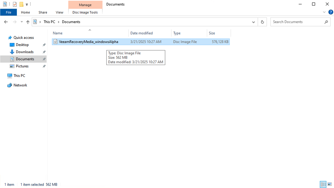

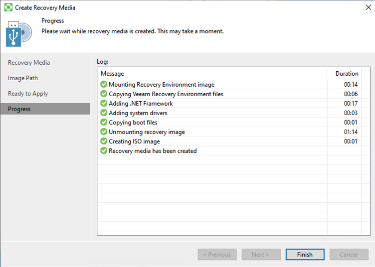

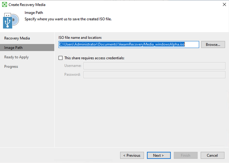

3. Choose where to save the ISO and give it a name.
Set ISO location and name
4. Wait until the operation completes. The ISO file will be generated.
Recovery ISO created Recovery ISO
You can now use this ISO to create a bootable USB key using a tool like Rufus.

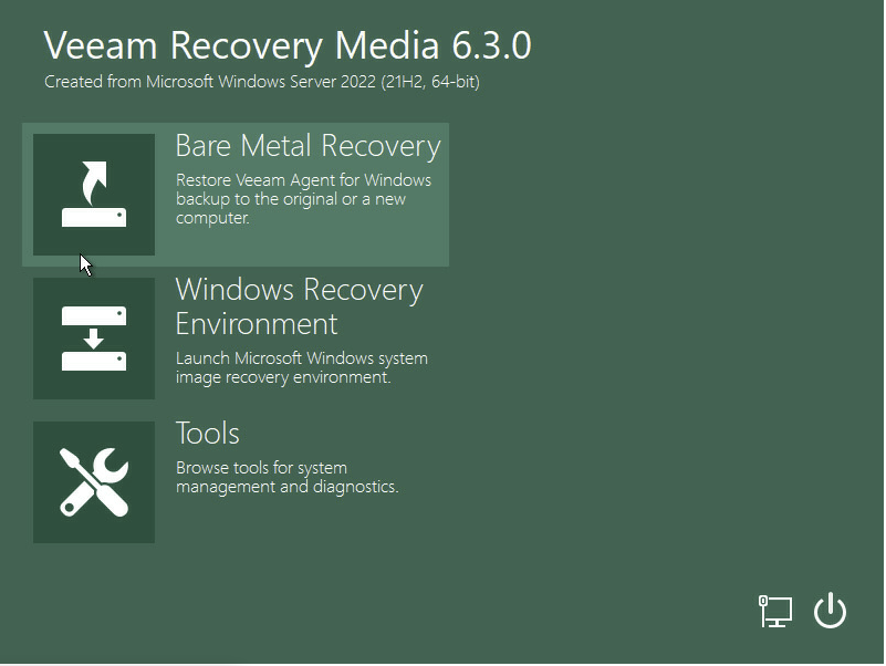

2. Once the system has started, the Veeam recovery wizard will open. Click Bare Metal Recovery.
Launch Bare Metal Recovery

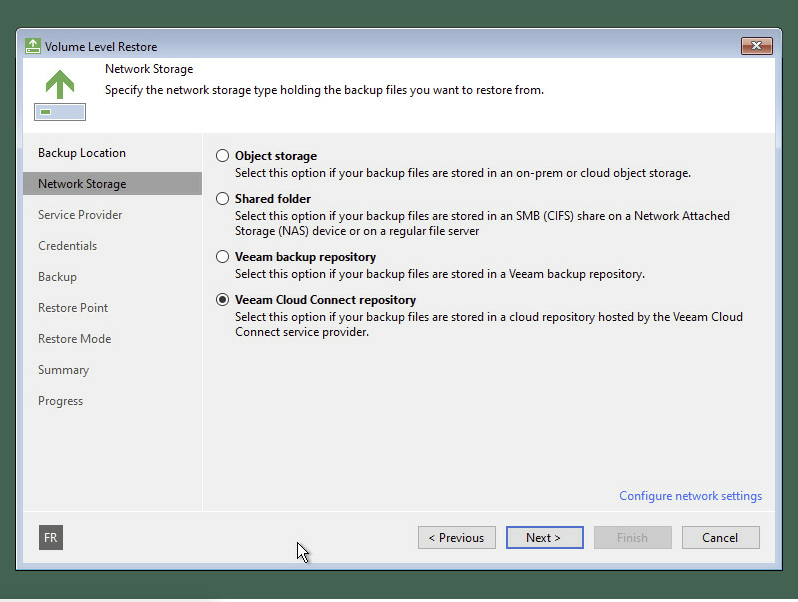

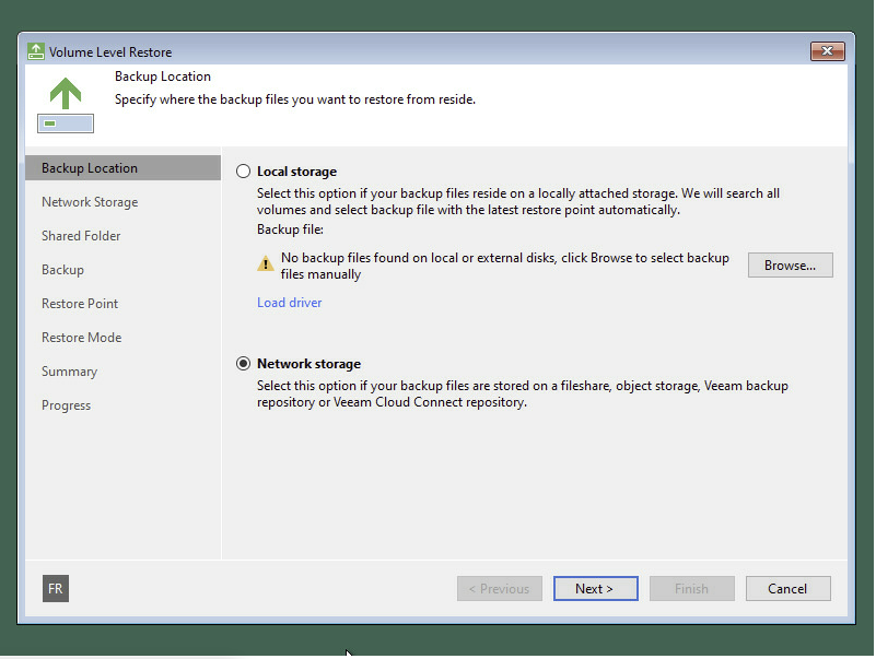

3. Select Network Storage to access your online backups.
If the network is not detected, you may need to configure it manually. Click Configure network settings and load any missing drivers.
4. Select Veeam Cloud Connect repository.
Choose Veeam Cloud Connect repository

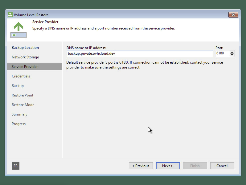

5. Enter the following address when prompted for the service provider:
Enter DNS
The automatic credential recovery procedure to access your restore points is not yet available. If needed, contact our support team to obtain them.

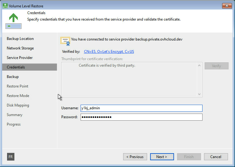

6. Enter your username and password to log in.
Enter credentials

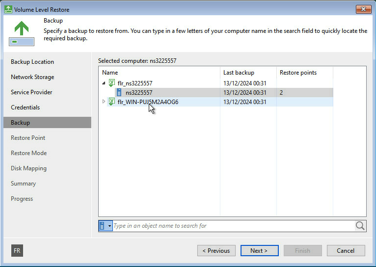

7. Select the server you want to restore.
Select server

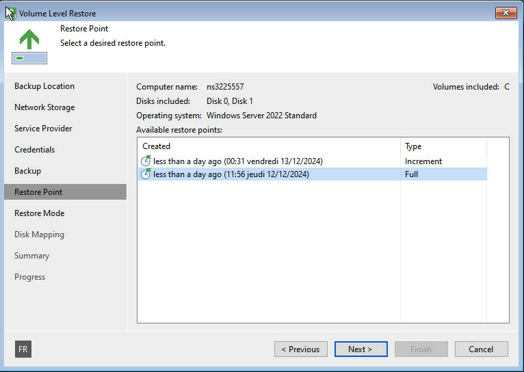

8. Choose the restore point (date/time) you want to go back to.
We recommend using the most recent successful backup unless you have a specific reason to go back to an earlier version.
Choose a restore point

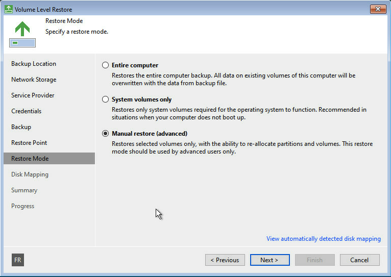

9. Choose the restore mode that fits your situation (choose Entire computer for a full restore).
Restore mode

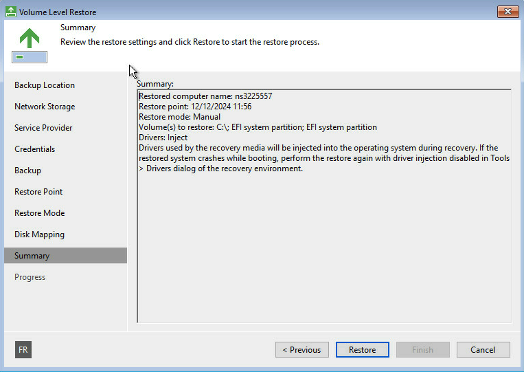

10. Review the summary, then start the restore.

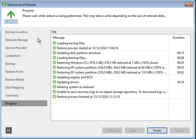

Launch restore - confirmation Launch restore - progress
The duration of the restore process depends on the size of your backup and your internet connection speed. Once complete, your system will reboot with the state corresponding to the selected restore point.
