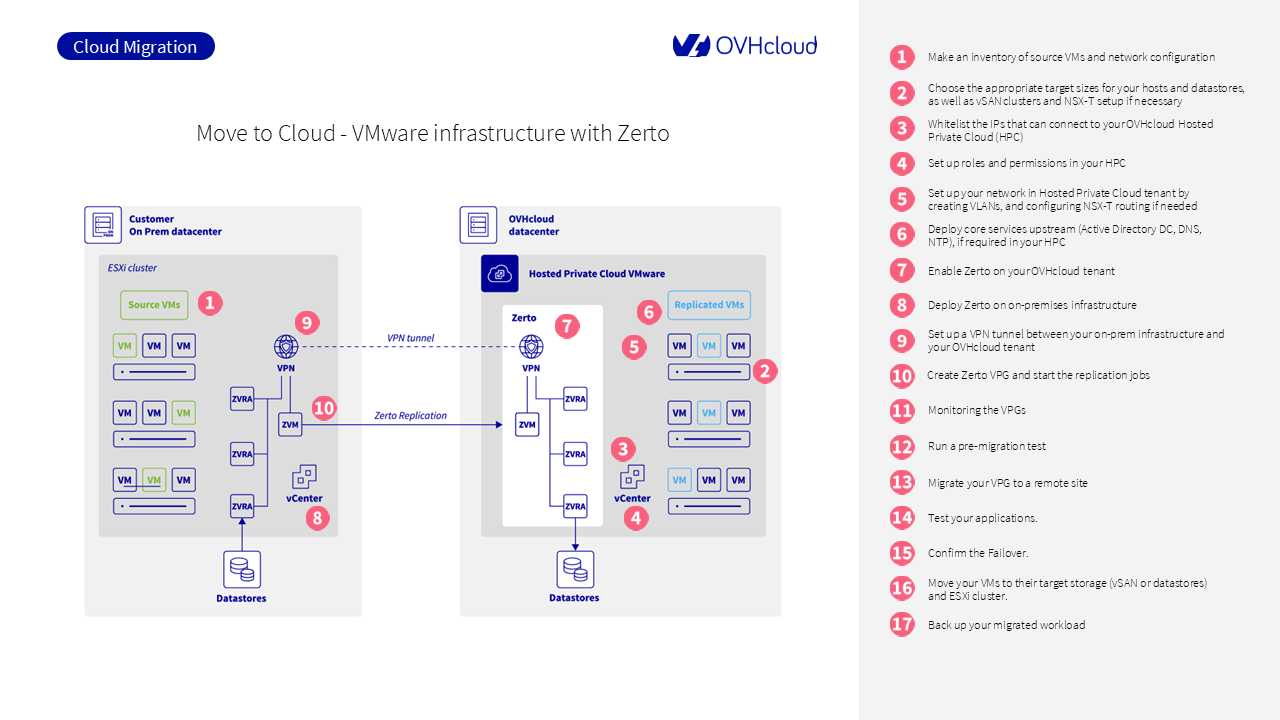

Step 1: Define your migration scope
At the end of this step, you will have a structured list of workloads to migrate and the associated network design.

Step 5: Build the target network
Before starting any VM replication or failover test, your Hosted Private Cloud network must be ready to receive the workloads. This includes replicating the source structure, creating the right segments, and preparing firewall rules.

Step 7: Install and activate Zerto in the OVHcloud tenant
Zerto is installed and managed per site. On the OVHcloud side, the components are deployed automatically when you activate Zerto.
In your Hosted Private Cloud interface:
  1. Go to Disaster Recovery.
  2. Select Enable Zerto Virtual Replication.
  3. Confirm and wait for deployment.
OVHcloud will deploy the following:
  • A dedicated ZVM (Zerto Virtual Manager).
  • A ZVRA (Zerto Virtual Replication Appliance) on each ESXi host.
  • An OVH-managed NSX-T firewall with preconfigured rules for Zerto ports.
Full details can be found in Zerto Virtual Replication on OVHcloud.
Step 8: Install Zerto on the source site
You must install Zerto components manually on your on-premises infrastructure.
Follow the procedure in Installing Zerto on source site.

Step 9: Set up the IPsec VPN tunnel
Zerto requires direct communication between ZVMs and ZVRAs. NAT is not supported.
Set up a site-to-site IPsec tunnel between your on-prem firewall and the OVHcloud tenant.
You can use any compatible device (e.g., Fortinet, Palo Alto, OPNsense).
Details and parameters are available in Zerto VPN Setup on OVHcloud.
Step 10: Pair the sites and create VPGs
Once ZVMs are online and communication is confirmed:
  1. Use the Zerto console to pair both sites.
  2. Create your first Virtual Protection Group (VPG).
A VPG groups all VMs that should be replicated and failed over together.
More information in Creating a VPG
