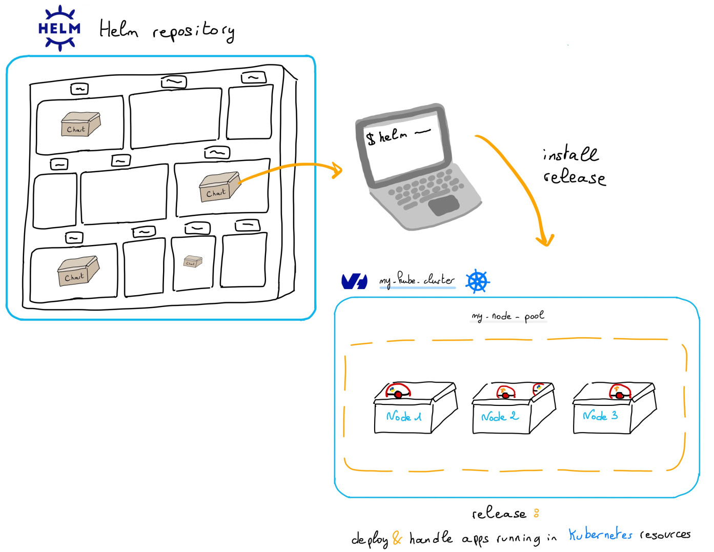

Helm is built around three big concepts: charts, repositories and releases.
Helm schema
A chart is a Helm package. Inside the chart you have all the resource definitions necessary to run an application, tool, or service inside of a Kubernetes cluster. It's the Helm equivalent of a Debian pkg for Linux, a Maven file for Java or a package.json for Node.js.
Charts are stored in repositories, where they can be shared. Repositories are the Helm equivalent of the NPM registry for Node.js or Maven Central for Java.
When a chart is installed in a Kubernetes cluster, the running instance is called a release. Multiple releases of a single chart can be installed at the same time in a cluster (think for example several instance of the WordPress chart for several different blogs instances running in the cluster).
