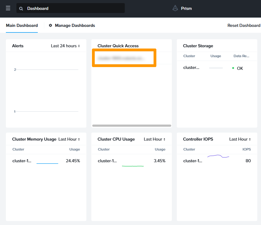

From Prism Central, click your cluster in the Cluster Quick Access widget to connect to Prism Element.

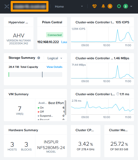

Click your cluster's name in the top left-hand corner next to the X.
01 Check ISCSI ADDRESS 02

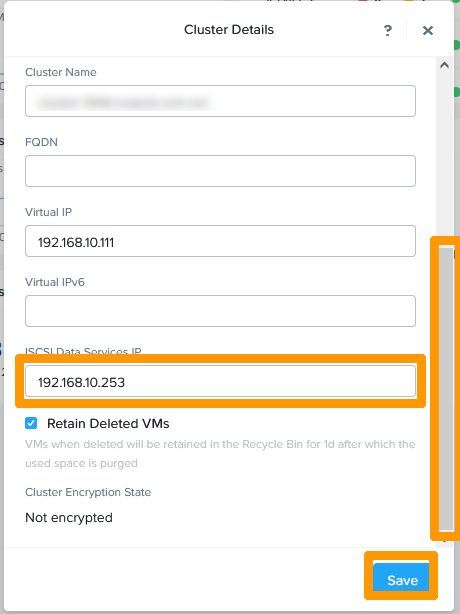

Scroll down the window and check the IP address in the ISCSI Data Services IP section.

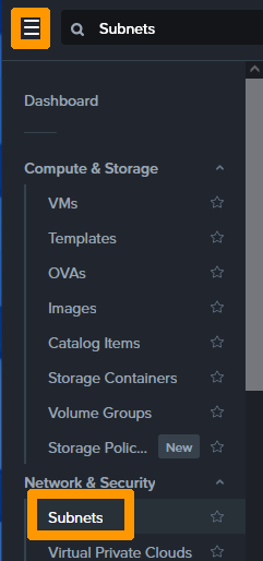

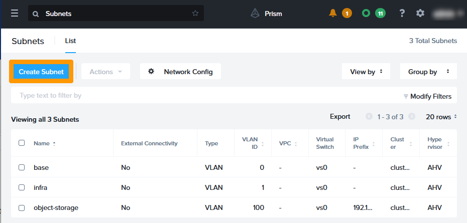

From Prism Central, go to the main menu and click on Subnets in the Network & Security category.
02 Create Storage VLAN 01

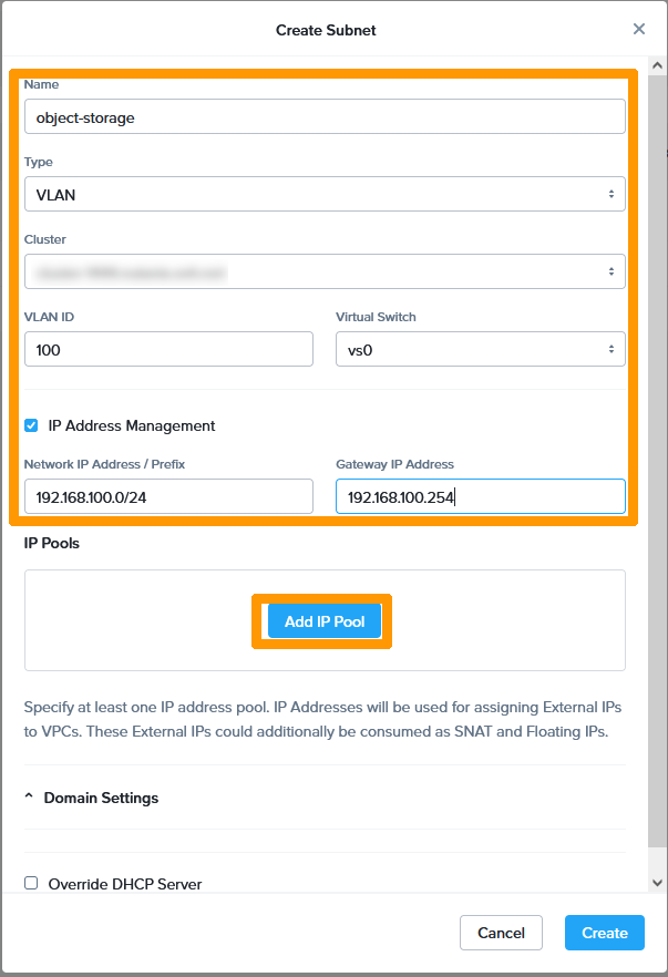

Click Create Subnet.
02 Create Storage VLAN 02
Check the IP Address Management box and fill in this information :
  • Name : Type object-storage.
  • Type : Select VLAN.
  • VLAN ID : Type your VLAN number as 100.
  • Virtual Switch : Keep vs0.
  • Network IP Address / Prefix : Write your subnet 192.168.100.0/24.
  • Gateway IP Address : Enter the address of your gateway 192.168.100.254.
Then click Add IP Pool.

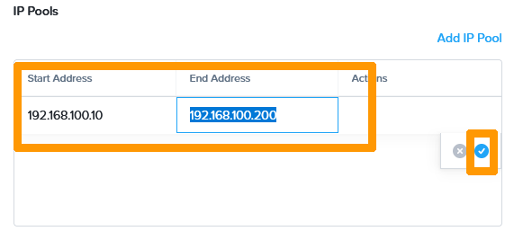

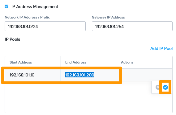

Enter this information :
  • Start Address : Start address of your scope as 192.168.100.10.
  • End Address : End address of your scope as 192.168.100.200.
Then click the blue validation button on the right.

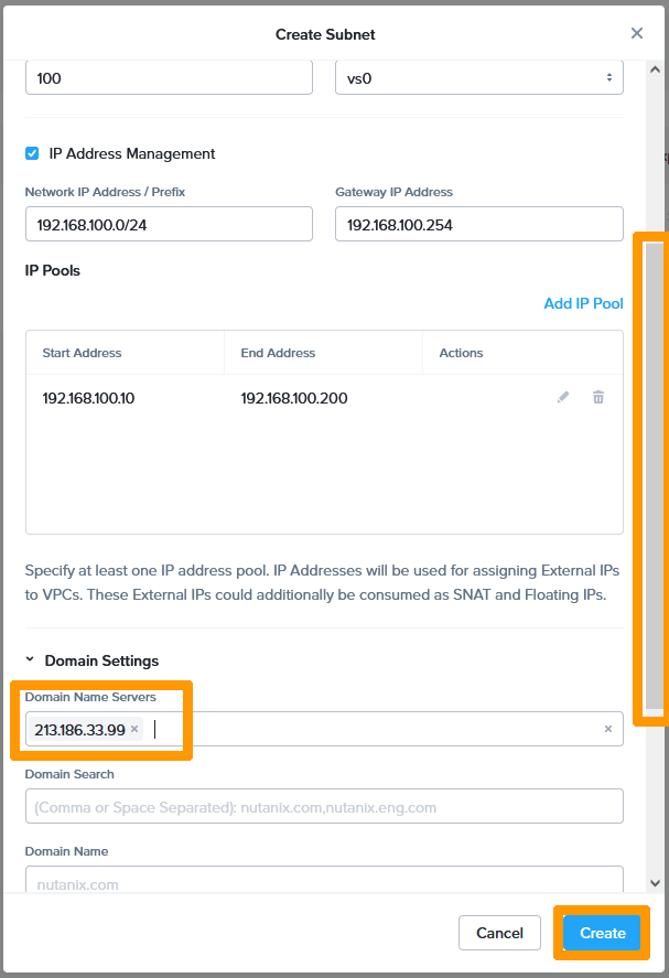

02 Create Storage VLAN 04
Scroll down and enter the OVHcloud DNS address 213.186.33.99 in Domain Name Servers and click Create.
02 Create Storage VLAN 05

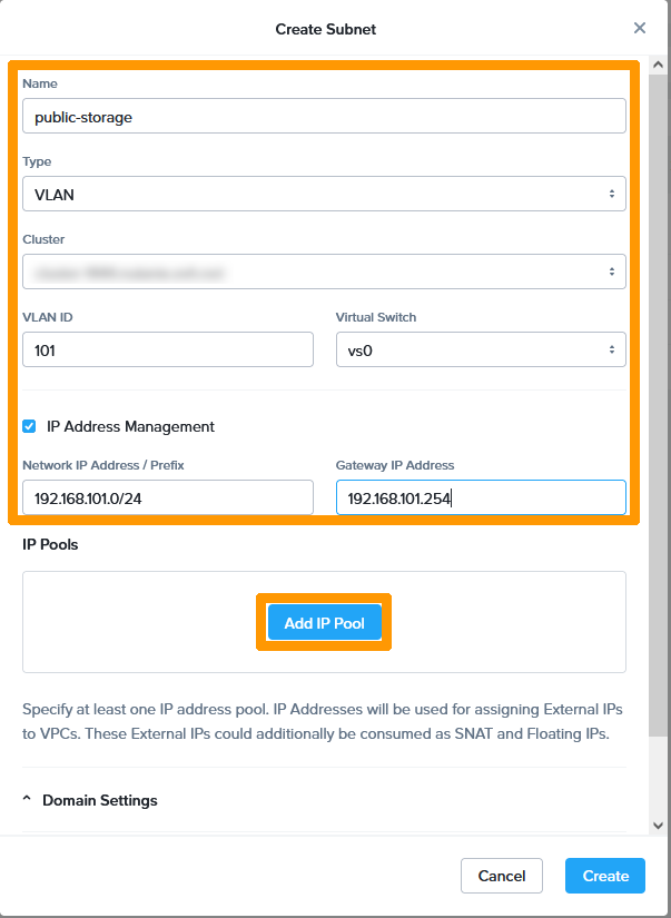

03 Create Public VLAN 01
  • Name : Type public-storage.
  • VLAN ID : Type your VLAN number as 101.
  • Network IP Address / Prefix : Write your subnet 192.168.101.0/24.
  • Gateway IP Address : Enter your gateway address 192.168.101.254.
  • Start Address : Start address of your scope as 192.168.101.10.
  • End Address : End address of your scope as 192.168.101.200.
Next, click the blue validation button on the right.
03 Create Public VLAN 03

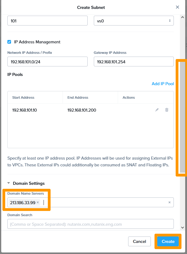

03 Create Public VLAN 04

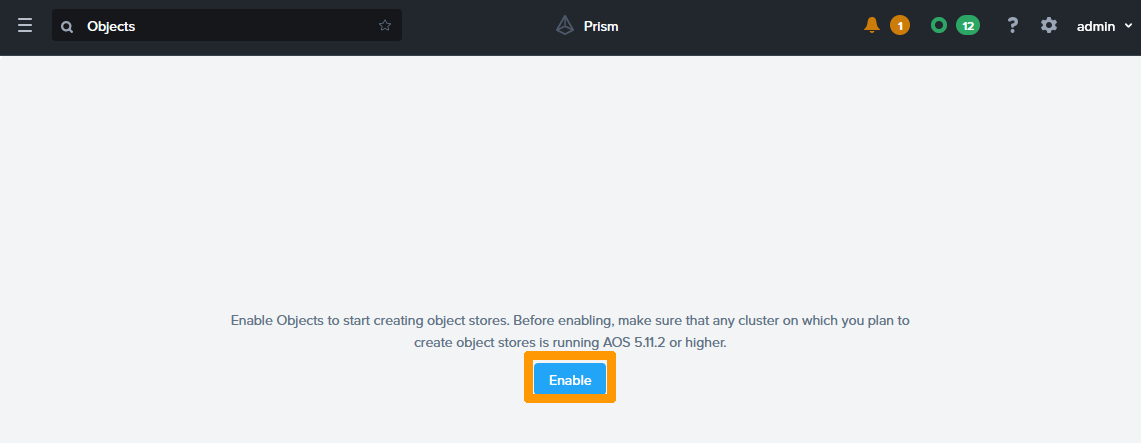

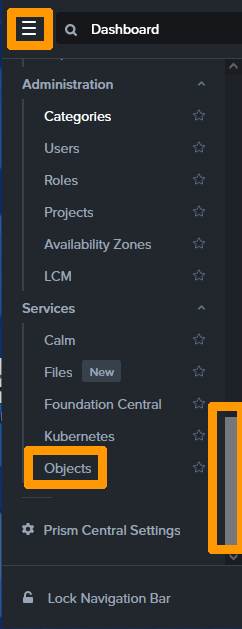

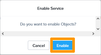

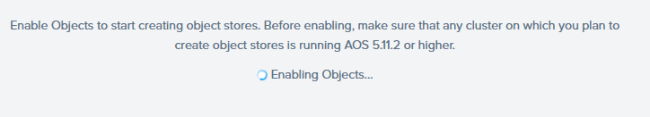

Go to the main menu, scroll to the Services section and click Objects.
04 Activate Object 01
Click Enable.
04 Activate Object 02
Click Enable to validate the activation of Nutanix Objects.
04 Activate Object 03

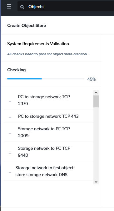

The service checks your system compatibility.
04 Activate Object 04

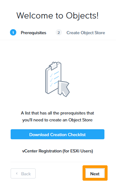

Click Next.

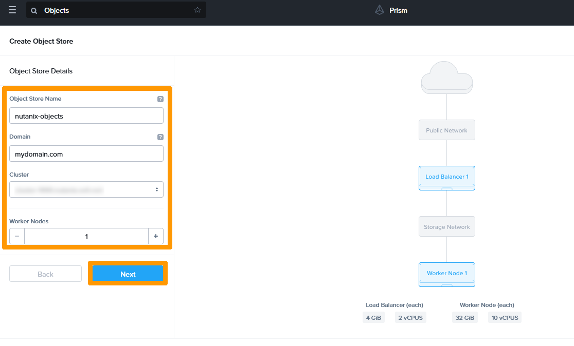

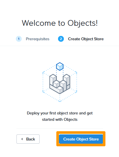

Click Create Object Store.
04 Activate Object 06
Fill in this information :
  • Object Store Name : the name of your object storage, such as nutanix-objects.
  • Domain : The domain name that will be used to access your storage, such as mydomain.com.
  • Cluster : The cluster that must have Nutanix Objects enabled.
  • Worker Nodes : The number of nodes that your Object storage will use, select the number 1.
Then click Next.
04 Activate Object 07

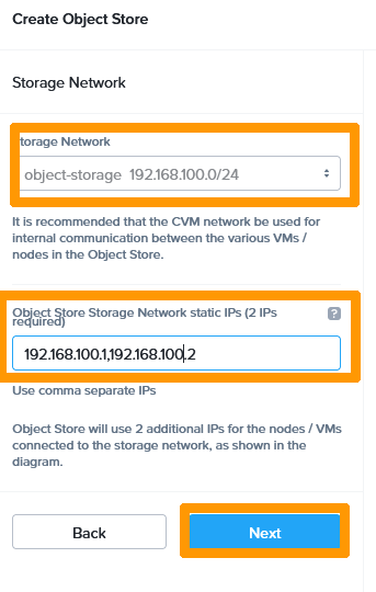

Select the VLAN object-storage in Storage Network and enter these two addresses 192.168.100.1,192.168.100.2 in Object Store Storage Network static IPs (2 IPs required). These addresses must not be within the scope of the VLAN DHCP.
Then click Next.

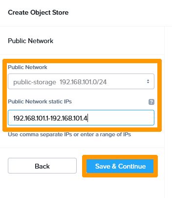

Select the public-storage VLAN in Storage Network and enter this range of four addresses 192.168.101.1-192.168.100.4 in Public Network static IPs. These addresses should not be within the scope of the VLAN DHCP.
Next, click Save & Continue.

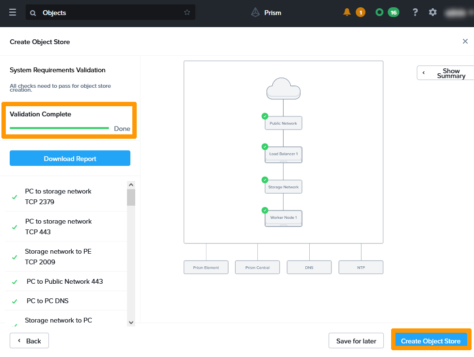

A connection check is performed between the VLANs, Prism Element and Prism Central.
04 Activate Object 10
When validation is complete, click Create Object Store.

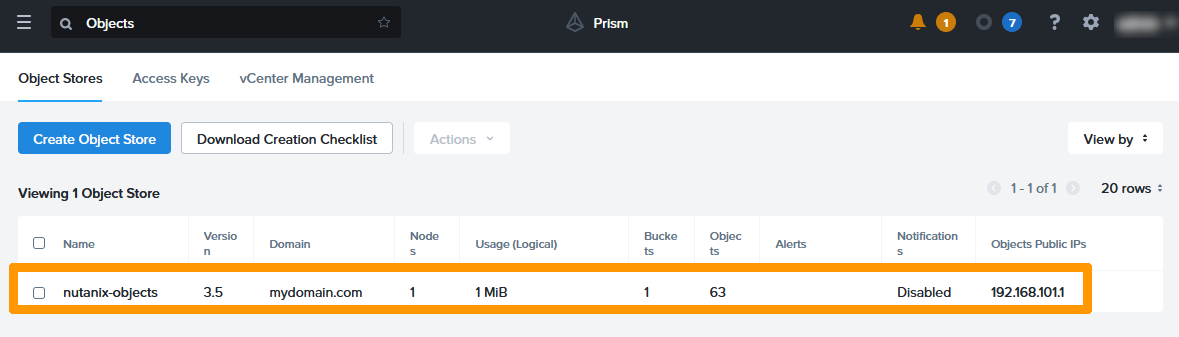

Wait twenty minutes for your Object Storage to be active and accessible through the address 192.168.101.1 that is located in your public-storage VLAN.

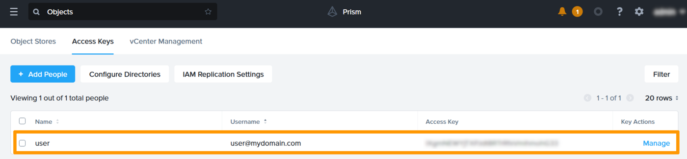

Creating an Access Key to your storage
To be able to use an Object storage, it is necessary to create associated Access Keys.

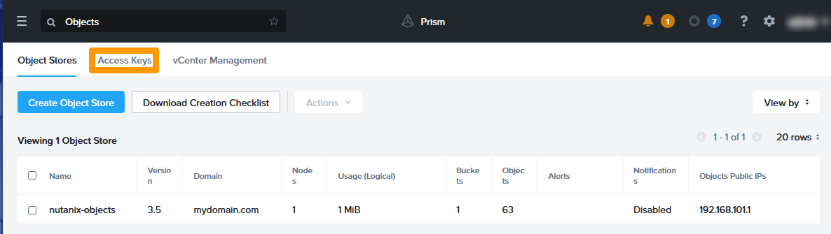

Go to the Access Keys tab.
05 Create Access Keys 01

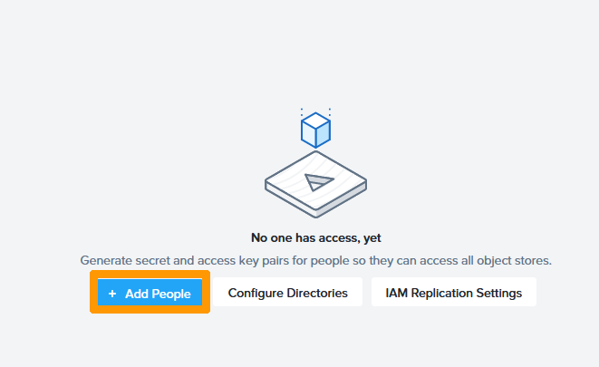

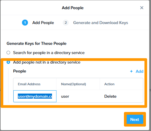

Click + Add People.
05 Create Access Keys 02
Check Add people not in a directory service, type user@mydomain.com in Email Address and click Next.
05 Create Access Keys 03

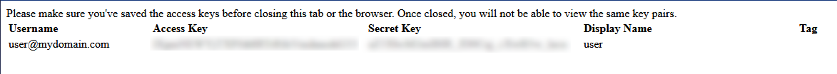

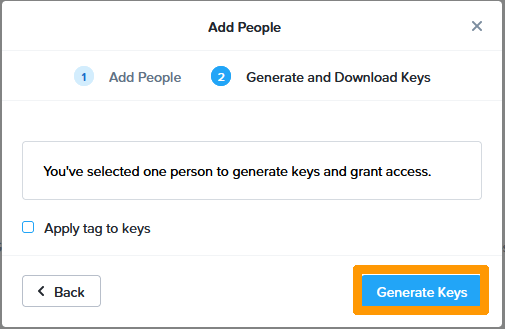

Click Generate Keys.
05 Create Access Keys 04

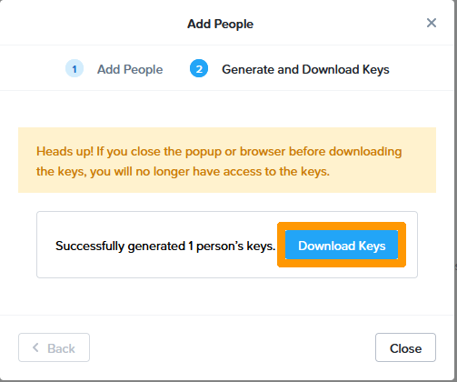

Click Download Keys.
05 Create Access Keys 05
WARNING
Your access credentials are only displayed once in your web browser. Please note down this information (Access Key and secret Key) before closing this window.

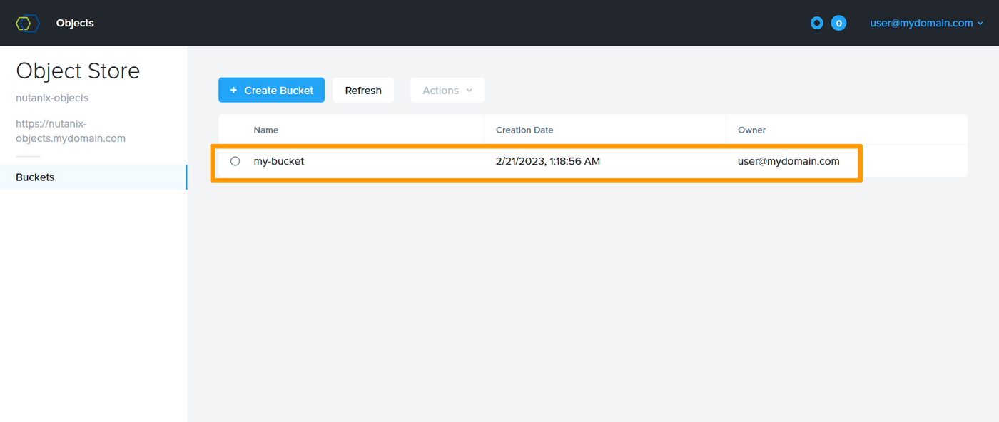

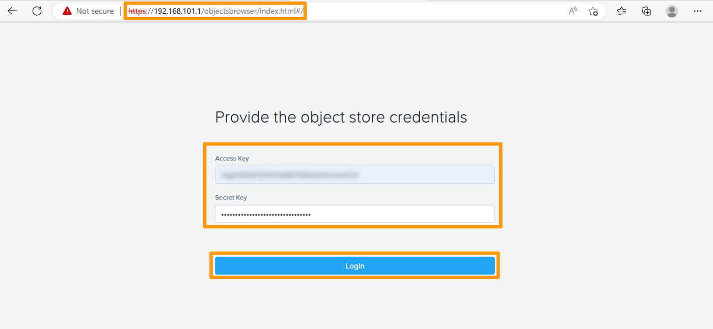

Now that the bucket is created we will use a browser to connect to the web interface provided by Nutanix in order to check the existence of our bucket.
Using a web browser, connect to this URL https://192.168.101.1/objectsbrowser which corresponds to your Nutanix Objects access point and enter your credentials (access_key and secret_key). Then click on Login.
06 Connect to WEB interfaces 01
You can see the bucket you created in the command line. You can create and delete buckets or objects in your web interface.
