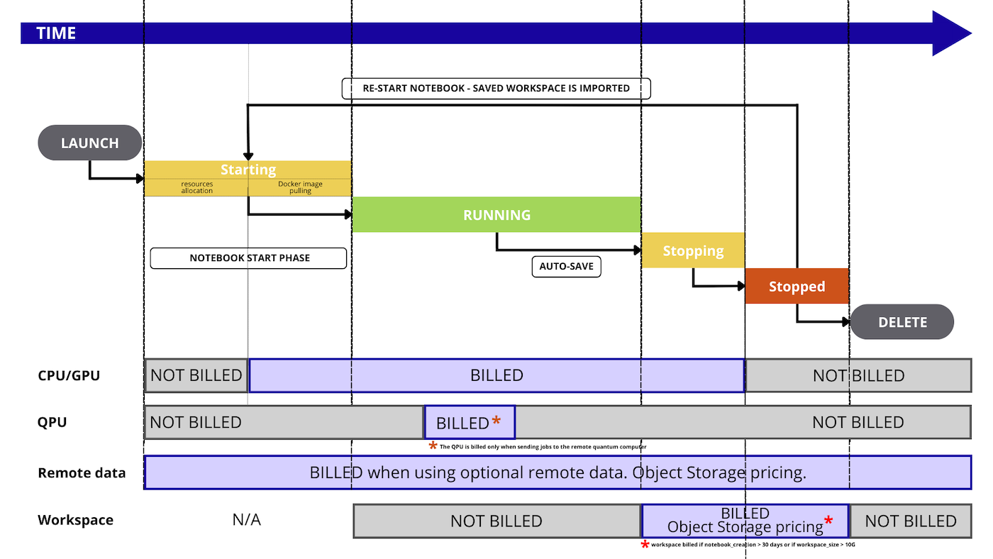

Here is a detailed graph that illustrates every step that is billed or not during the Quantum Notebooks workflow:

As stated above and shown in the image above, you pay for these resources as long as you consume them. This happens when the image of your notebook is pulled, during the STARTING phase, but also during RUNNING and STOPPING phases, until you reach the STOPPED phase.
