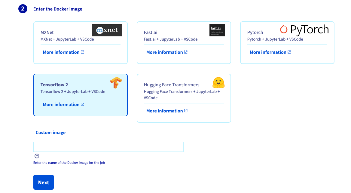

Step 2 - Select the notebook corresponding to your needs
A job is basically a Docker container that is run within the OVHcloud infrastructure.
Notebooks are daemon jobs, meaning that they will run indefinitely until the user requests an interruption.
AI Training offers several notebook images with different configurations. You can choose the configuration that best suits your needs among them.
Currently, the following configurations are available :
  • PyTorch : An OVHcloud preset image including JupyterLab notebook, Visual Studio Code IDE and pytorch libraries
  • Tensorflow 2 : An OVHcloud preset image containing JupyterLab notebook, Visual Studio Code IDE and tensorflow 2 libraries
  • Hugging Face Transformers : An OVHcloud preset image containing JupyterLab notebook, Visual Studio Code IDEand hugging face libraries
  • MXNet : An OVHcloud preset image containing JupyterLab notebook, Visual Studio Code IDE and mxnet libraries
  • Fast.ai : An OVHcloud preset image containing JupyterLab notebook, Visual Studio Code IDE and fast.ai libraries
  • autogluon : An OVHcloud preset image containing JupyterLab notebook, Visual Studio Code IDE and AutoGluon + mxnet libraries image
Once your image is chosen, click Next.

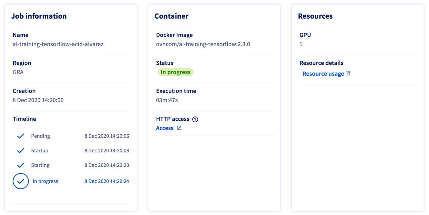

Step 4 - Access notebook URL
Once your job is In progress, in the job description panel, you should see the Access link. Click on it and you will be redirected on your job URL.

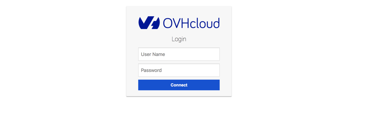

Step 5 - Login as an AI Training user
If you are not authenticated as an AI Training user, you should see a screen asking for your username and password.
If you have not created a user for AI Training yet, you can follow the instruction here.
Fill the fields and click Login.

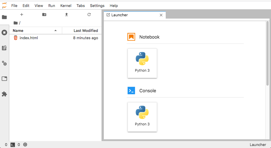

Step 6 - Use your notebook

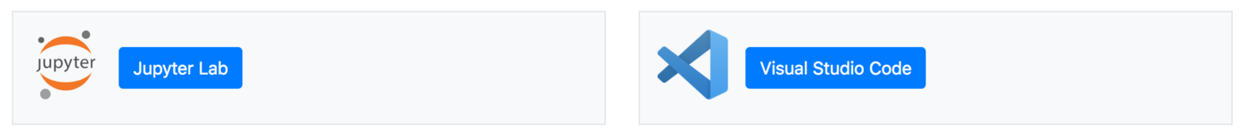

In most provided preset image,s you can choose which editor you prefer between JupyterLab and VisualStudio code.
Just select the one that you want to use, and you will be redirected to the corresponding one.
By default, the home directory of your job is located under /workspace. It means that you will have read and write access to that directory as well as your read and write mounted volumes.
If you are missing a library or a configuration, you can add it directly in command line of the notebook's console as long as you don't need privileged access (root access). Example : pip install <...>

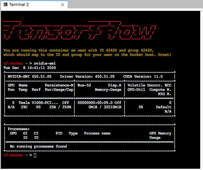

If you open a console tab in your notebook and type nvidia-smi, you will see the available GPUs that you can use on your notebook.

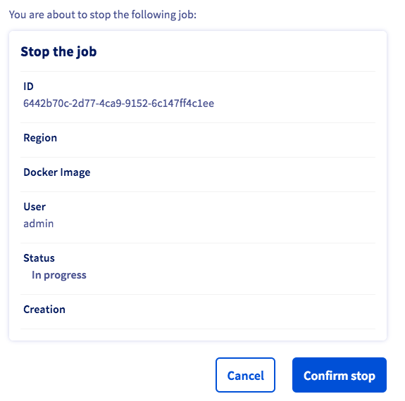

Step 7 - Stop your notebook
Once you are done working with your notebook don't forget to stop it.
You can do it by selecting Stop in the action menu.
Then confirm your choice.
After some time your job should go into an Interrupted state meaning that the job has been stopped.
Before going into the Interrupted state, your job may run through the Finalizing state. During this phase, all data inside read & write volumes are saved inside their linked containers in your object storage.
