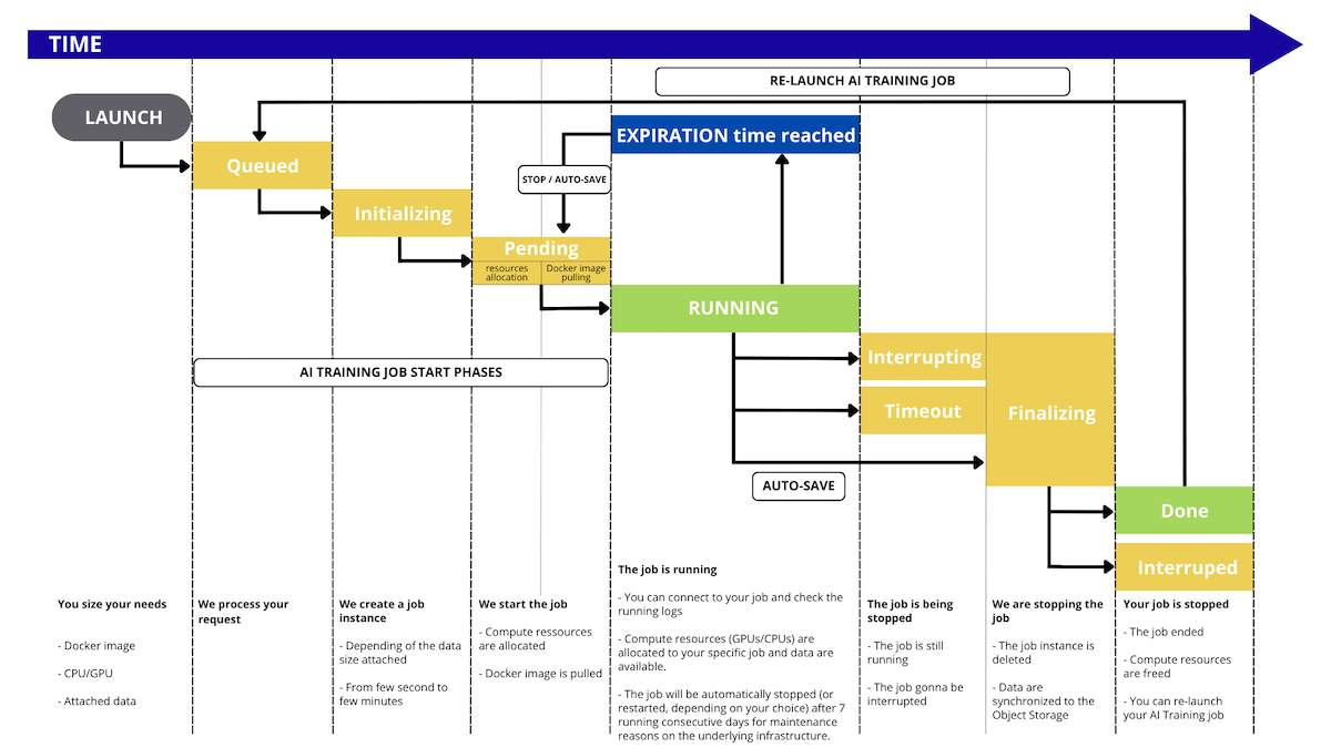

AI Training job lifecycle
By default, your AI Training job will automatically shut down after 7 consecutive days of being in a RUNNING state. You can also enable Automatic Restart to have it restart every 7 days, or contact our support to extend this period to 28 days.
During its lifetime, the AI Training job will go through the following statuses:
  • QUEUED: The job run request is about to be processed.
  • INITIALIZING: The job instance is created and the data is synchronized from the Object Storage. To know more about the data synchronisation check out the Data - Concept and best practices section.
  • PENDING: First, the system allocates the necessary compute resources (CPU/GPU) for the job. Then, the specified Docker image is pulled for use in the job.
  • RUNNING: The job is running, you can connect to it. Compute resources (GPUs/CPUs) are allocated to your specific job and data are available.
  • INTERRUPTING: The job is still running but an interruption order was received and is about to be processed.
  • FINALIZING: The job instance is deleted and the data is synchronized back to the Object Storage.
  • DONE: The job ended normally.
  • TIMEOUT: The job is still running but is about to be interrupted because the timeout was reached.
  • INTERRUPTED: The job is ended and was interrupted.
  • FAILED: The job ended with an error, e.g. the process in the job finished with a non 0 exit code, Docker image could not be pulled. For more information, refer to this section of our Troubleshooting documentation.
  • ERROR: The job ended due to a backend error. You may contact our support.

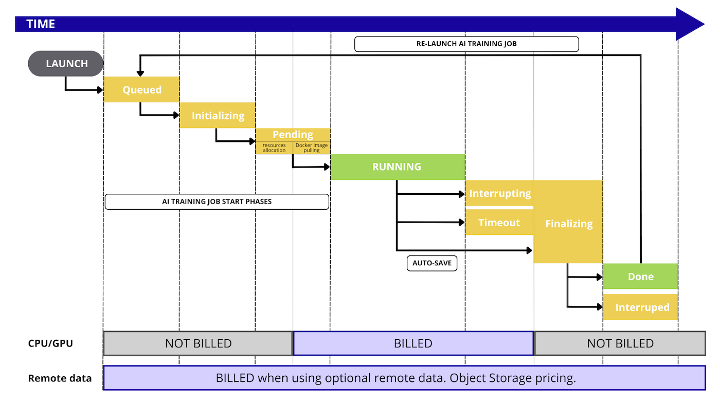

Here is a detailed graph that illustrates every step that is billed or not during the AI Training workflow:
billing
