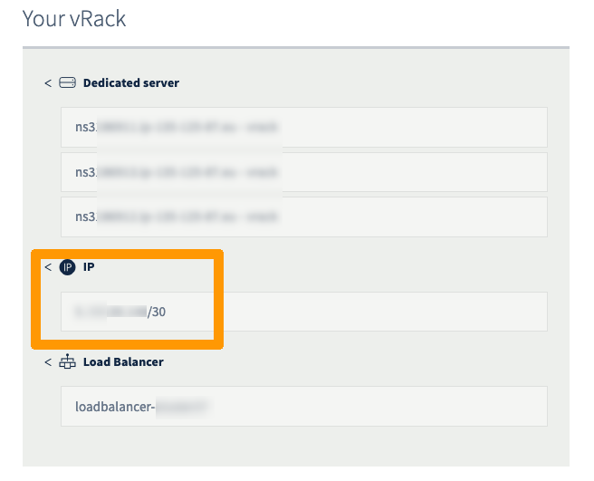

Check the Additional IP address
Log in to the OVHcloud Control Panel and open the management section of your vRack. Verify the Additional IP address used by the Nutanix Cluster.
Additional IP
The following instructions will use the IP block 198.51.100.0/30 for example purposes.
For vRack purposes, the first, penultimate, and last addresses in any given IP block are always reserved for the network address, network gateway, and network broadcast respectively. This means that the first usable address is the second address in the block, as shown below:
198.51.100.0   Reserved: Network address
198.51.100.1   First usable IP
198.51.100.2   Reserved: Network gateway
198.51.100.3   Reserved: Network broadcast

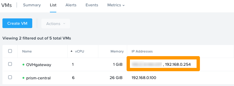

If the gateway still exists, go to the VM in the VM section of your Prism Central WebUI.
The gateway IP is displayed here.

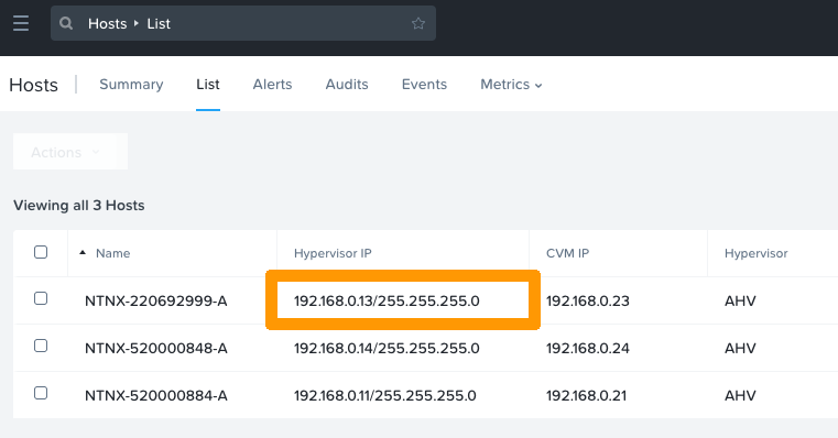

However, if the gateway is not present, check the subnet by going to Hardware then Hosts in the Prism Central WebUI.
check subnet on gateway2
In this case the subnet is 192.168.0.0/24. In the default configuration, the gateway IP address is therefore 192.168.0.254.

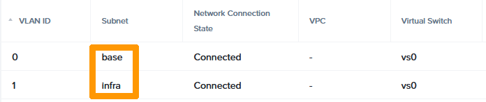

Retrieve the subnet name
Click on the OVHgateway VM and open the NICs tab.

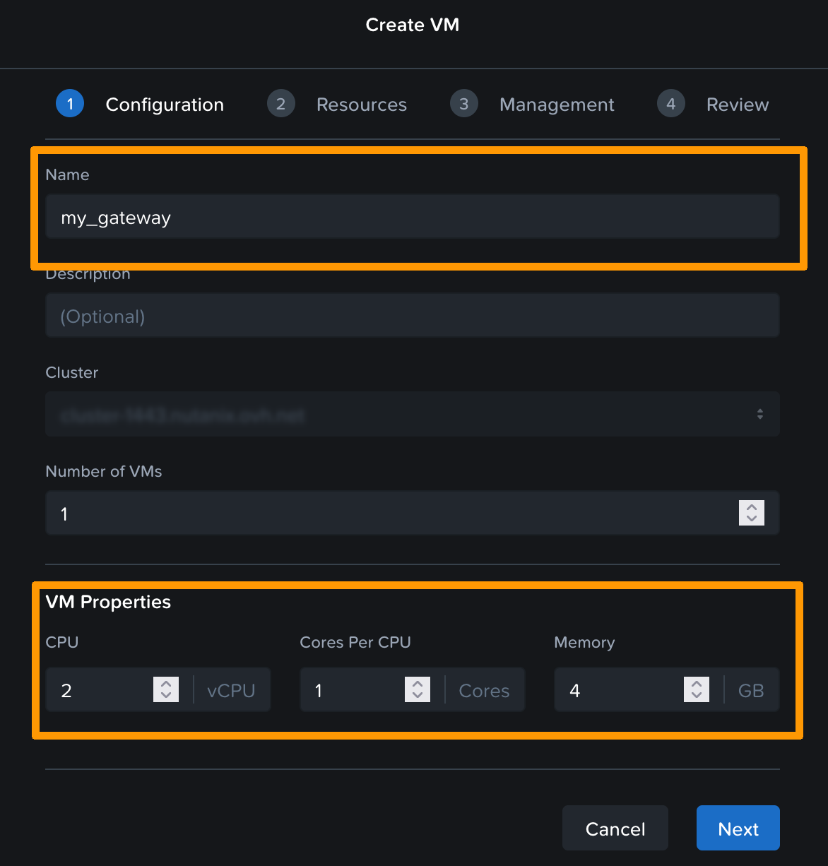

Log in to Prism Central and create a VM.
Customise the VM name and characteristics.
Deploy VM
Click Next

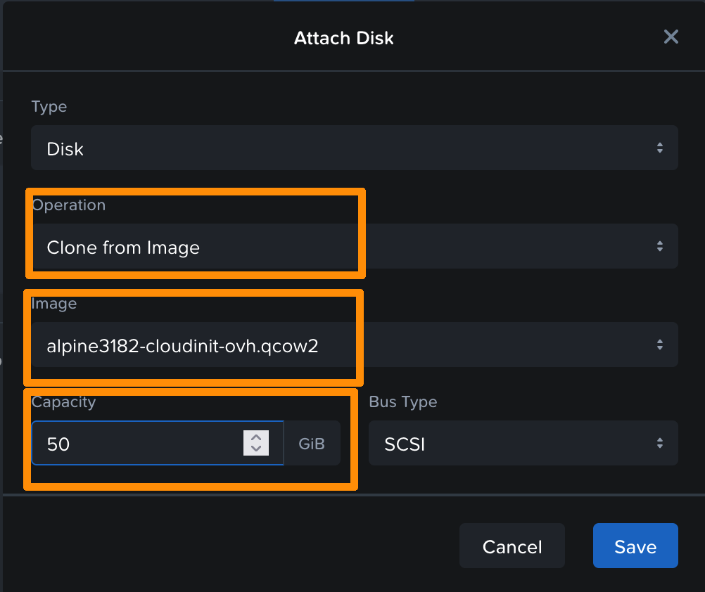

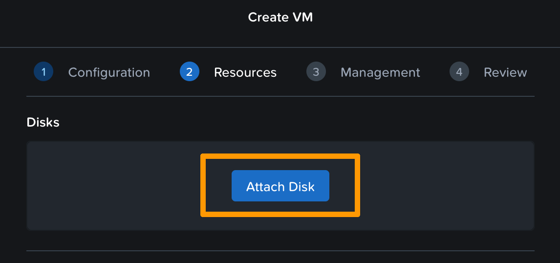

You then need to attach a disk. To do this, you can select the image used to create the original gateway.
Attach Disk1 Attach Disk2

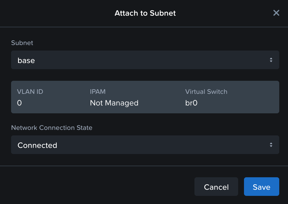

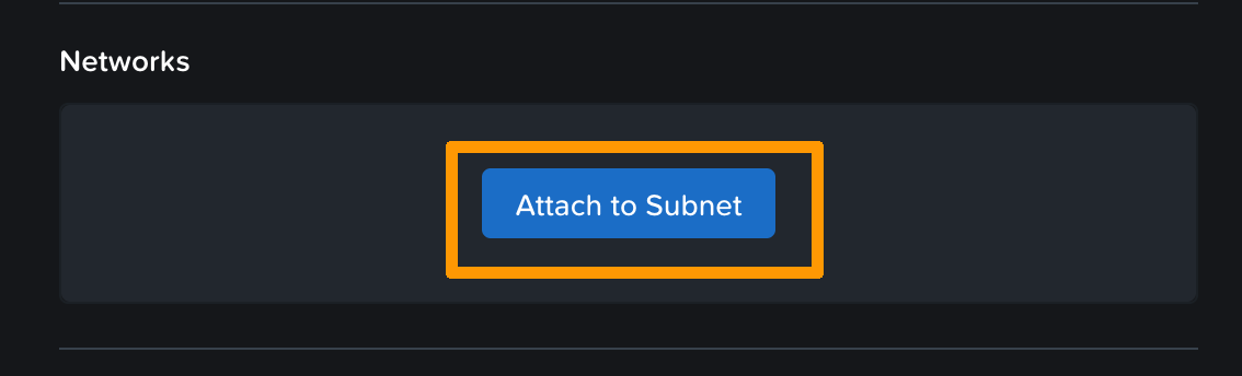

Then add two nics to the “base” network:
Attach subnet Attach subnet

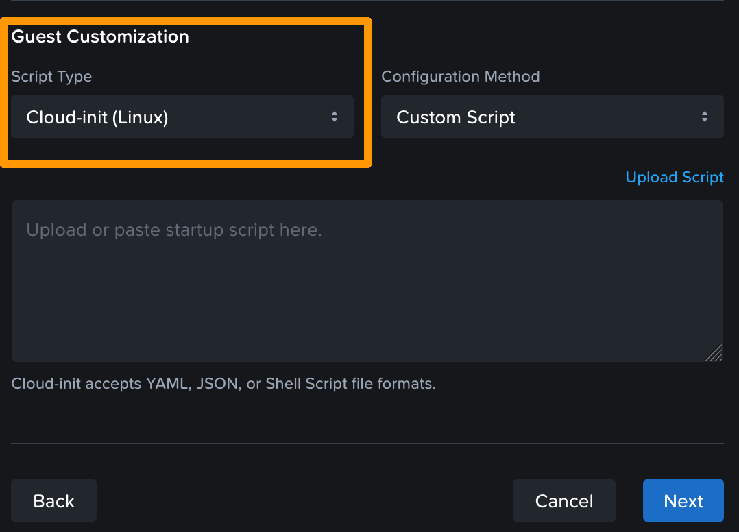

In the management interface, choose cloud-init in the “Guest customisation” section.
Guest customization
You now need to create a yaml script to define the parameters. This script contains the user data. When the system boots, these settings such as users, packets, files, etc. will be applied to the VM.

Paste this script into the box provided.
Guest customization
Click Next, then Create VM.
