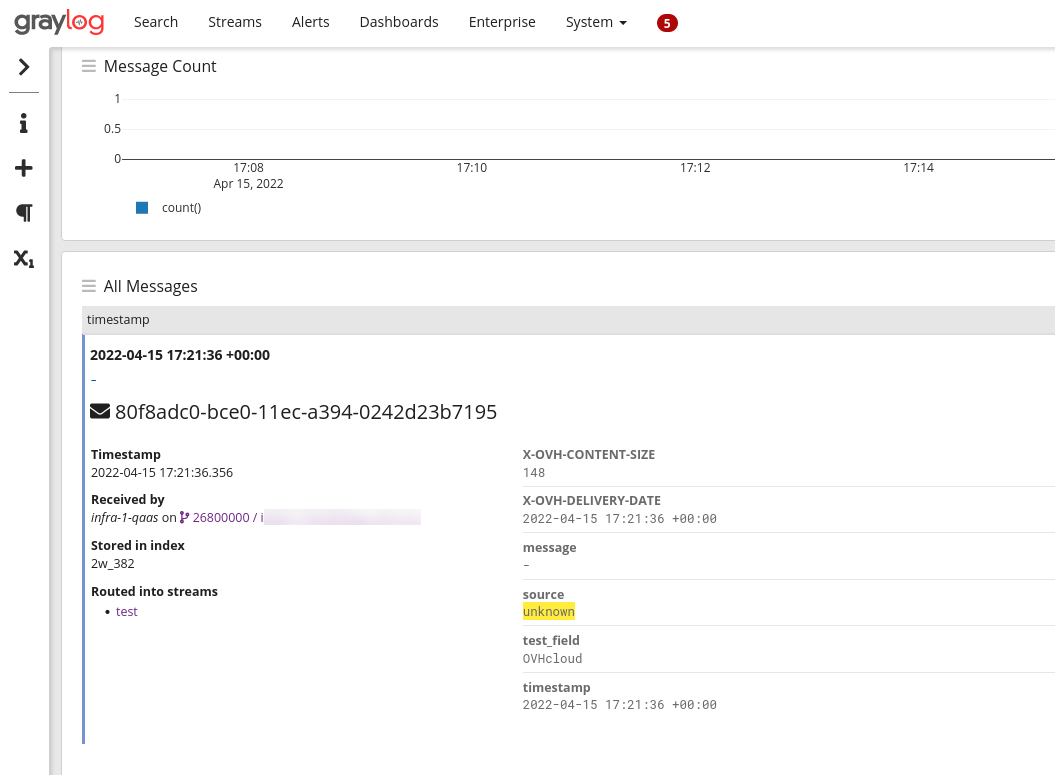

Replace the <user>, <password> and <ldp-cluster> with your Logs Data Platform username, password and cluster. You can also use tokens in place of your credentials. Sending this payload will result in this log:
simple\_log

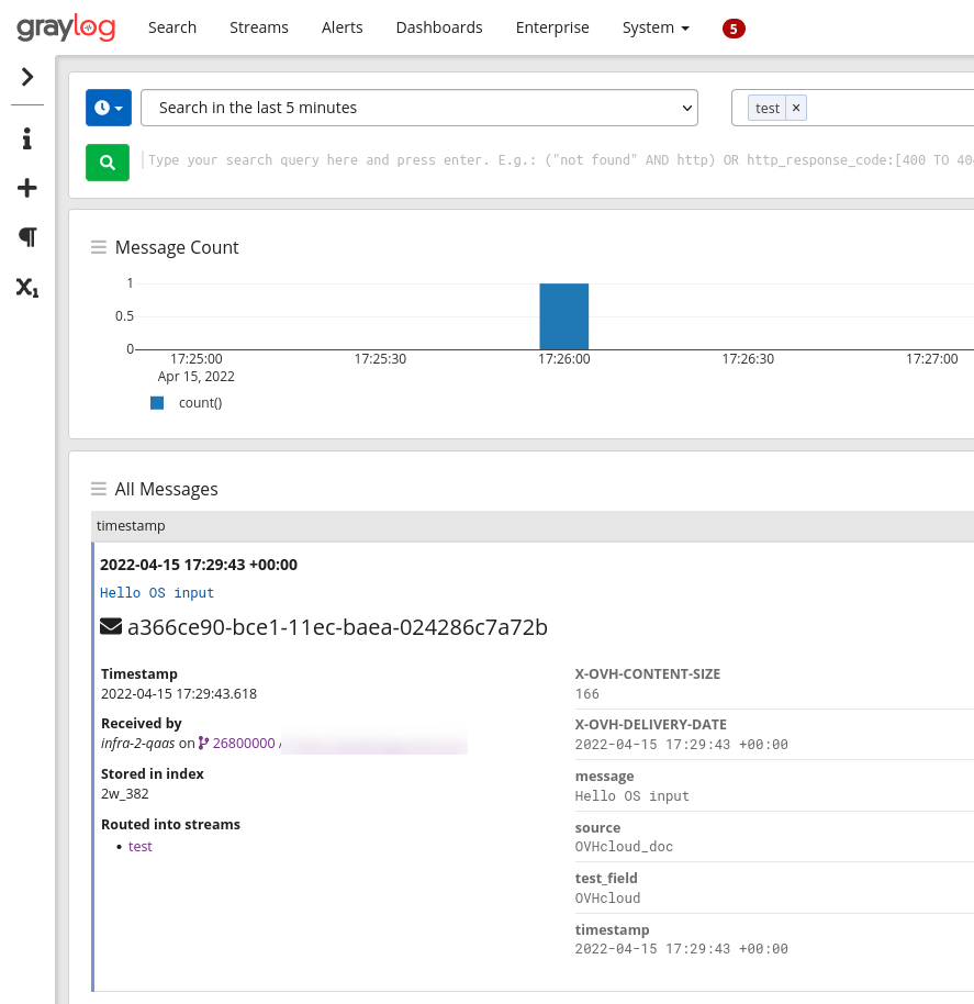

The system automatically set the timestamp at the date when the log was received and added the field test_field to the log message. Source was set to unknown and the message to -. Note that the payload follows the JSON specification (and not the GELF one). The system will still recognize any reserved field used by the GELF specification. Here is another example:
$ curl -H 'Content-Type: application/json' -u '<user>:<password>' -XPOST https://<ldp-cluster>.logs.ovh.com:9200/ldp-logs/_doc -d '{ "X-OVH-TOKEN" : "7f00cc33-1a7a-4464-830f-91be90dcc880" , "test_field" : "OVHcloud" , "short_message" : "Hello OS input", "host" : "OVHcloud_doc" }'
This will create the following log:
gelf\_log
The system used the reserved fields associated with GELF to create the message and the source fields.

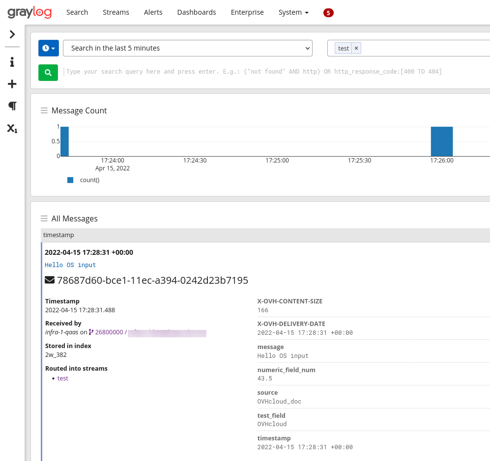

Logs Data Platform will also detect any typed field in the original data and convert them accordingly to our field naming convention. This last example illustrates it:
$ curl -H 'Content-Type: application/json' -u '<user>:<password>' -XPOST https://<ldp-cluster>.logs.ovh.com:9200/ldp-logs/_doc -d '{ "X-OVH-TOKEN" : "7f00cc33-1a7a-4464-830f-91be90dcc880" , "test_field" : "OVHcloud" , "short_message" : "Hello OS input", "host" : "OVHcloud_doc", "numeric_field" : 43.5  }'
The numeric field numeric_field will be detected as a number and will be suffixed to follow our naming conventions.
gelf\_convention

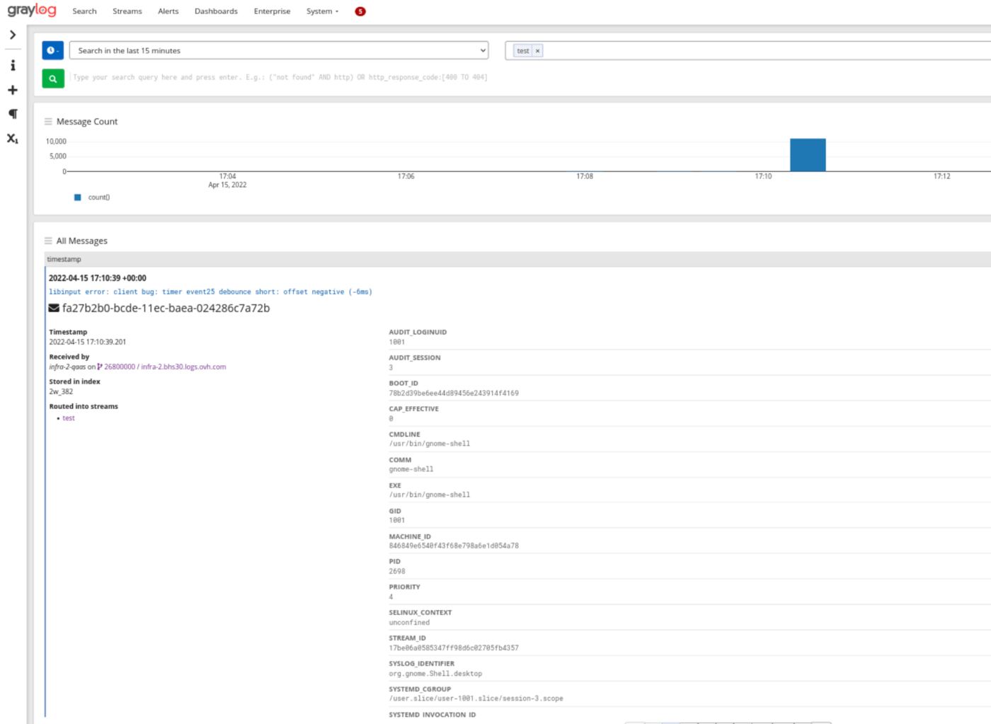

Once configured and launched you will immediately see this type of logs in Graylog:
vector\_logs
The logs from journald arrived fully parsed and ready to be explored. Use different sources and transforms to send your application logs to Logs Data Platform.
