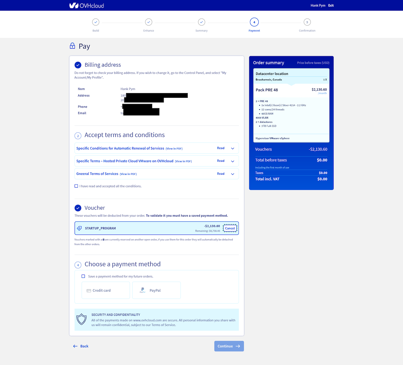

Placing a new order
Depending on the type of service you want to order, here's how to use your credits:
For eligible Public Cloud services
Place your order normally: Select the Public Cloud services you need and proceed with the order.
Credits applied automatically: During the next billing cycle for these services, your Startup Program credits will automatically cover the costs.
For other eligible products
Place your order: Select the eligible services you want to purchase.
Select the payment method:
At the end of the order, when prompted to choose a payment method, go to the Voucher section.
Select the STARTUP_PROGRAM voucher by clicking Apply.
Add or select a payment method to cover the cost of non-eligible products using the voucher.
Proceed to payment: Click Pay to finalize the order using your credits.
