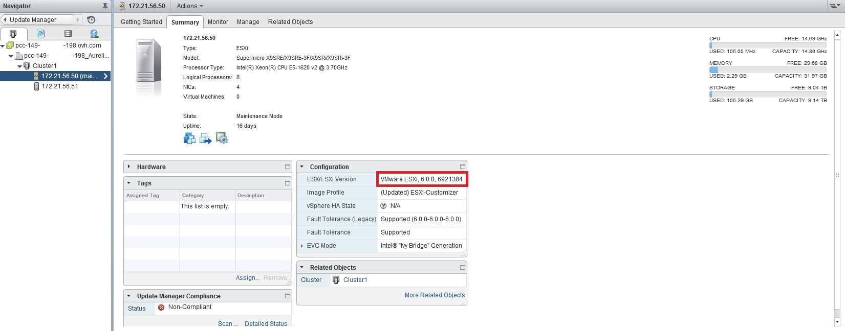

Check the host version
To check your host version, log in to your vSphere interface and go to the host summary, in the Configuration section:
The corrected versions are as follows:
ESXi 6.5: 7388607
ESXi 6.0: 6921384
ESXi 5.5: 6480324

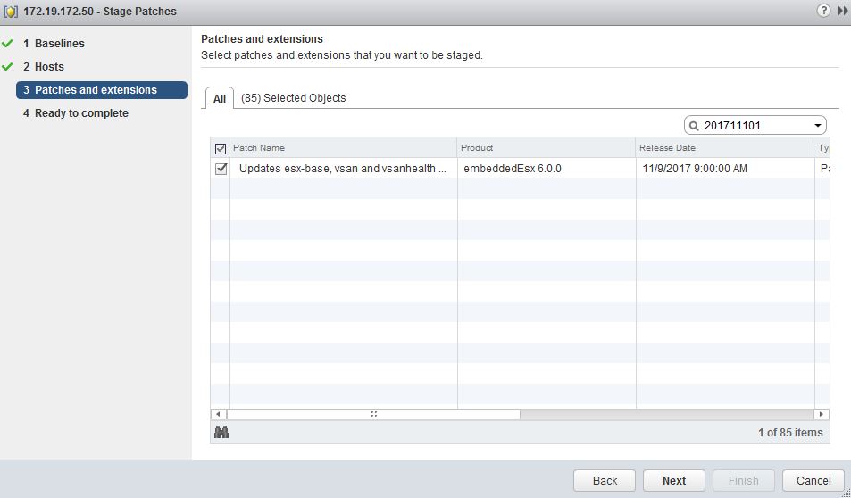

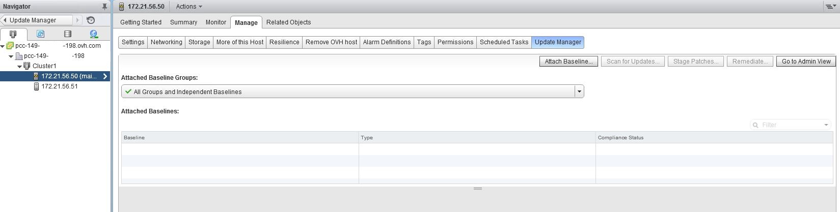

Update your host by switching it to maintenance mode (your host will be rebooted during the procedure), and use the VMware Update Manager plugin .
The patches are as follows:
This version 5.5 patch is only for CVE-2017-5715 , not CVE-2017-5753.
In the list of patches, you can use the filter so that only the patch you are searching for appears. This way, you can just select this patch.
