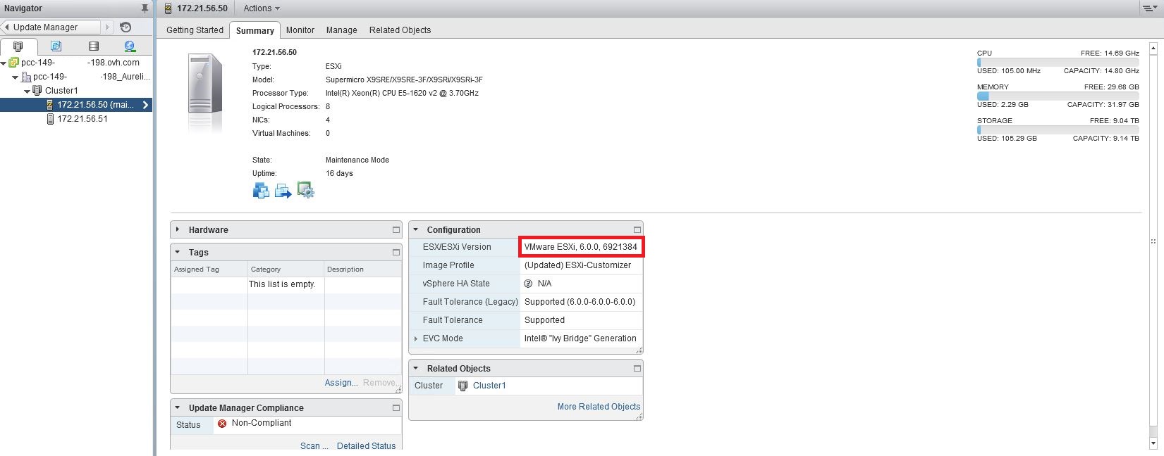

To check your host version, log in to your vSphere interface and go to the host summary, in the Configuration section:
Host configuration section
The corrected versions are as follows:
  • ESXi 6.5: 7388607
  • ESXi 6.0: 6921384
  • ESXi 5.5: 6480324
If you have an older version of these builds, you will need to update your host. As a reminder, an automatic update will be scheduled by OVH. However, you can also perform this update manually.

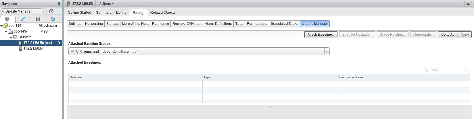

Update your host by switching it to maintenance mode (your host will be rebooted during the procedure), and use the VMware Update Manager plugin.

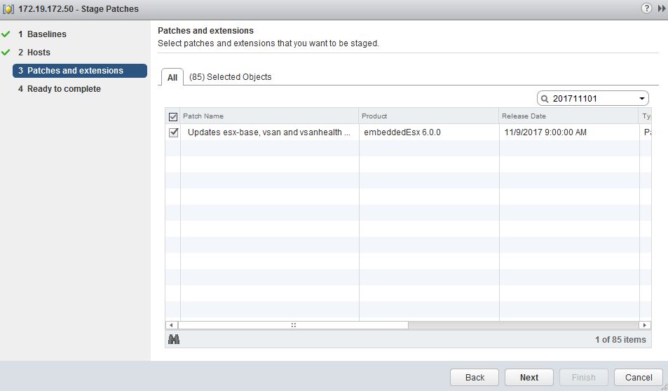

In the list of patches, you can use the filter so that only the patch you are searching for appears. This way, you can just select this patch.
Configuration
