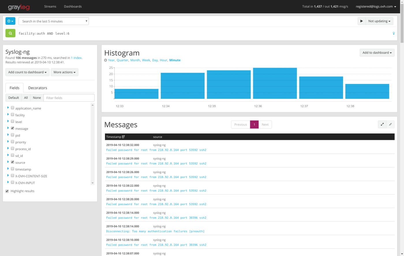

Let's play with Graylog Dashboards
Let's recap: you have a Linux instance, and it's sending log locally and remotely, thanks to the syslog-ng log collector. We send two types of flows: internal() and system()
The last step is to create a dashboard displaying the results:
  • Connect to the Logs Data Platform manager, ensure that you have a Stream and that the token in the syslog configuration file is OK. Ensure that you have a Dashboard created.
  • Head to your stream by using the button Graylog access located in the ... menu of your stream, or head directly to the graylog access of your cluster.
  • Once in Graylog, Go in Stream Tab, click on your stream. In the top-left corner, chose a 1 Day range and click on the green button to search.
  • You should have some results like this:
Graylog search view
  • On the top right corner of the histogram, click on Add to dashboard.
