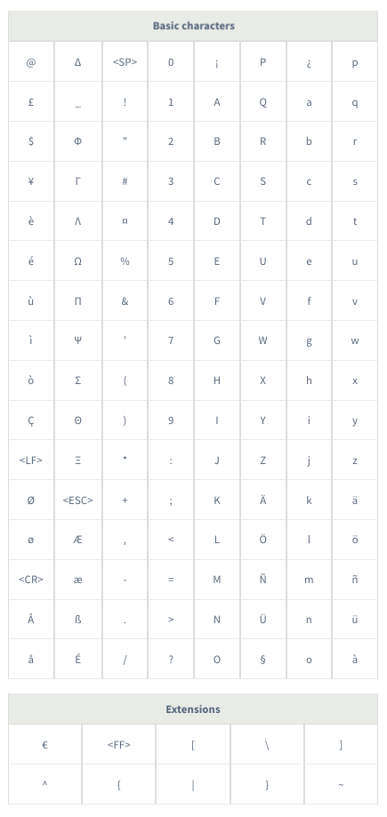

The two tables below list the authorised characters for 7bit encoding. The characters in the "Extensions" table count as double.
The maximum size of an SMS message is 160 characters in 7bit encoding (GSM 03.38 standard).
If you use characters that do not appear in these tables, the encoding will switch to Unicode, reducing the maximum size of an SMS message to 70 characters.
List of authorised SMS characters
