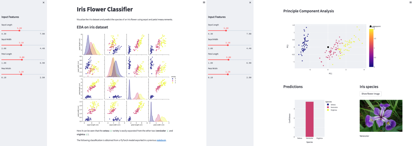

Create the Streamlit application
Two Python files are created for the purpose of loading the PyTorch model and building the Streamlit app.

Write the app.py file
Load the IRIS dataset for EDA.
@st.cache
def load_data():
    # load the iris dataset with sklearn
    dataset_iris = load_iris()
    # define inputs and output
    df_inputs = pd.DataFrame(dataset_iris.data, columns=dataset_iris.feature_names)
    df_output = pd.DataFrame(dataset_iris.target, columns=['variety'])
    return df_inputs, df_output
Display EDA figure based on source dataset.
@st.cache(allow_output_mutation=True)
def data_visualization(df_inputs, df_output):
    df = pd.concat([df_inputs, df_output['variety']], axis=1)
    eda = sns.pairplot(data=df, hue="variety", palette=['#0D0888', '#CB4779', '#F0F922'])
    return eda
Create a sidebar with sliders.
def create_slider(df_inputs):
    # slidebars with min, max and mean (by default) values
    sepal_length = st.sidebar.slider(
        label='Sepal Length',
        min_value=float(df_inputs['sepal length (cm)'].min()),
        max_value=float(df_inputs['sepal length (cm)'].max()),
        value=float(round(df_inputs['sepal length (cm)'].mean(), 1)),
        step=0.1)
    sepal_width = st.sidebar.slider(
        label='Sepal Width',
        min_value=float(df_inputs['sepal width (cm)'].min()),
        max_value=float(df_inputs['sepal width (cm)'].max()),
        value=float(round(df_inputs['sepal width (cm)'].mean(), 1)),
        step=0.1)
    petal_length = st.sidebar.slider(
        label='Petal Length',
        min_value=float(df_inputs['petal length (cm)'].min()),
        max_value=float(df_inputs['petal length (cm)'].max()),
        value=float(round(df_inputs['petal length (cm)'].mean(), 1)),
        step=0.1)
    petal_width = st.sidebar.slider(
        label='Petal Width',
        min_value=float(df_inputs['petal width (cm)'].min()),
        max_value=float(df_inputs['petal width (cm)'].max()),
        value=float(round(df_inputs['petal width (cm)'].mean(), 1)),
        step=0.1)
    return sepal_length, sepal_width, petal_length, petal_width
Run a PCA.
@st.cache
def run_pca():
    pca = PCA(2)
    X = df_inputs.iloc[:, :4]
    X_pca = pca.fit_transform(X)
    df_pca = pd.DataFrame(pca.transform(X))
    df_pca.columns = ['PC1', 'PC2']
    df_pca = pd.concat([df_pca, df_output['variety']], axis=1)
    return pca, df_pca
Create a function that filters out negative values from the dataframe. Only positive values in the dataframe are kept. If a value is negative, it is set to zero.
def extract_positive_value(prediction):
    # f(prediction) = max(0, prediction)
    prediction_positive = []
    for p in prediction:
        if p < 0:
            p = 0
        prediction_positive.append(p)
    return pd.DataFrame({'Species': ['Setosa', 'Versicolor', 'Virginica'], 'Confidence': prediction_positive})
Define a Python function to display image according to Iris species.
def display_img(species):
    # define the list of images
    list_img = ['setosa.png', 'versicolor.png', 'virginica.png']
    return Image.open(list_img[species])
All the functions defined above are called in the main Python file app.py to build the Streamlit app. You can find this part of the code as well as the different functions defined previously on the GitHub repository.
