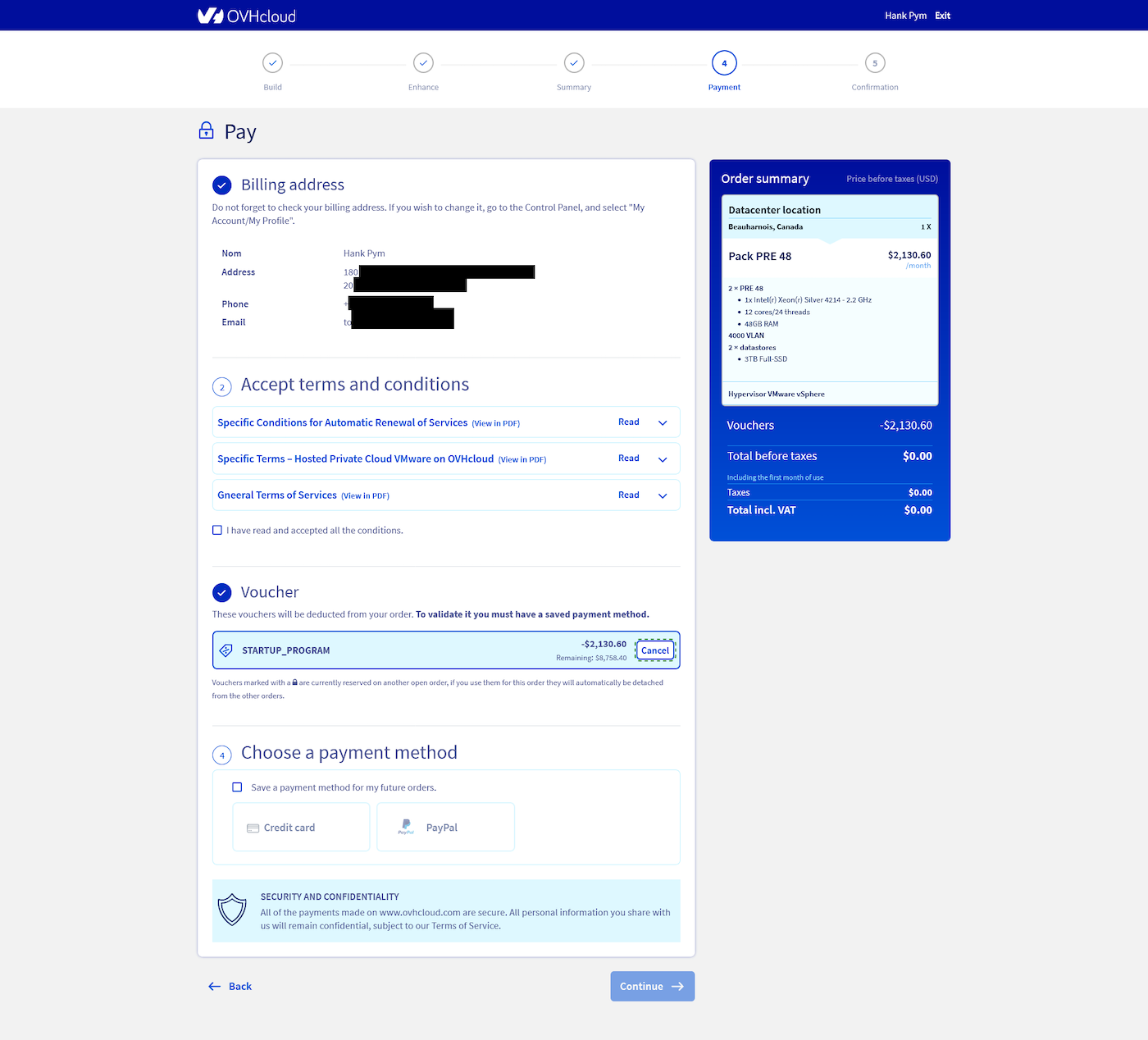

Select the payment method:
At the end of the order, when prompted to choose a payment method, go to the Voucher section.
Select the STARTUP_PROGRAM voucher by clicking Apply.
Add or select a payment method to cover the cost of non-eligible products using the voucher.
Proceed to payment: Click Pay to finalize the order using your credits.
