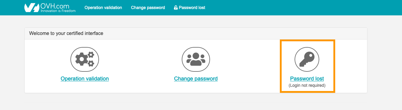

Access the service’s secure interface, e.g.: https://pcc-192-0-2-1.ovh.com/secure/ (be careful not to forget the final “/” of the address).
Click the Password lost button.
Password lost

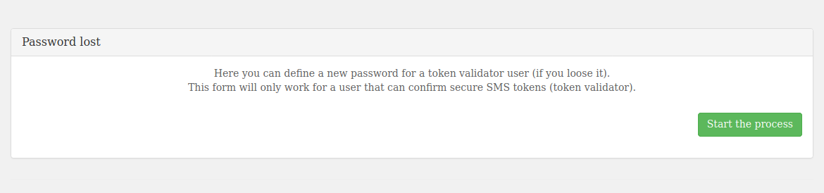

A message indicates that you must be able to receive SMS messages to continue. Click start the process.
Launching the process

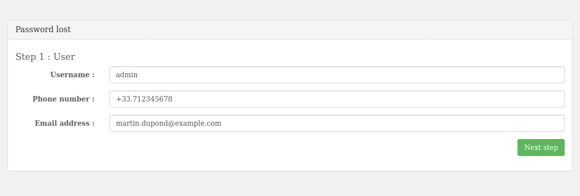

Enter the information requested for the admin account (it must be the same as the information previously added in the Control Panel) and click Next step.
User information

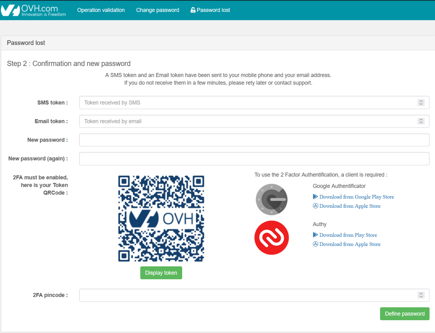

Within the interface, you will then need to:
  • Enter the code received via SMS.
  • Enter the code received by email.
  • Enter a new password.
  • Confirm it.
  • Scan the QRcode with your preferred authentication application.
  • Enter the code you have retrieved.
Finally, click the Define password button.
User information
