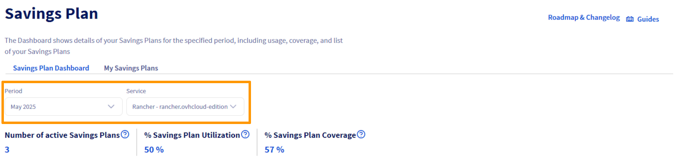

Use the dashboard to analyse your Savings Plans
The Savings Plans dashboard allows you to track and analyse your Savings Plans, providing essential information about their usage and coverage. You can view specific data by period and service.
a. Selection filtersDashboard focus on filters
  • Service: Allows you to filter the specific service the Savings Plans are associated with.
  • Period: Allows you to select a specific period to observe the use of Savings Plans and the associated coverage.

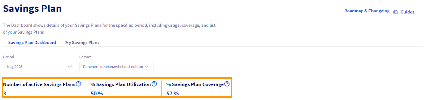

b. Savings Plan indicators
The indicators displayed in the Savings Plans dashboard are adjusted according to the filters applied. This makes it possible to customise the display of indicators to focus on specific periods, particular services or selected instance types.
Only data from the last 6 months are available.
Dashboard focus on kpi
  • Number of active Savings Plans: Total number of your Savings Plans active on the last day of the given period for the selected resource.
  • % Savings Plan Utilization: Average use of your Savings Plans (over the selected period for the selected resource). For example, if you used 8 instances and your Savings Plans cover 10, the utilization rate would be 80%.
  • % Savings Plan Coverage: Average coverage of your Savings Plans (over the selected period for the selected resource). For example, if you have consumed 10 instances and your Savings Plans cover 8, then your coverage rate is 80%.
If the selected period has already ended (one month before the current one), two additional fields will be available to allow you to view more detailed data:
  • Savings achieved: Total savings (over the selected period for the selected resource).
  • Excess amount: Invoice amount exceeding your Savings Plans configuration (over the selected period for the selected resource).

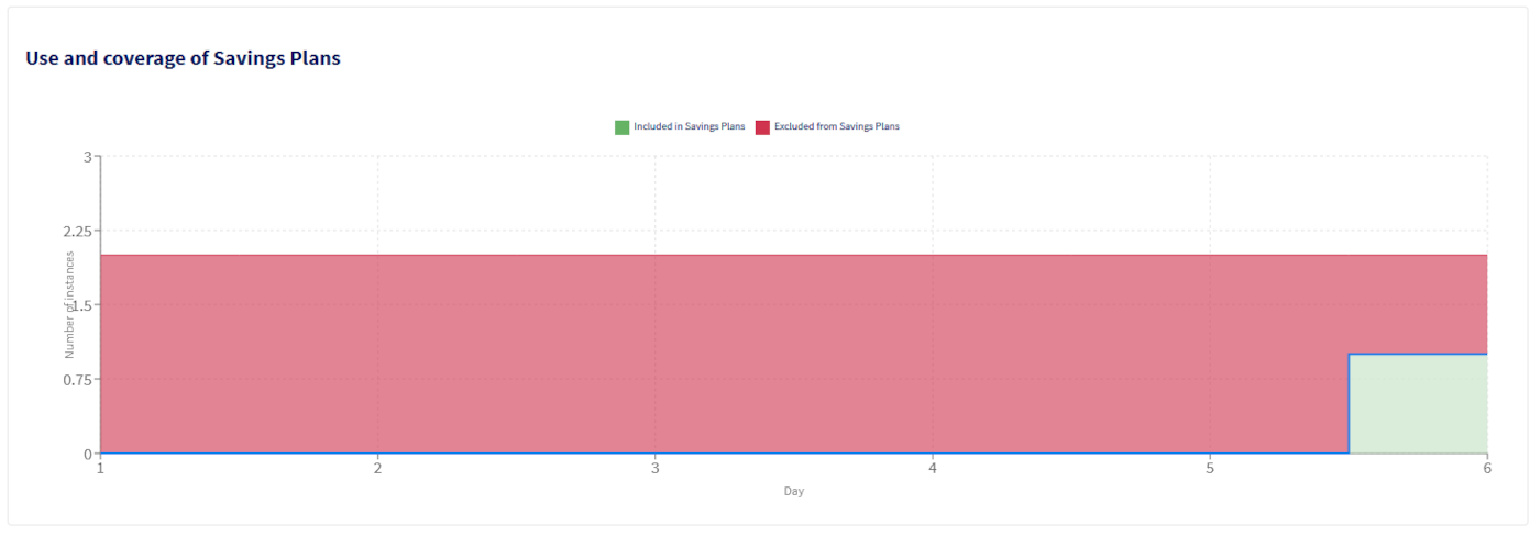

c. Graphics
For a Savings Plan started during the month, days prior to its creation are displayed in red, indicating the absence of coverage.
Dashboard focus on graph
  • Y-axis legend on graph:
    • If ‘Instances’ is selected, the Y axis will display the number of instance(s) used.
    • If ‘Managed Rancher Services’ is selected, the Y axis will display the number of vCPU(s) used.
  • Graph colour legends :
    • Green : Represents the number of resources covered by a Savings Plan.
    • Red : Represents the number of resources not covered by a Savings Plan and billed hourly.

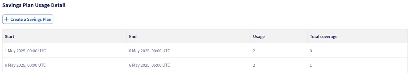

d. Savings Plan Usage DetailDashboard focus on conso
  • Create a Savings Plan: A button to create a new Savings Plan.
Each period in the table corresponds to a change in resource usage, such as the addition or deletion of a resource or Savings Plan.
  • Savings Plan Usage Detail columns:
    • Start: This column shows the start date and time of the resource consumption period.
    • End: This column shows the date and time at which the resource consumption period ends.
    • Usage: Represents the amount of resources consumed during the selected period.
    • Total coverage: Indicates the total of resources covered by your Savings Plans during this period.

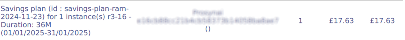

  • a. Billing for your Savings Plans
When you subscribe to a Savings Plan, you agree to pay a fixed amount for a certain number of instances over a specified period. However, the instances covered by this plan are not itemised individually on your bill. On your invoice, you will only see the total amount corresponding to the Savings Plan, and not the specific instances it covers. This simplifies invoicing by showing only one line grouping together all the instances covered by your commitment, without the need to detail each instance.
Billing instances Savings Plan
A pro rata will be applied if your Savings Plan starts during the month.

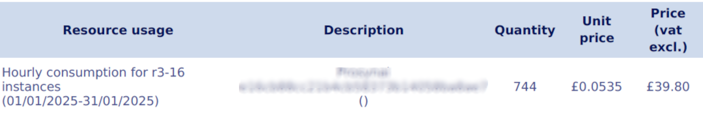

  • b. Billing for your additional instances
Additional instances, i.e. those not covered by your Savings Plan, are billed on an hourly basis, as with standard billing. For example, if you use 10 3rd-generation instances for 10 hours during the month, you will be billed on a per-hour basis. This gives an invoice for 100 hours (10 instances x 10 hours), billed at the standard hourly rate, in addition to the Savings Plan line.

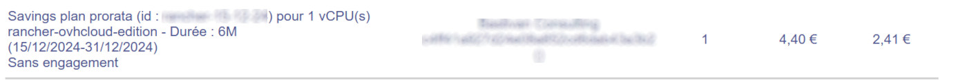

Billing for Rancher Savings Plan

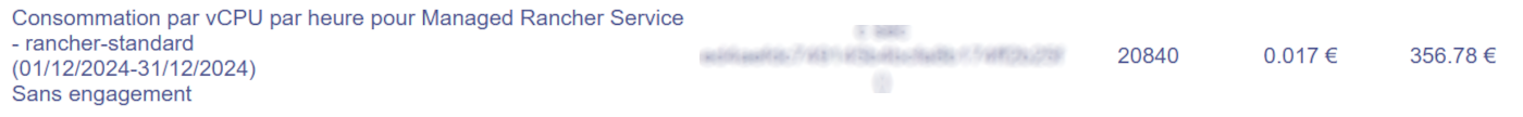

When you subscribe to a Savings Plan, you agree to pay a fixed amount for a certain number of vCPUs over a specified period. However, the vCPUs covered by this plan are not itemised individually on your bill. On your invoice, you will only see the total amount corresponding to the Savings Plan. You won't have details of the different Rancher with the number of vCPUs that cover them belonging to the savings plan.
Billing Rancher Savings Plan
