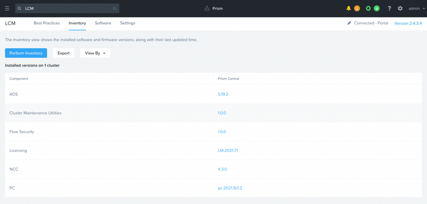

LCM Inventory
As documented in the official upgrade process, you should first launch a LCM Inventory to get a view of the software status of the Nutanix Cluster.
First LCM Inventory

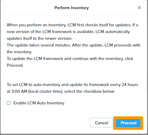

Proceed to run the first or a new Inventory update:
Proceed LCM Inventory

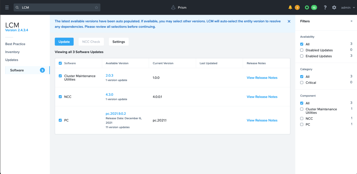

After a pre-check phase, you will receive the results as soon as the inventory is done. The available upgrades will be displayed:
LCM Result Upgrades available
Select the upgrades you want or update all components. You can also decide to manage those upgrades directly as explained in the next two sections.

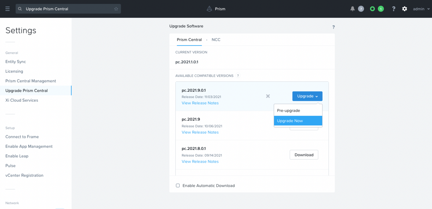

If there are available upgrades, you can select the ones you need to apply, then choose to only do the pre-check or upgrade immediately:
Prism Available upgrade

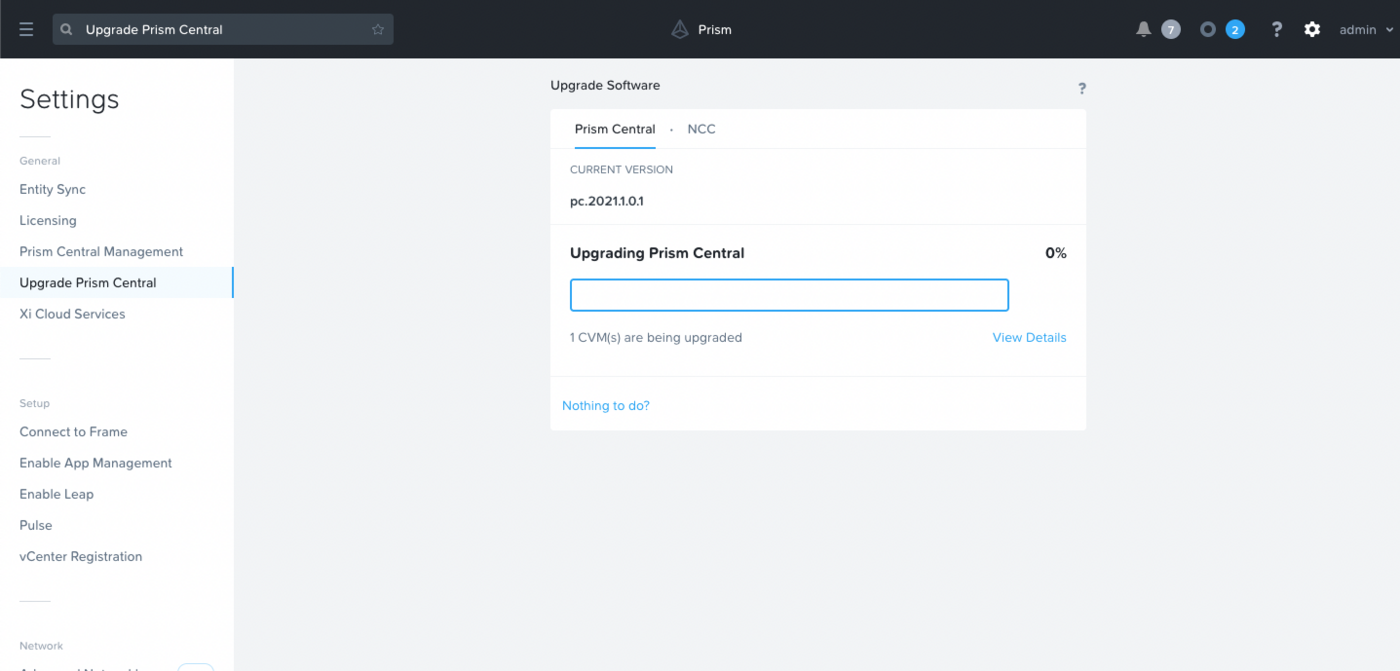

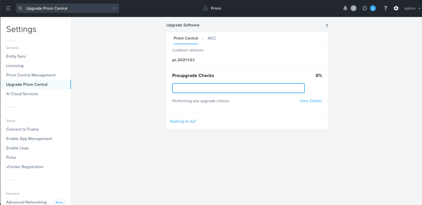

If you have selected the upgrade process, the process itself will be initiated:
Upgrade start

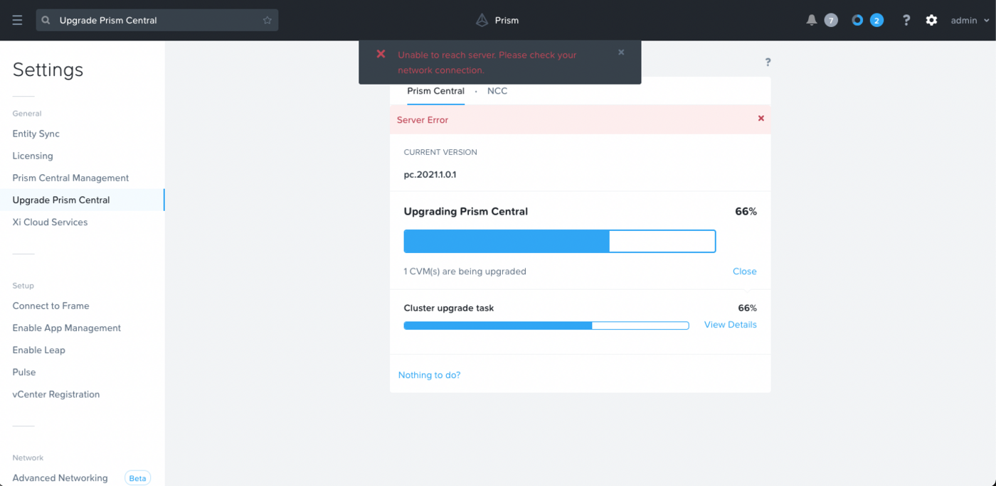

During the execution, you might lose the connection to Prism Central:
Prism disconnection

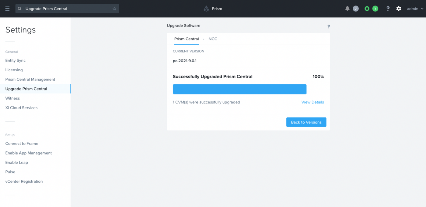

After a few minutes, you can connect back to the Prism Central interface, and you can then check or wait for the end of the upgrade process:
End of upgrade

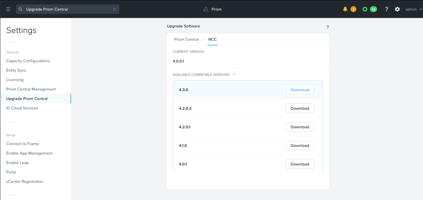

If there is one or more NCC upgrades available, you can download the ones you need and then launch the upgrade:
Select the NCC release

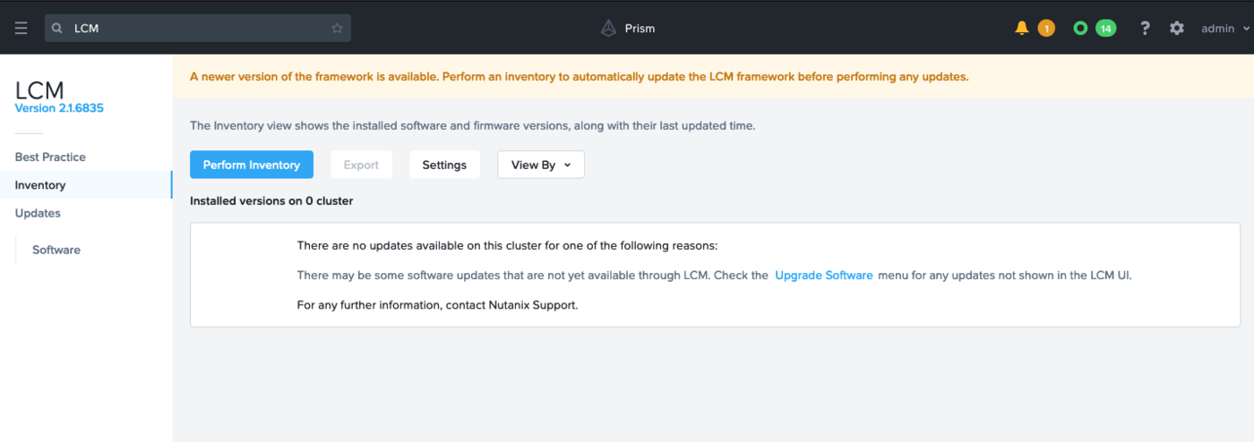

LCM Inventory update
Update the LCM inventory. If no upgrades are available anymore, then only the list of installed software components releases will be presented:
Up-to-date Nutanix cluster

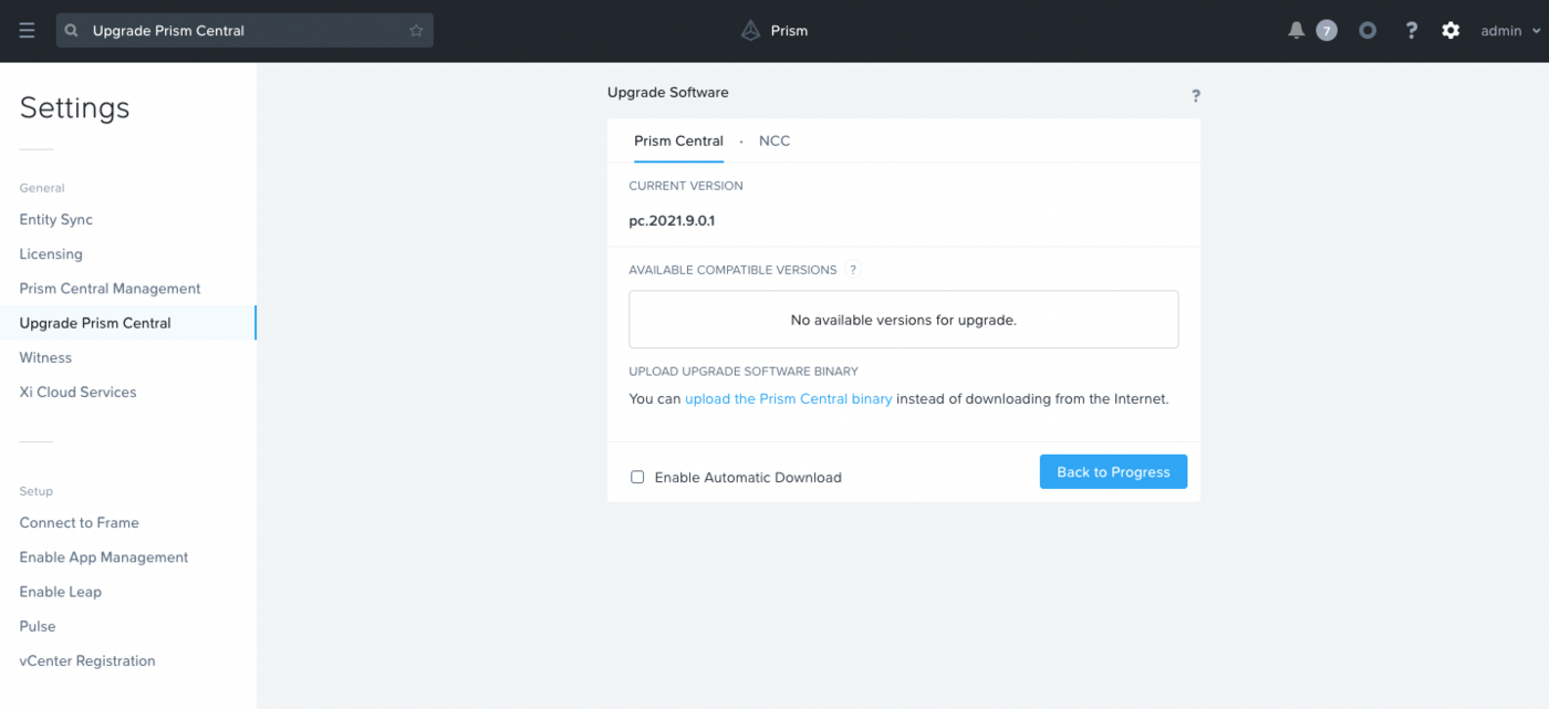

Prism Central upgrade validation
You can also check that the Nutanix Cluster Prism Central is up-to-date if there is no upgrade available for your cluster: Click on the Prism Central Settings and open Upgrade Prism Central. There should be no available versions:
No Prism Central upgrade

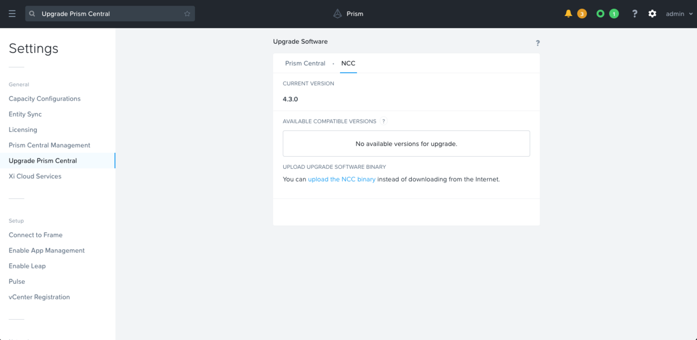

NCC upgrade validation
You can also check that the Nutanix Cluster NCC is up-to-date if there is no upgrade available for your cluster: Click on the Prism Central Settings and open Upgrade Prism Central. There should be no available versions in the NCC tab:
No NCC upgrade

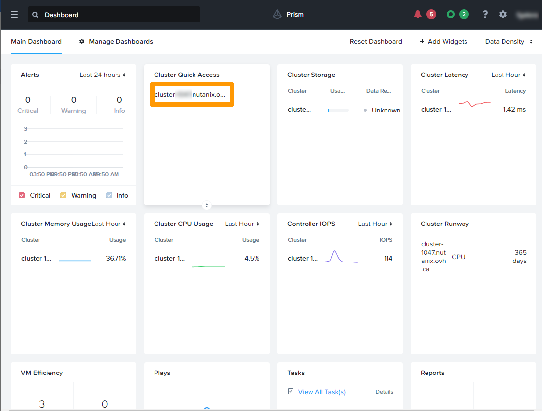

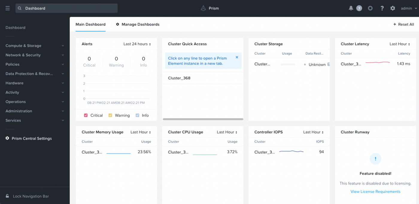

From the Prism Central dashboard, in the Cluster Quick Access frame, click your cluster.
Upgrade Prism Element 01

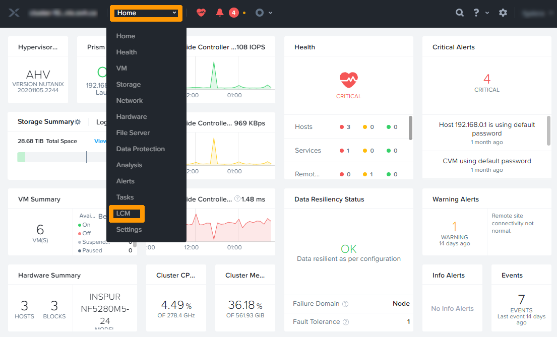

Open the Menu and click on LCM.
Upgrade Prism Element 02

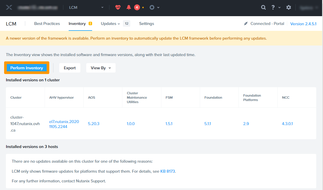

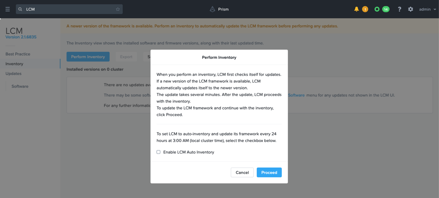

Click the Perform Inventory button.
Upgrade Prism Element 03

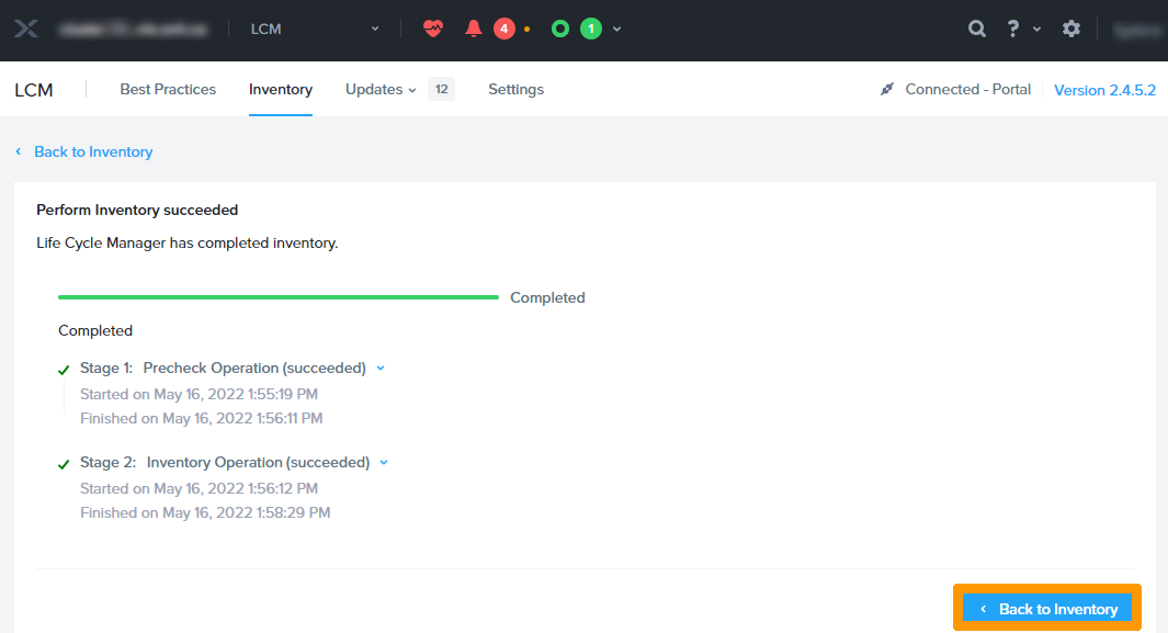

Click Proceed.
Upgrade Prism Element 04
Click Back to Inventory.
Upgrade Prism Element 05

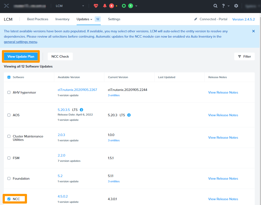

First, we will update NCC.
Check NCC and click View Update Plan.
Upgrade Prism Element 06

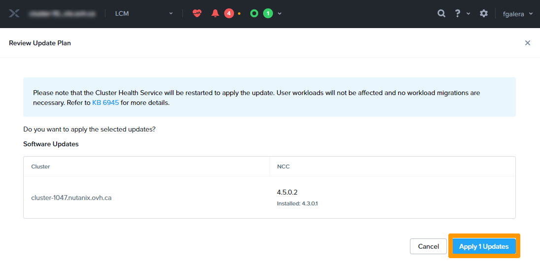

Click Apply 1 Updates.

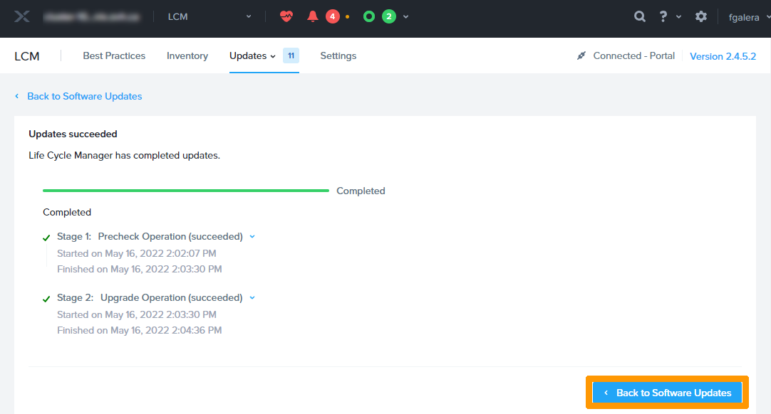

Click Back to Software Updates.
Upgrade Prism Element 08

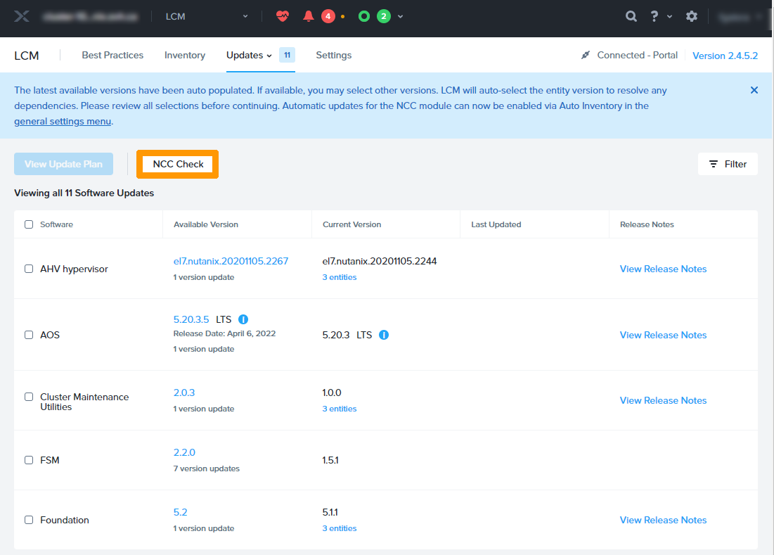

Click NCC Check to check the system before major updates.
Upgrade Prism Element 09

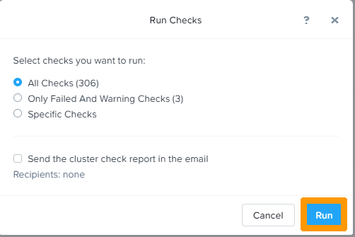

Leave All Checks and click Run.
Upgrade Prism Element 10

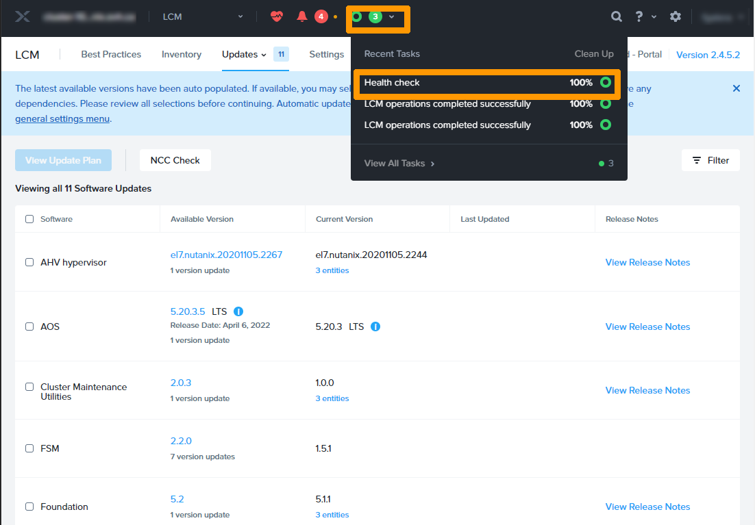

Wait for the Health check task to complete. You can view it in the Tasks menu.

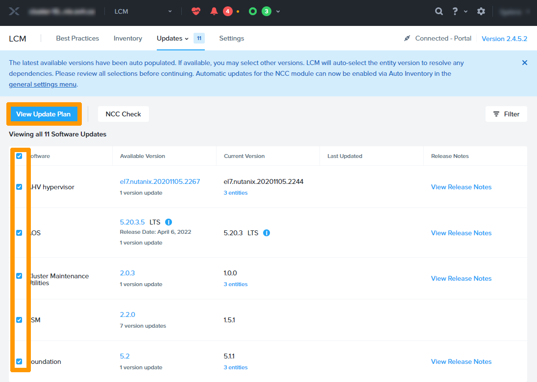

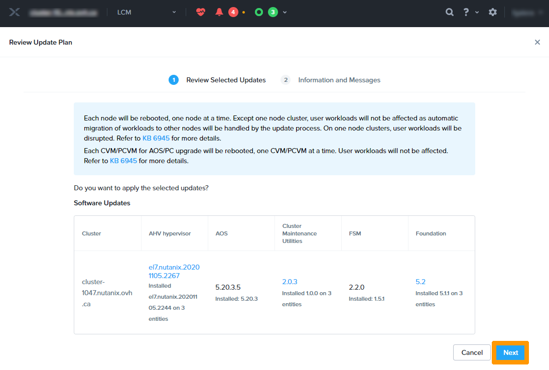

Select all available updates and click View Update Plan.
Upgrade Prism Element 12
Click Next.
Upgrade Prism Element 13

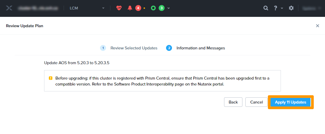

Click Apply N Updates.
Upgrade Prism Element 14
