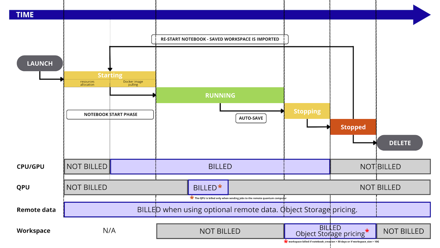

Here is a detailed graph that illustrates every step that is billed or not during the Quantum Notebooks workflow:
When your program needs to access to the remote QPU, QPU time is charged by the second. You will only be charged for your QPU usage time.
Rates for compute are mentioned per hour to facilitate reading of the prices, but the billing granularity remains per minute.
As stated above and shown in the image above, you pay for these resources as long as you consume them. This happens when the image of your notebook is pulled, during the STARTING phase, but also during RUNNING and STOPPING phases, until you reach the STOPPED phase.
