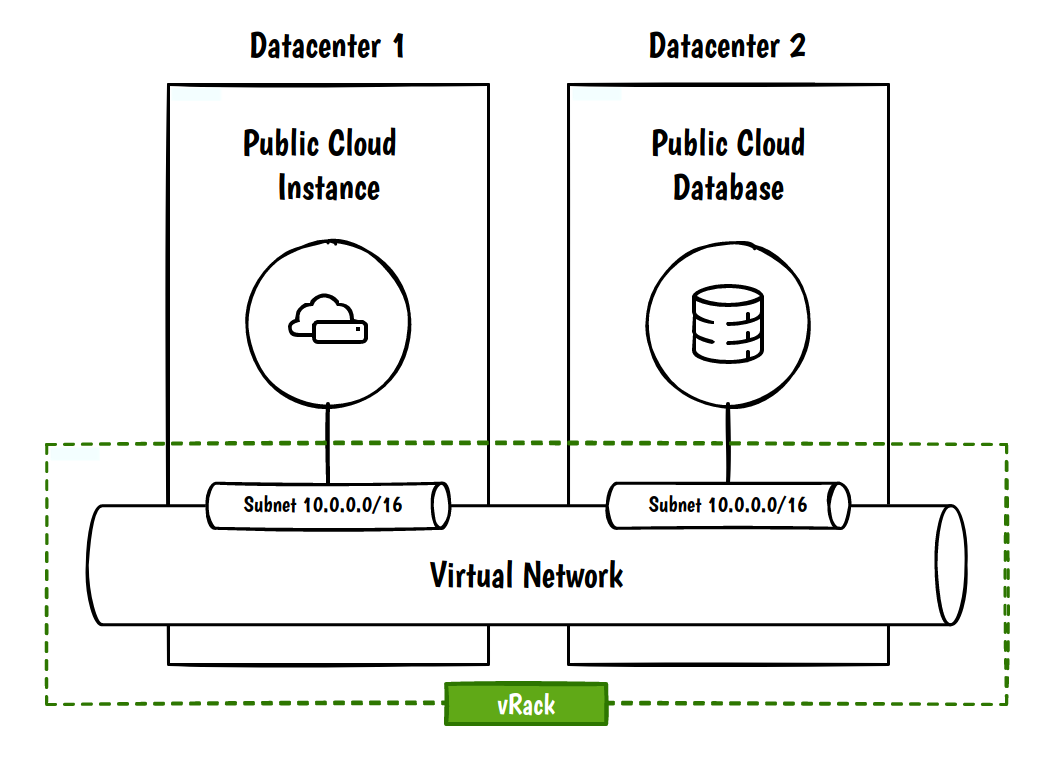

This guide explains how to connect a Public Cloud Instance, hosted in a datacenter, to a Public Cloud Database, hosted in another datacenter, like this:
Here are some considerations to take into account when using private network:
Network ports are created in the private network of your choice. Thus, further operations on that network might be restricted - e.g. you won't be able to delete the network if you didn't stop the Public Cloud Databases services first.
When connecting from an outside subnet, the Openstack IP gateway must be enabled in the subnet used for the Database service. The customer is responsible for any other custom network setup.
Subnet sizing should include considerations for service nodes, other co-located services within the same subnet, and an allocation of additional available IP addresses for maintenance purposes. Failure to adequately size subnets could result in operational challenges and the malfunctioning of services.
OpenStack subnets routes announcement will not be applied to your services.

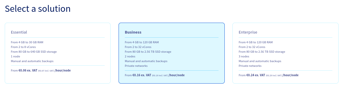

Step 2 - Creating a Public Cloud Database connected to the private network
Follow this guide to create a new Public Cloud Database.
INFO
Choose the plan that best fits your needs. The use of private networking with databases is available with all plans.

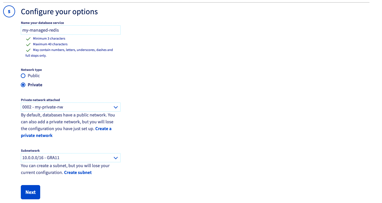

INFO
Select Private from the Network Type list, then select XXXX - my-private-nw.
The XXX value is the ID of the vRack.
From the Subnetwork list, select the 10.0.0.0/16 - YYY.
The YYY value is the name of the datacenter you chose.

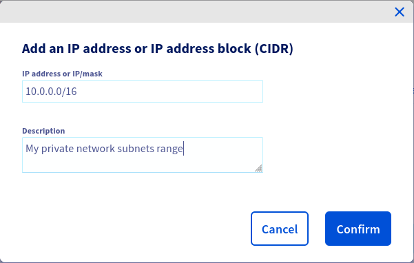

Step 3 - Configure your Public Cloud database instance to accept incoming connections
Follow the Configure your <database> instance to accept incoming connections guide of your selected database type available here to configure your service after installation.
INFO
Authorize the whole private network, as defined on previous steps.
The database is now connected to the virtual network, we can use it from any component that is connected to the same vRack.

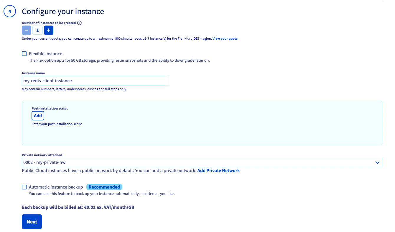

Step 4 - Adding a Public Cloud Instance to the vRack
Follow this guide to create a new Public Cloud Instance
INFO
At the fourth step, select the desired virtual network XXXX - my-private-network.
