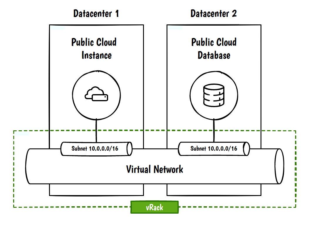

This guide explains how to connect a Public Cloud Instance, hosted in a datacenter, to a Public Cloud Database, hosted in another datacenter, like this:

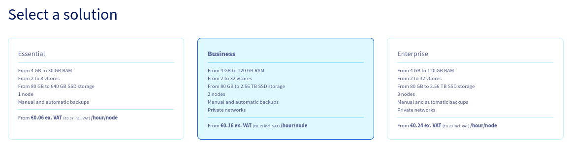

Choose the plan that best fits your needs. The use of private networking with databases is available with all plans.

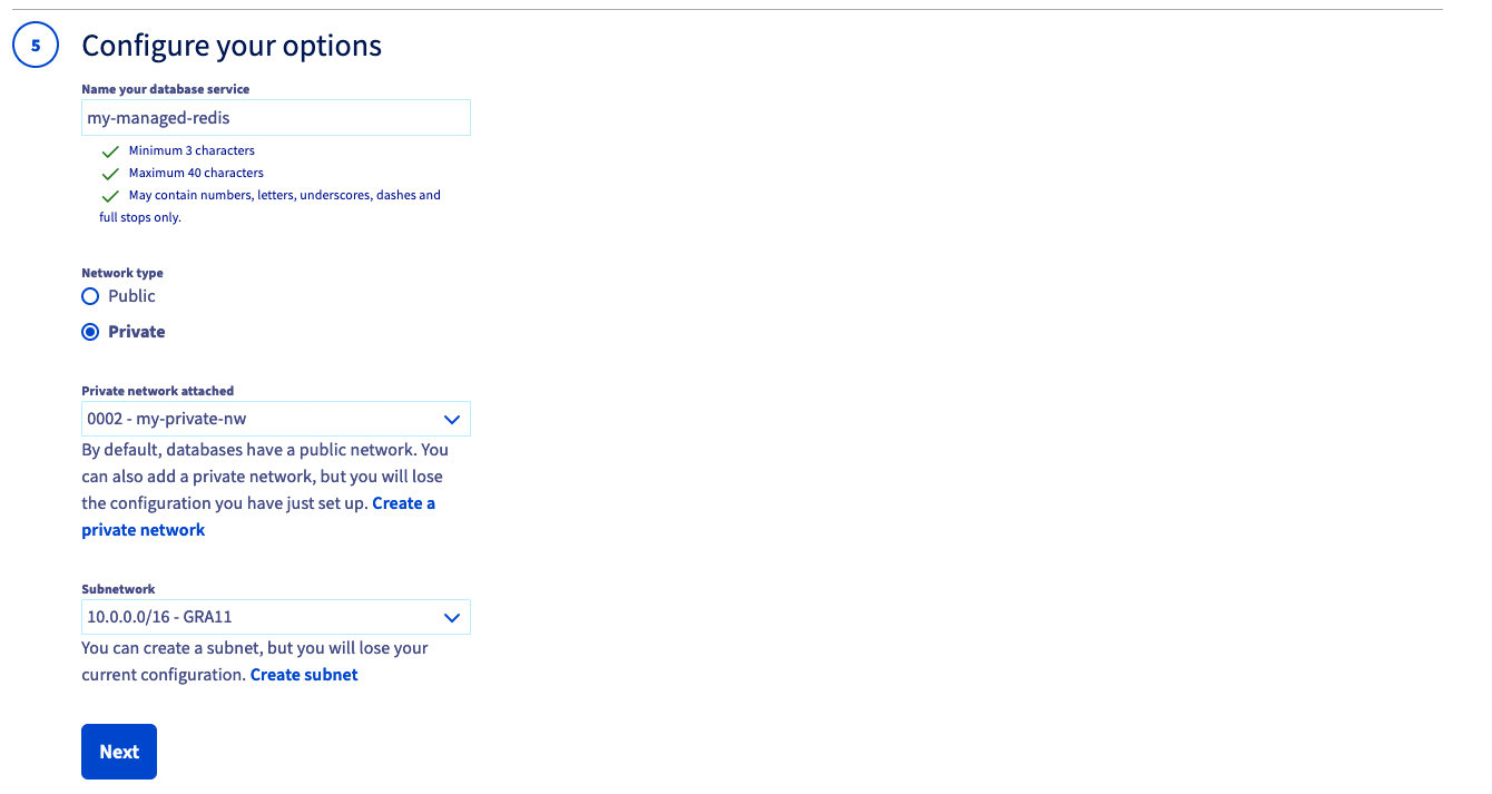

Select Private from the Network Type list, then select XXXX - my-private-nw.
The XXX value is the ID of the vRack.
From the Subnetwork list, select the 10.0.0.0/16 - YYY.
The YYY value is the name of the datacenter you chose.

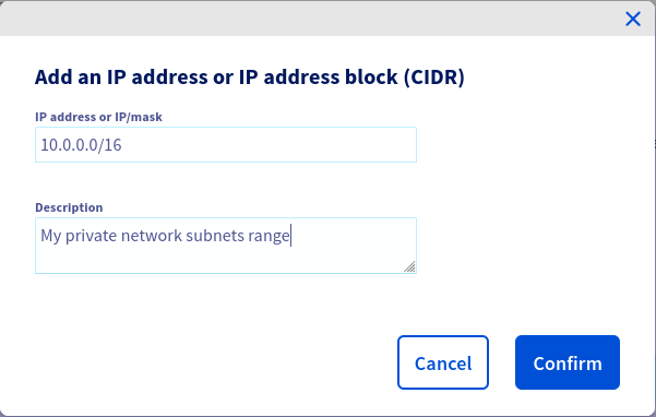

Step 3 - Configure your Public Cloud database instance to accept incoming connections
Follow the Configure your <database> instance to accept incoming connections guide of your selected database type available here to configure your service after installation.
INFO
Authorize the whole private network, as defined on previous steps.
The database is now connected to the virtual network, we can use it from any component that is connected to the same vRack.

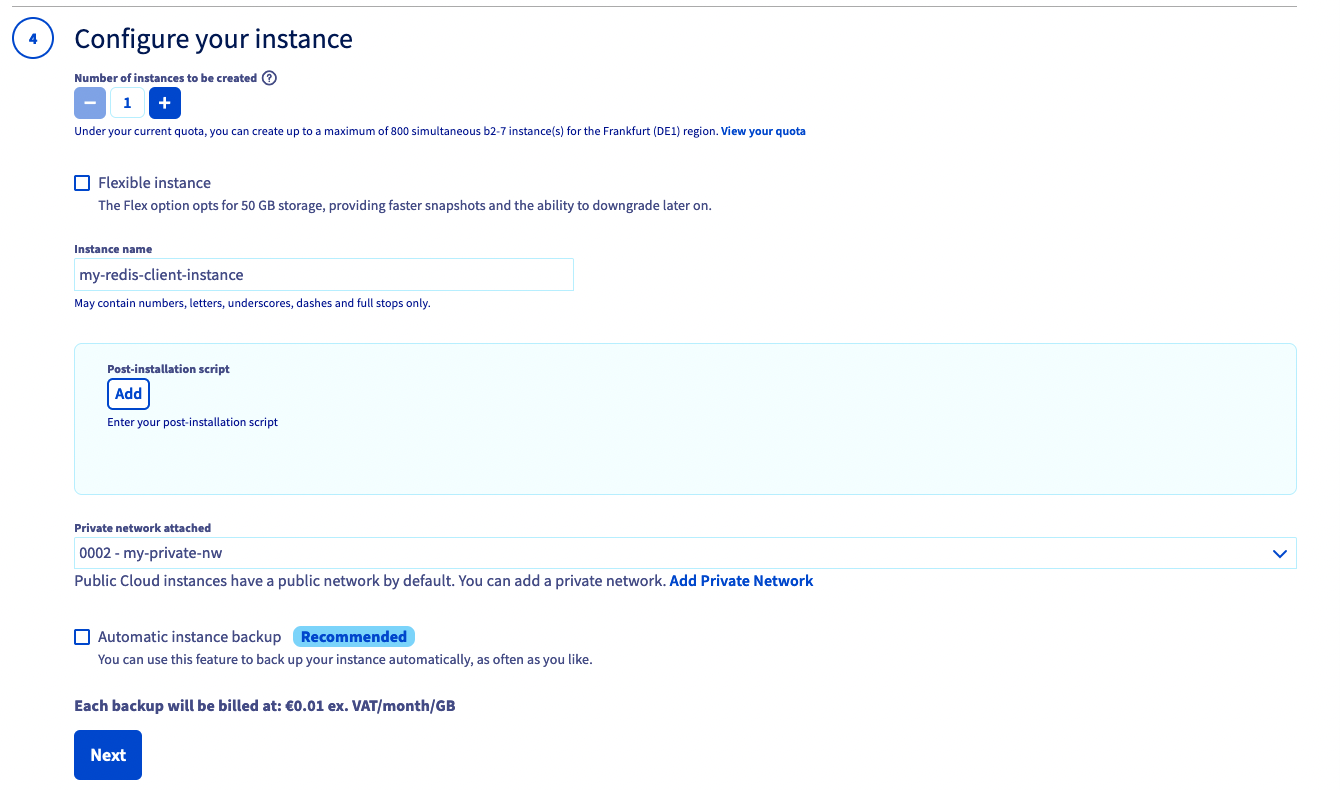

Step 4 - Adding a Public Cloud Instance to the vRack
Follow this guide to create a new Public Cloud Instance
INFO
At the fourth step, select the desired virtual network XXXX - my-private-network.
INFO
If you want to test the access from an existing instance, read this tutorial to connect it to the vRack: Configuring vRack for Public Cloud.
