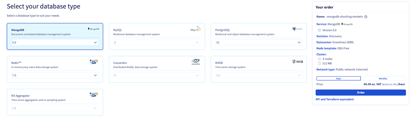

Step 1: Select your database type
Click on the type of database you want to use and then select the version to install from the respective drop-down menu.

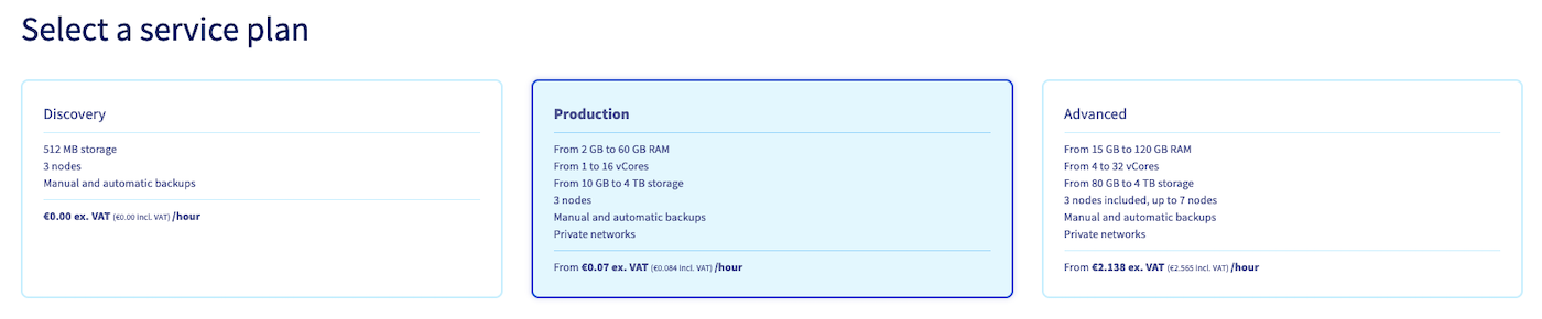

Step 2: Select a Plan
Choose an appropriate service plan. You will be able to upgrade the plan after creation.
Please visit the capabilities page of your selected database type for detailed information on each plan's properties.

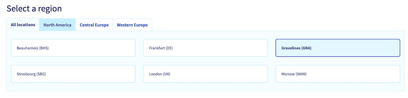

Step 3: Select a location
Choose the geographical region of the data centre in which your database will be hosted.

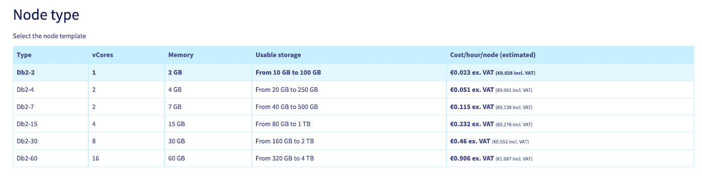

Step 4: Configure database nodes
You can choose the node template in this step.
Please visit the capabilities page of your selected database type for detailed information on the hardware resources and other properties of the database installation.
Take note of the pricing information.

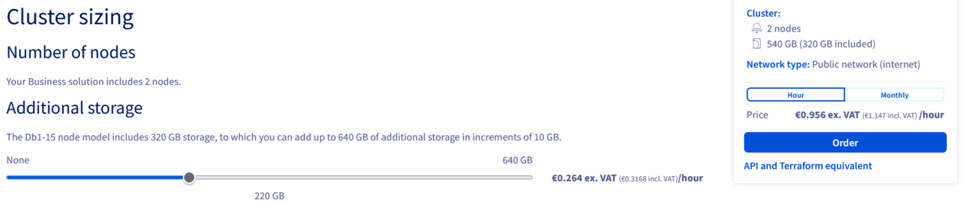

Step 5: Sizing
Additional storage can be ordered and, depending on the engine, the number of nodes in your cluster can be adjusted:

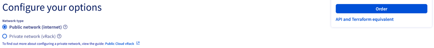

Step 6: Configure your options
Define your network configuration:

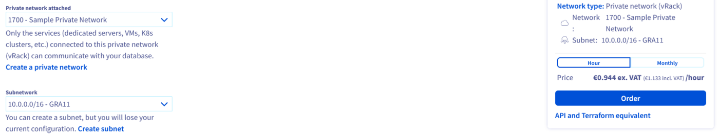

Connecting a private network (optional)
If you already have a private subnet available, check the box Private and select it from the drop-down menu. Note that this option might not be available for the selected service type.
You can be forwarded to create a private network or subnet by clicking on the respective links. You will have to start the database order process anew in that case.
Please follow this guide for detailed instructions.

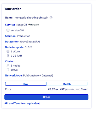

Step 7: Summary and confirmation
The final section will display a summary of your order as well as the API equivalent of creating this database instance with the OVHcloud API.
Within a few minutes your new database service will be deployed. Messages in the OVHcloud Control Panel will inform you when the database is ready to use.
