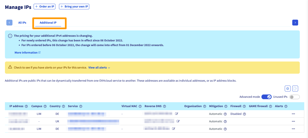

Log in to the , open the Network menu in the left-hand sidebar and click Public IP Addresses.
Click the Additional IP tab.
Add a virtual MAC (1)

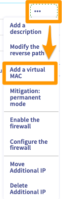

Next, locate your Additional IP address in the table and click the ... button to open the menu. Select Add a virtual MAC.

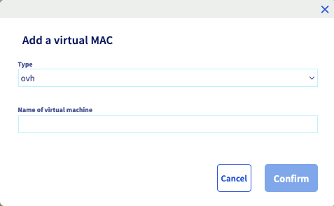

Select ovh from the Type dropdown box, type a name in the Name of virtual machine field, and then confirm your options.
Add a virtual MAC (2)

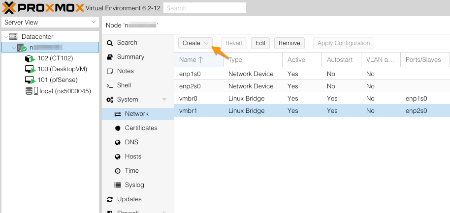

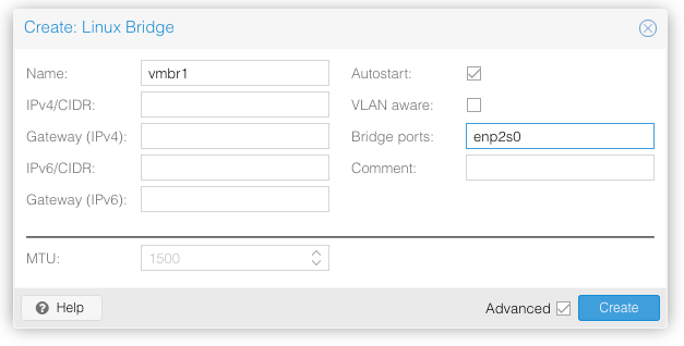

Since pfSense or most routers require two network interfaces to separate the public and private network, it'll be necessary to have two bridge interfaces on your hypervisor. In this demonstration we're using Proxmox VE 6.
In this example, we have two interfaces enp1s0 and enp2s0 but the interface enp1s0 is already bridged with the interface with vmbr0. So we will need to make an additional bridge interface vmbr1 with enp2s0:
New bridge 1
New bridge 2
Note that if your server doesn't have a second network interface, it's not necessary to bridge it to an interface, the bridge will work fine but would only be able to route internally on the server. Using an interface on a network bridge can allow you to route to other virtual machines, dedicated servers, Public Cloud instances and even Hosted Private Cloud infrastructures using vRack.

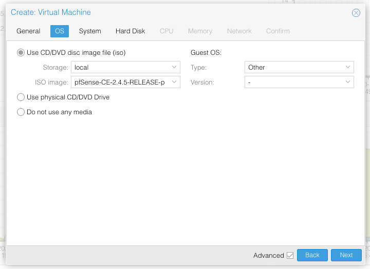

  • Under the OS tab, choose: Other OS type
  • Under the Hard Disk tab, Bus/Device should be: VirtIO

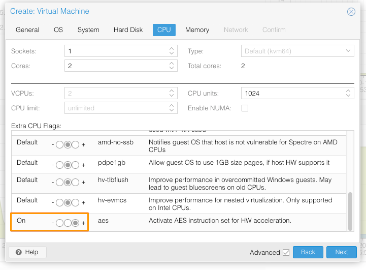

  • If your CPU has the AES instruction set, this should be enabled
New vm 1
If your CPU has the AES instruction set, it must be enabled (from the CPU tab)

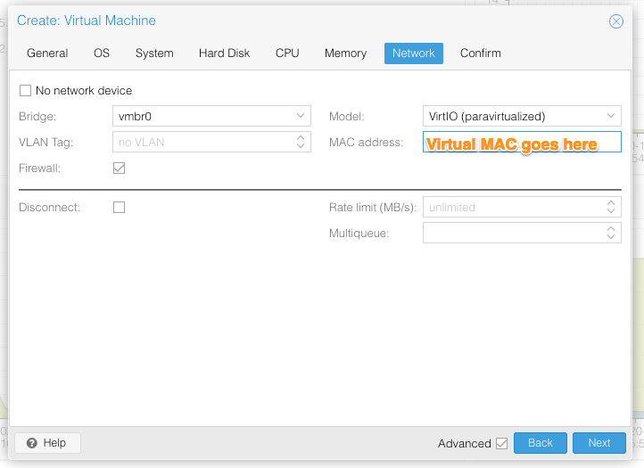

When you're at the Network tab of creating the virtual machine, make sure you enter the Virtual MAC address that is created in the OVHcloud Control Panel.
New vm 3

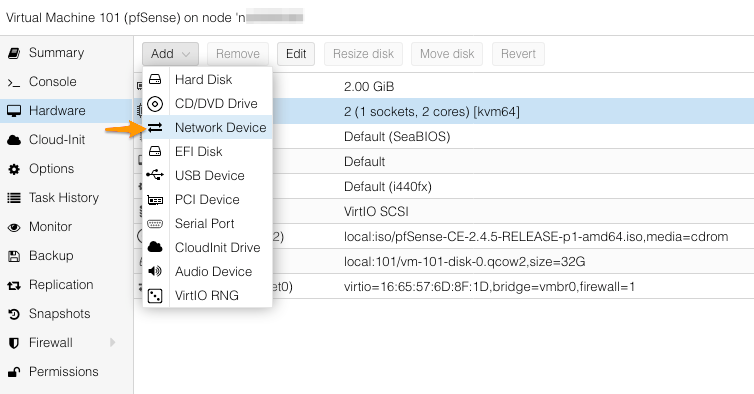

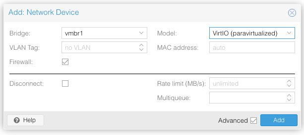

After creating the virtual machine, you'll need to make sure that a second network interface is created on your second bridge interface:
New vm 3
New vm 4

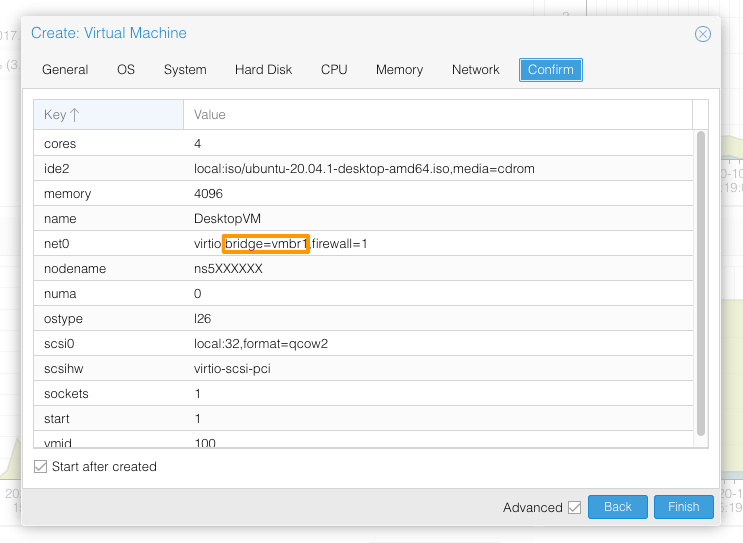

Since some of the settings on pfSense are accessible using its web GUI, the easy way would be to set up a virtual desktop. In this demonstration, we're using an Ubuntu 20.04 ISO. When creating the virtual desktop, make sure the bridge interface being chosen is the secondary one and not the bridge interface to your public network.
New vm 5

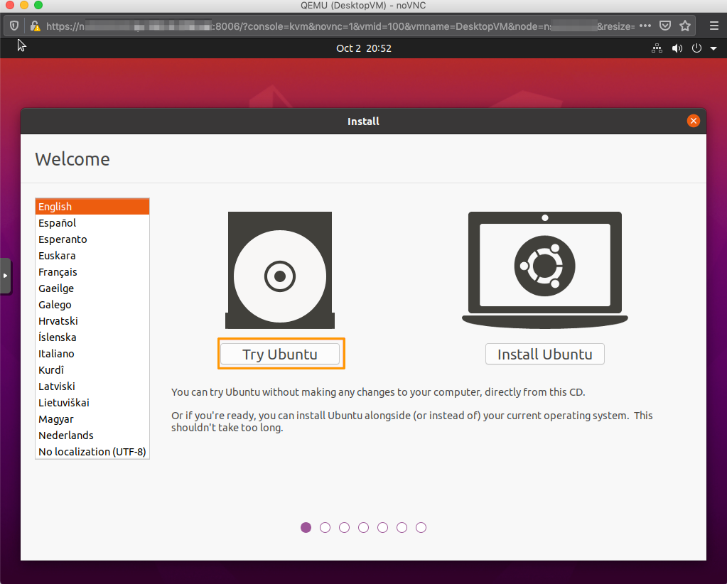

We'll be starting the virtual desktop before starting up the pfSense virtual machine. For the demonstration, we'll just select Try Ubuntu just to start working on pfSense, might install later.

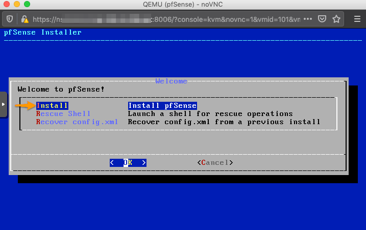

We'll now be starting the pfSense virtual machine and proceeding with the OS installation.

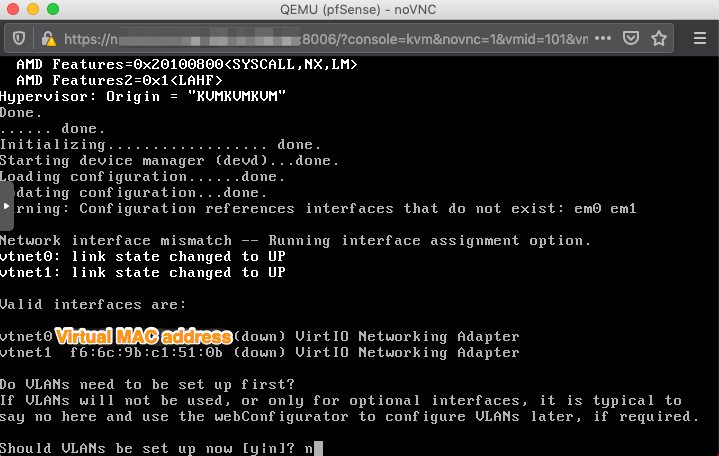

pfSense setup 1
After the OS installation is completed, first thing pfSense will ask is setting up VLANs. Since pfSense is being installed into a hypervisor, we wouldn't suggest configuring it on the virtual machine but if you need VLANs, this should be done on the virtual interface at the hypervisor level.
pfSense setup 2

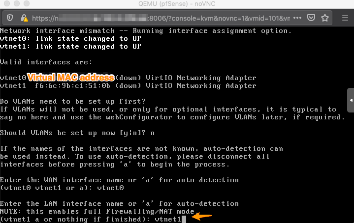

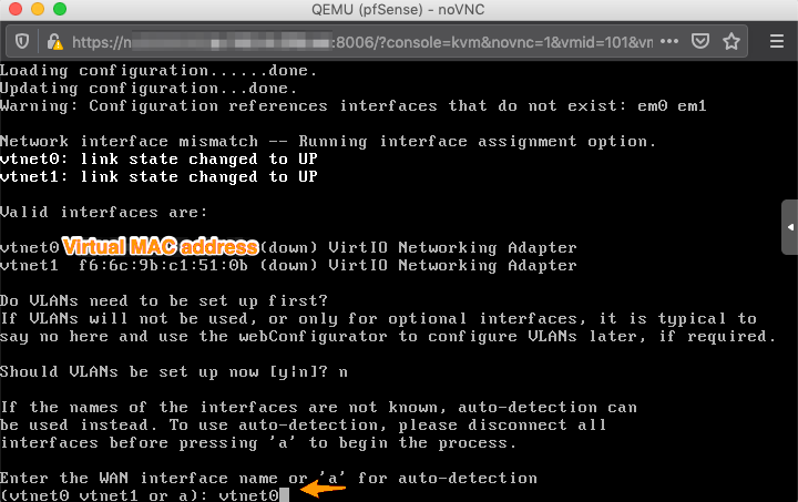

Next step is choosing which interface will be your WAN and which will be your LAN. We'll be able to see which should be the WAN by seeing that it has the virtual MAC address that was created in the OVHcloud Control Panel.
pfSense setup 3
pfSense setup 4
This example we chose vtnet0 as our WAN and vtnet1 as our LAN. After this step, pfSense will ask if you'd like to proceed and confirm which interface is WAN and LAN. After confirming, it'll automatically configure 192.168.1.1 on its LAN interface.

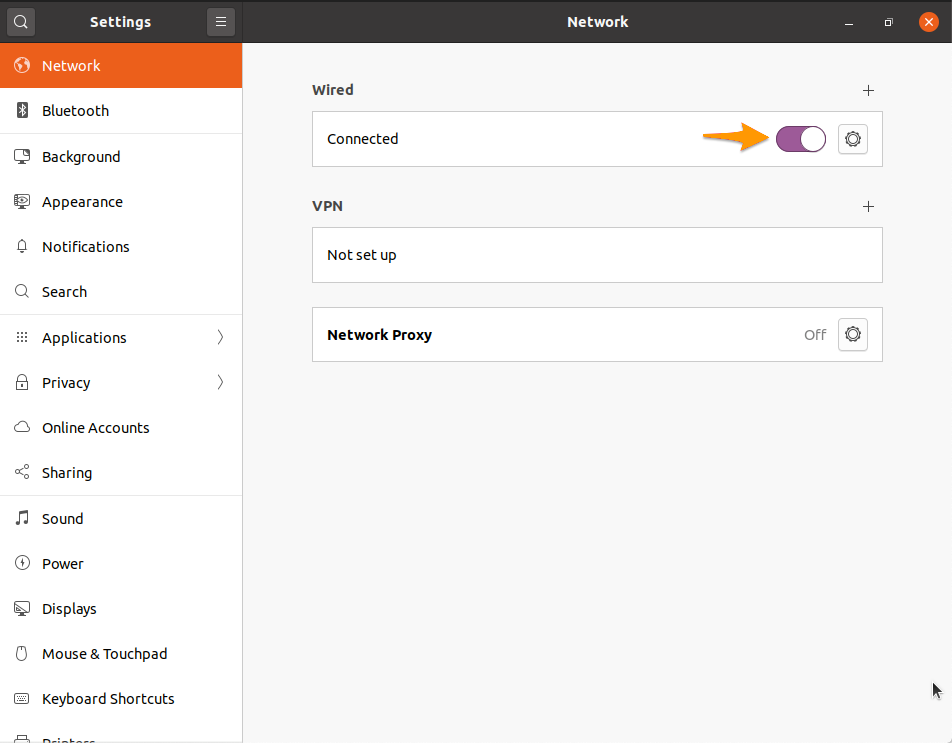

Now that there's a private IP assigned to the LAN interface of our pfSense virtual machine, we're going to go ahead and make a DHCP request so we can access the pfSense web GUI.

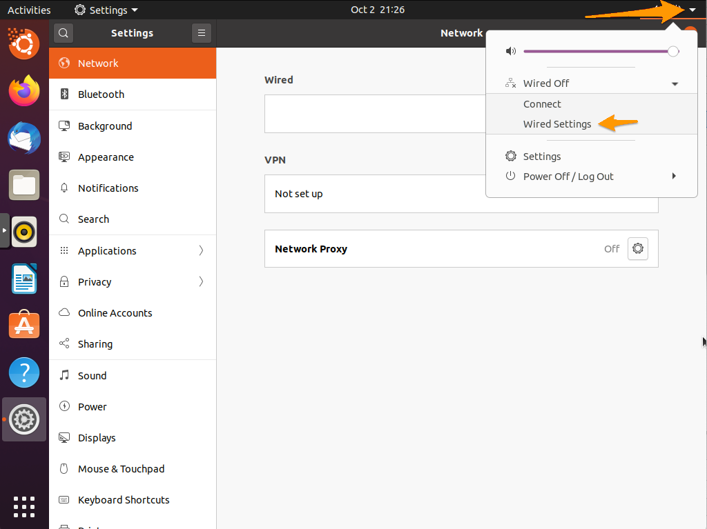

Go to the Wired settings on the Ubuntu VM.
desktop net enable 1
Now we enable the network, if it was already enabled simple disable then enable it again.
desktop net enable 2

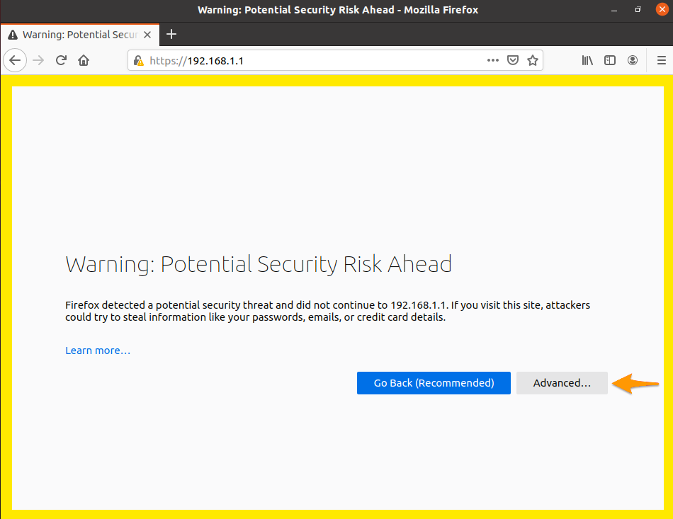

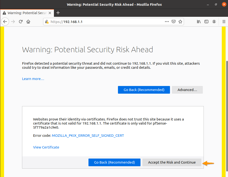

Open a web browser and enter 192.168.1.1 into the URL, there will be a security warning about the interface but it's not something to be concerned about. Be sure to open advanced select Accept and Continue.
desktop pfsense access 1

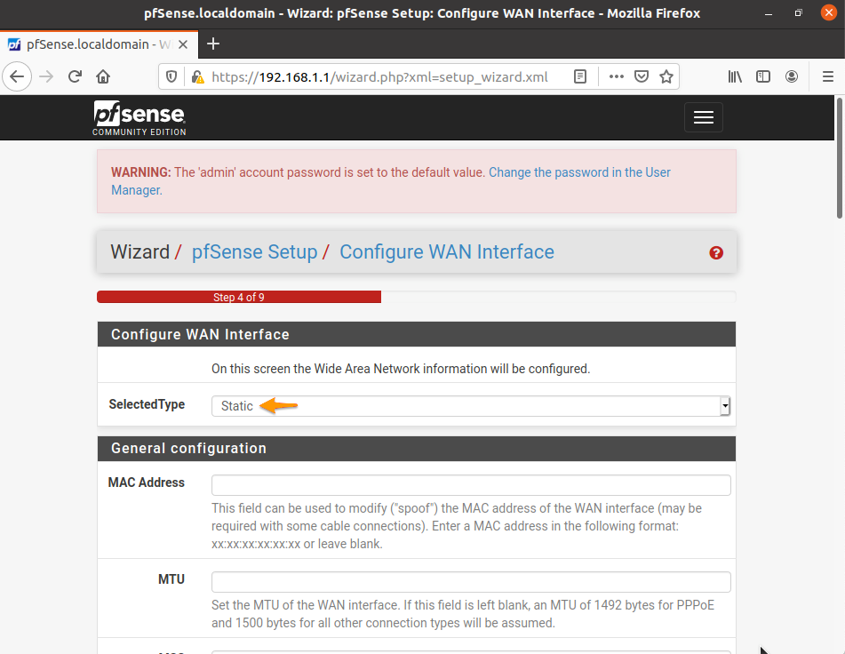

Default username and password should be admin as the username and pfsense as the password, be sure to login. We'll now be going through the general setup, the important thing to do would be to set SelectedType as Static under Configure WAN Interface, this would be at step 4 of 9. All the other settings shouldn't be changed with the exception of the DNS can be up to you but in this use case we had put 213.186.33.99 since it's our resolver within our network.

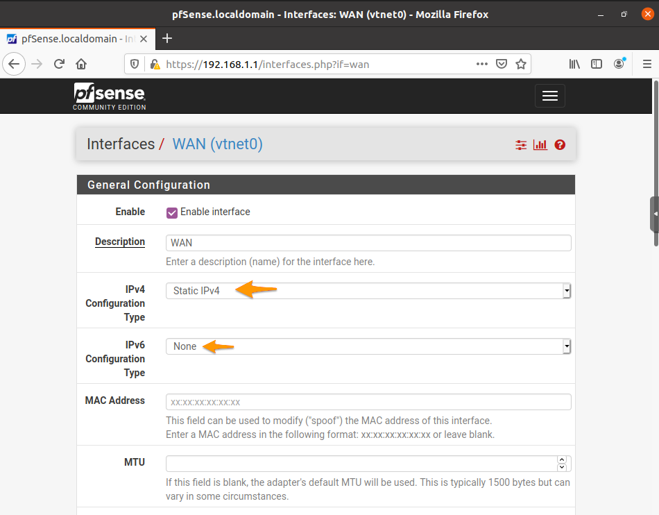

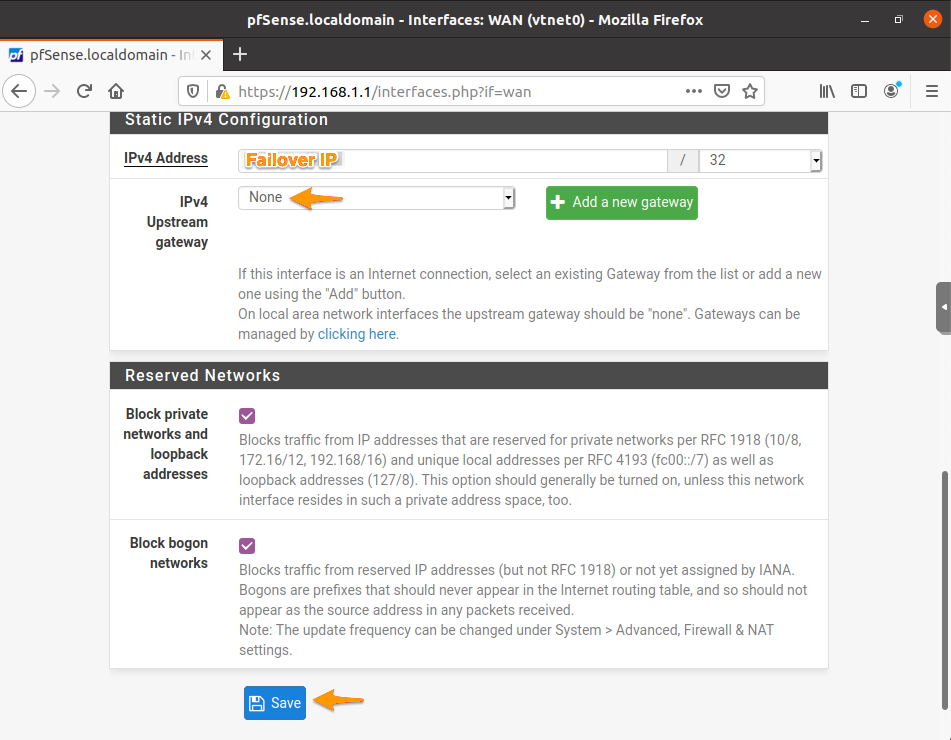

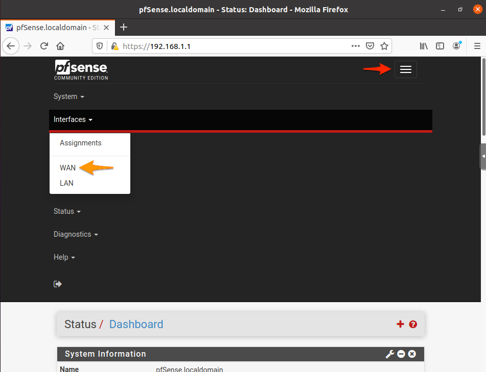

At the stage, the pfSense VM doesn't have a public IP. Click on the menu icon on the top right corner, under Interfaces select WAN.
pfSense setup 4

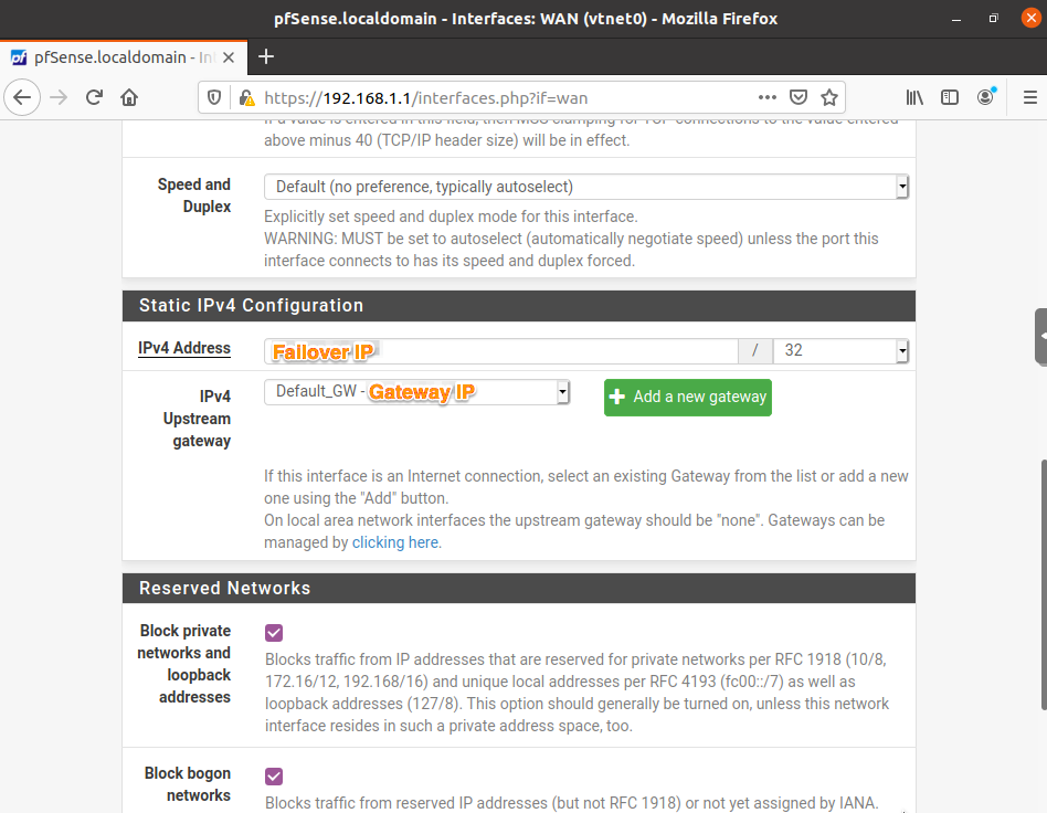

Make sure the settings are matching from what is shown in the below screenshots and enter your Additional IP. The IPv4 Upstream gateway will be configured later.
pfSense setup 5
pfSense setup 6

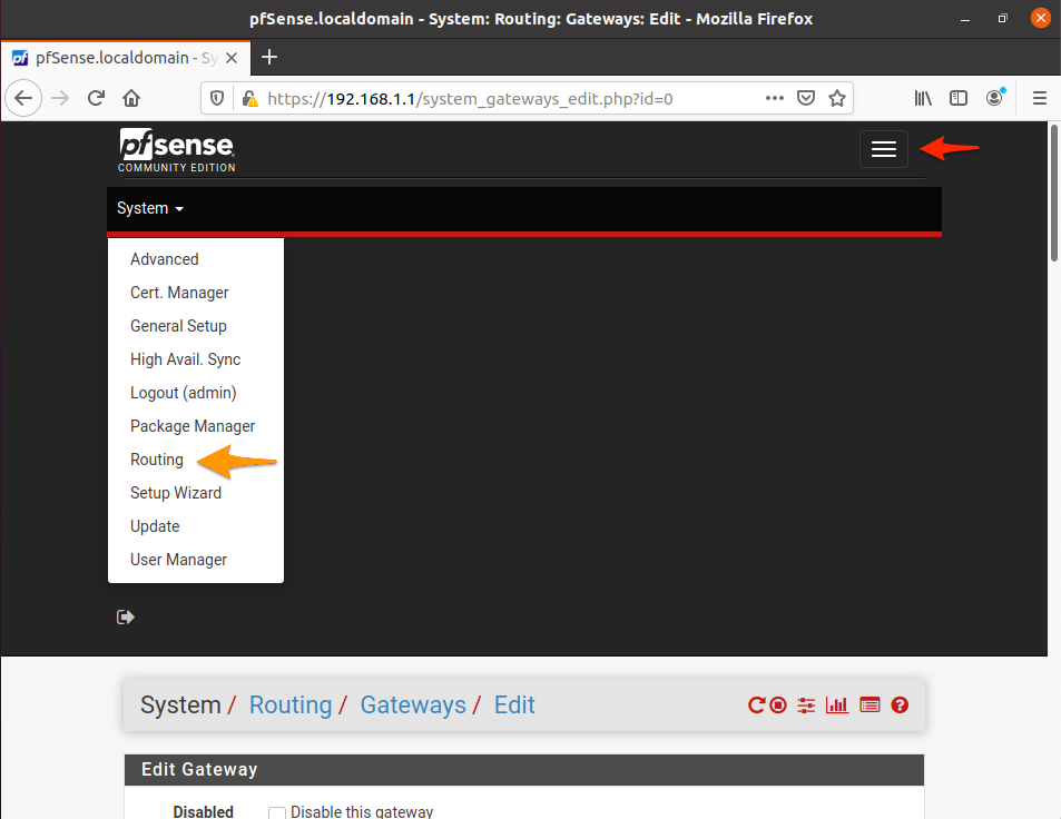

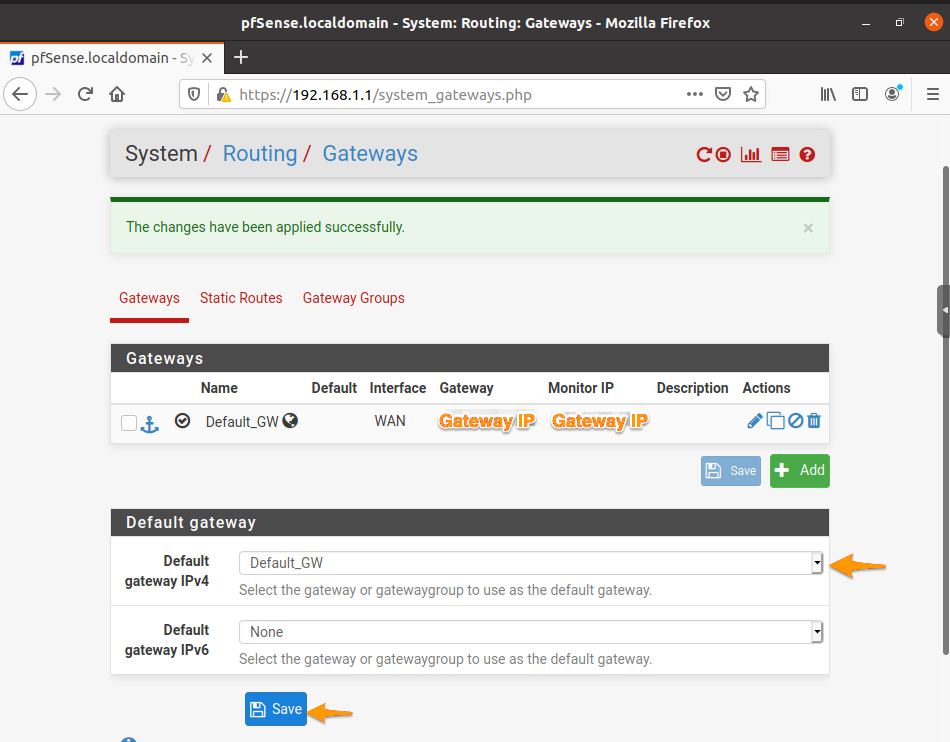

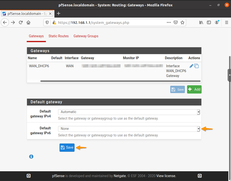

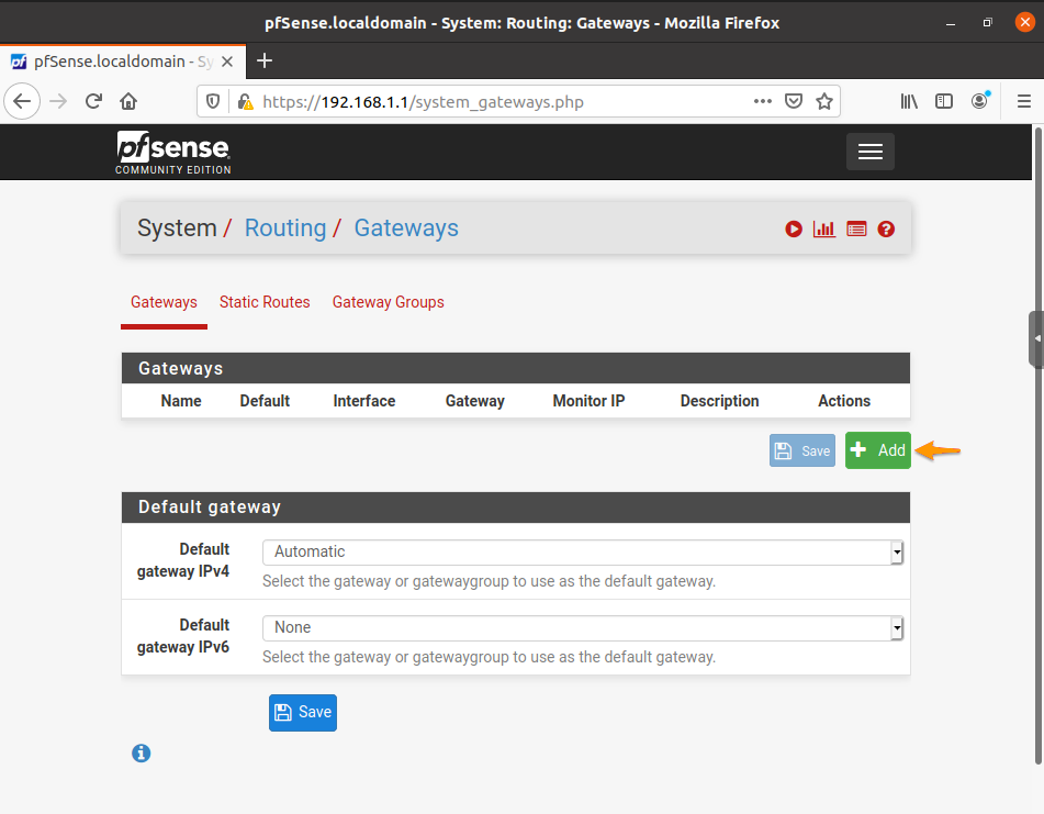

Now that we have a public IP on the interface, we'll need to make sure it'll route correctly on our network. Click on the menu icon on the top right corner, under System select Routing.
pfSense setup 7
Make sure the settings are matching from what is shown in the below screenshot, then select the Add icon to create our gateway.
pfSense setup 8
pfSense setup 9

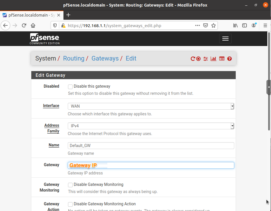

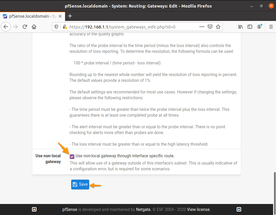

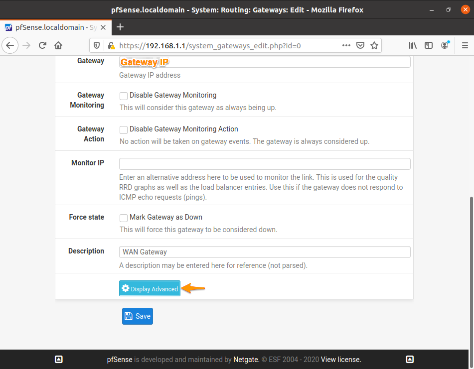

Make sure the settings are matching from what is shown in the below screenshots and enter your Gateway IP. Make sure to open the advanced settings.
pfSense setup 10
pfSense setup 11
pfSense setup 12
pfSense setup 14
Now that we have an Upstream gateway, we'll need to assign the gateway to the WAN interface. Again we click on the menu icon on the top right corner, under Interfaces select WAN.
pfSense setup 14
pfSense setup 15

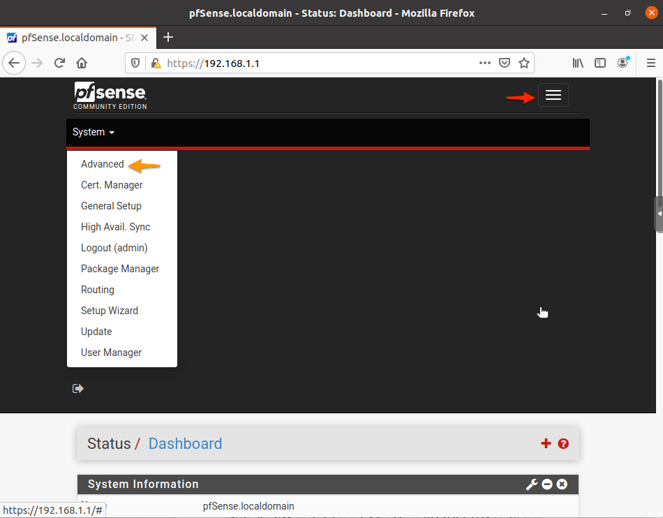

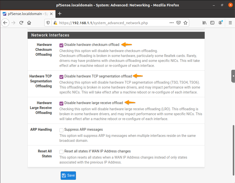

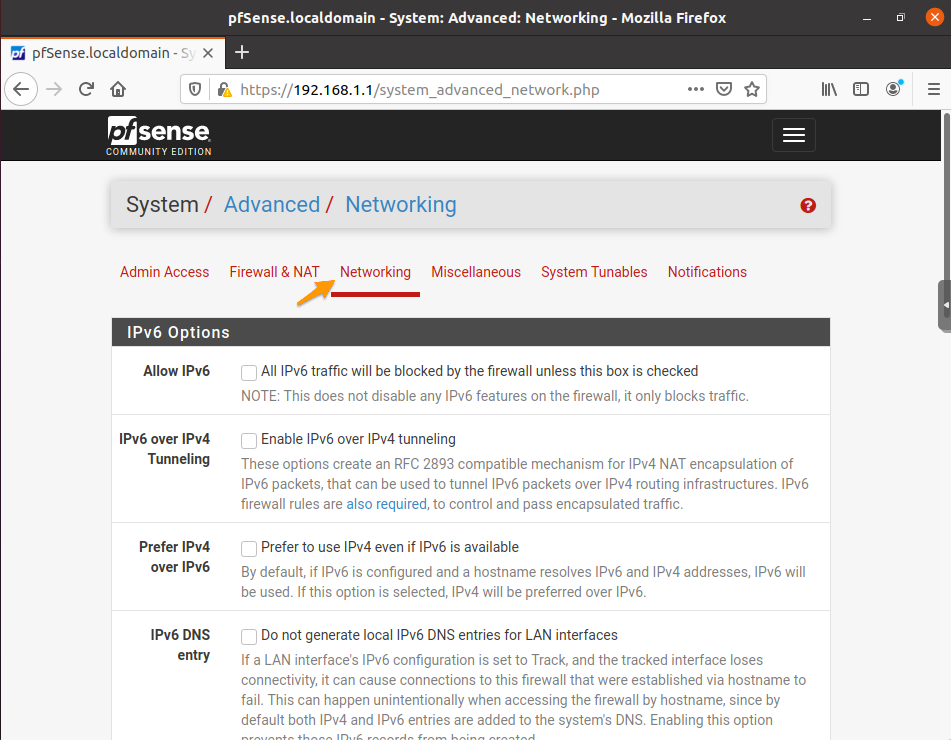

Since we're running pfSense as a virtual machine and it doesn't have it's own dedicated network card, some changes should be done. Click on the menu icon on the top right corner, under System select Advanced.
pfSense optimize 1
In this menu, select the Networking tab. At the bottom of this menu, make sure the settings are matching from what is shown in the below screenshots.
pfSense optimize 2
pfSense optimize 3
