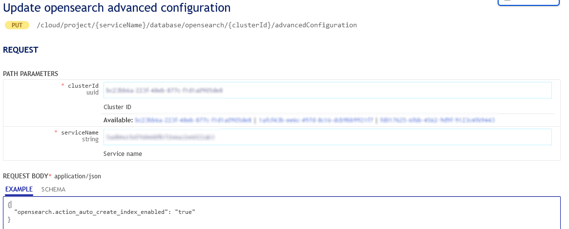

Change advanced configuration
Open the following API call and paste the corresponding inputs (serviceName, clusterId)
Put OpensSearch Advanced Parameters
When ready, click on Execute to update the advanced configuration.
