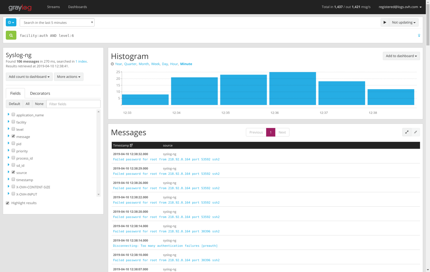

  • Once in Graylog, Go in Stream Tab, click on your stream. In the top-left corner, chose a 1 Day range and click on the green button to search.
  • You should have some results like this:
Graylog search view
  • On the top right corner of the histogram, click on Add to dashboard.
