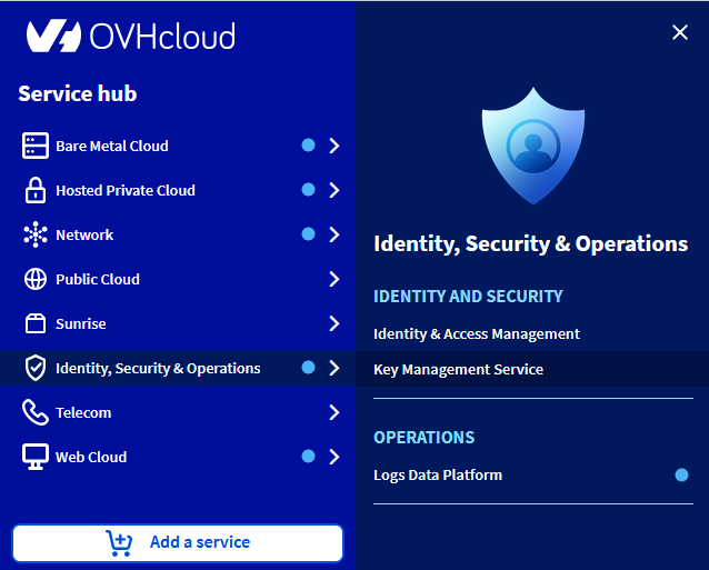

You can order a KMS from the OVHcloud Control Panel by going to Identity, Security & Operations and Key Management Service. Then click the Order a KMS button.
Access to the KMS menu

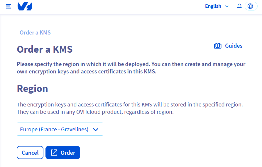

Enter the region of your KMS.
Order the KMS

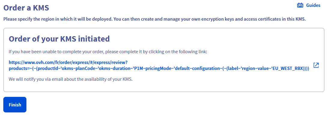

You can then finalize the command in another tab. If it has not opened automatically, the command link is displayed:
Order the KMS

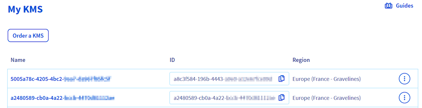

After a few seconds, the KMS will be available in your Control Panel.
Order the KMS

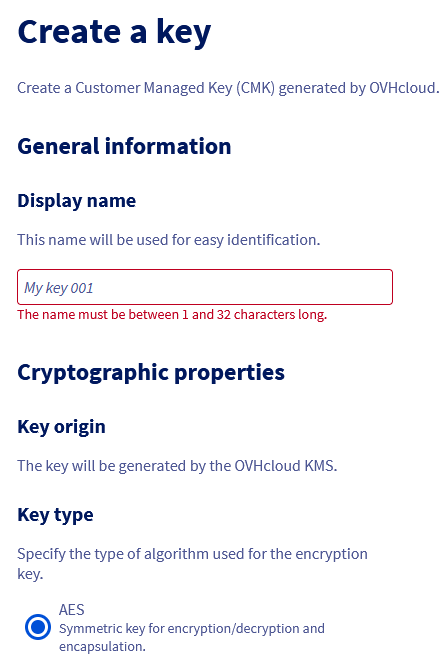

Create an encryption key

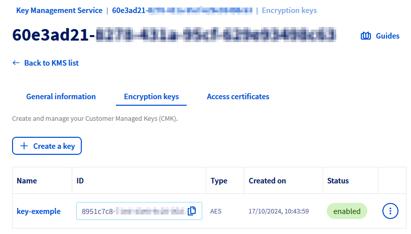

You can create an encryption key from the dedicated menu of the OVHcloud console, using the Create a key button.
Create a key
A form allows you to configure the key and select its type, size and usage.
Create a key

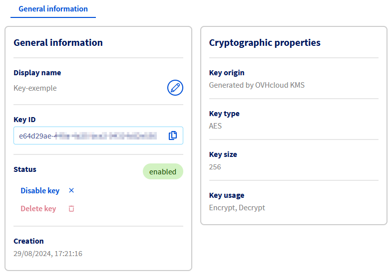

Once the key is created, click it to access its details.
The dashboard displays the cryptographic properties of the key, and the actions for renaming, disabling or deleting it.
To reduce the risks of an unwanted deletion, it is mandatory to disable a key before deleting it.
